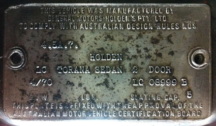

here is a pic of your adr tag and it is missing one of its adr number [20], i know there was a change in 1970 somewhere but if so i was thinking 3 or 6th month.
Posted Image4.5a.7.??? 20 or was this still to early.
i hope im wrong just for you richie.

Hi
ADR 20 relating to safety rims occurred on 1/7/70 .
Bazza

Posted 01 January 2013 - 06:26 AM
well there you go thanks bazza,
what had me thinking was the adr changes where mostly mad in jan and i have seen the 69 under guard bump stops in a 2 month 70 car before.
i think in the future i will leave the number thing to you baz, has i hate telling people there dream car is not quit right, i have held back info before to a few cars that have being posted on this forum, for this same reason, anyways good luck with it richie and it is a nice looking GTR.
cheers gong
