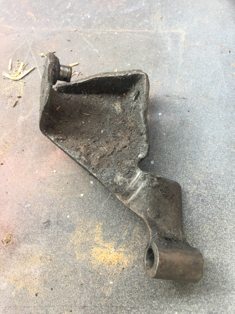

Hey Dave can you please help me identify which is the correct LC bracket?  I have three, and I ended up using the one off my late 73 LJ from the 90's.  Now it was originally a three on the tree and the previous owner put a M20 in it, so who knows if the rat trap I have marked LJ is genuine or off something else as you suggested.  These cars have a long and tangled history.
Bracket currently on car
Attached File  Bell Housing Brackets 07.png   420.8K   10 downloads
I had the choice of three and ended up using the one on the left, which was off my original LJ.  Is potentially the one in the middle correct for the LC?
Attached File  Bell Housing Brackets 01.png   441.8K   7 downloads
Attached File  Bell Housing Brackets 02.png   481.05K   8 downloads
Attached File  Bell Housing Brackets 03.png   452.02K   5 downloads
#8 S pack
Posted 25 November 2020 - 06:13 PM
The bracket in the middle is the correct part for LC/LJ.
The throwout fork return spring hooks into the hole in the crossmember outrigger.
If you were successfully using that brace bracket on your 73 LJ then it should work fine on your LC.
Edited by S pack, 25 November 2020 - 06:18 PM.

The bracket I put on looks nothing like the LC shop manual.
Attached File  LC Shop Manual Rat Trap 01.png   326.09K   4 downloads
Attached File  LC Shop Manual Rat Trap 02.png   450.73K   4 downloads
Could this be the correct LC bracket?  Bit hard to tell from the photos but is probably the closest match compared to the others I have.
Attached File  Bell Housing Brackets 04.png   472.21K   5 downloads
Attached File  Bell Housing Brackets 08.png   619.7K   4 downloads
#10 S pack
Posted 25 November 2020 - 06:19 PM
This is the correct bracket.

Oh great you replied quick thanks heaps Dave, will clean it up and put it on.  Looking at the two it will change the angle of the support arm.  Thanks so much for your help.
One last question, the support arm I'm guessing the holes are not meant to be elongated, which probably has occurred over time through wear and tear.  This picture is my spare one, as you can see nice odd looking hole.  The one that is on the car I welded up, and re-drilled the hole to fit the pin without movement.  Did I do the right thing or is there supposed to be movement there?
Attached File  Elongated Arm.png   409.85K   2 downloads

Thanks Gary your right I cleaned up the brace arm today and looking closely there is a slight twist to it (second photo), and thanks for the info.
I cleaned up the LC/LJ bracket and compared to the bracket I had fitted there is a significant difference in the positioning of the support arm pin.  The LC/LJ bracket pin is about 3.8mm closer to the front of the car compared to what is a HK bracket.  See difference below, I'm sure this will have a major affect on the operation of the rat trap and clutch take-up so we can put that one to bed.
Attached File  Two brackets.png   494.66K   3 downloads
Now that I have my current push rod off, I have one in my spares box that's significantly longer (approx 465mm).  I had the shorter one fitted (approx 420mm).  It seemed to fit without but not sure if it's the correct LC/LJ rod or if the longer rod is for LC/LJ.
I had the shorter rod fitted, it seemed to fit well but again who knows if it's original?
Attached File  Rods 01.png   193.51K   5 downloads
