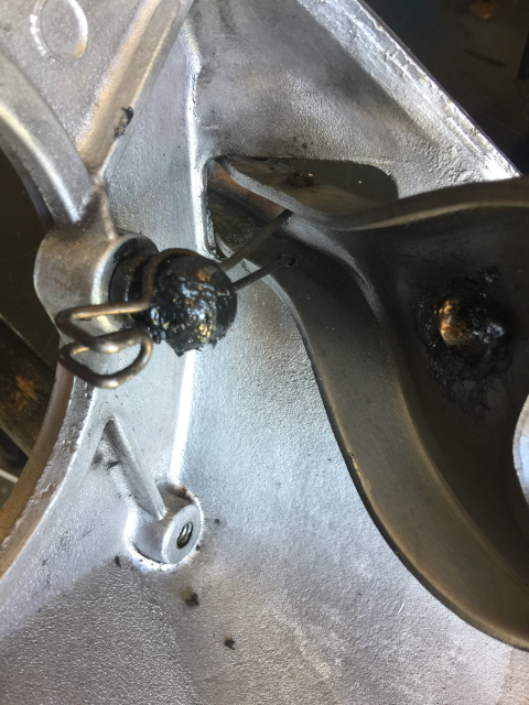

I stuffed up :sad:.  Looks like the core of my clutch issue was "user error".
Ok got the box out, and the issue was obvious once I pulled the bell housing and the external retainer spring off the clutch fork.  The fork literally flung out and I realised I had put the socket retainer spring back on incorrectly after I cleaned the fork.
Attached File  Fork it 02.png   549.07K   1 downloads
I didn't hook the end over the throw out carrier valley before assembling.  I'm surprised I didn't pick it up during assembly, must have been off with the fairies!
Attached File  Fork it 01.png   495.6K   1 downloads
When I put it side by side with my spare grotty, welded up cracked fork the spring location issue was clear.  Also the fork I have been using has no cracks and is not bent which is good.
Attached File  Fork it 03.png   507.7K   1 downloads
I started thinking maybe it fell out when I was muscling the box out from the car, but I went back and looked at my assembly photos, and there is the fork on the bench with the spring retainer incorrectly fitted.
Oh well, won't be making that mistake again.  This way it was not securely held on the socket ball, and guessing I was losing about 10-15mm of movement.  I think there is a very very good chance this is the reason for my clutch issues.  Pressure plate is the right way around, and I have repaired my clutch pedal, and all the slack has been taken out of my poor "verbally abused" rat trap, so this must be it.
Will put it all together and see how it goes, but I'm guessing (hoping) it's problem solved.
Also found a few leaks from the M20 so will take the chance to replace the rear seal, and the shifter o rings where it's weeping oil.

#66 S pack
Posted 04 December 2020 - 09:41 PM
You can see in this image the fork has been running on the ball stud so this is not your lack of complete disengagement issue.
The spring is there to keep the fork in contact with the ball to prevent rattles. Having the anti-rattle spring installed incorrectly will not prevent the fork from working correctly.

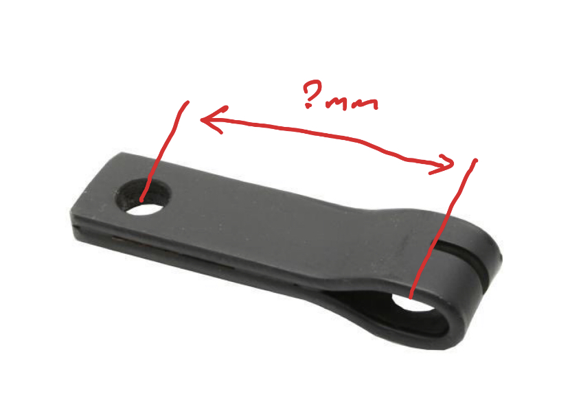

Hey mate yeah both the pin and clutch control arm were worn and welded up as per a previous entry.
Does anyone by any chance have a GM (un-worn) or Rares anchor clutch control for the clutch pedal they can measure the center to center holes for me?  I welded up the big oval hole and took a guess where the original hole was, but if this was a few mm out or more it would affect the take-up position.
If Rares had stock I would just buy one but they are out of stock in Vic, so weld and drill is the only option.  I just want to re-check I didn't drill the hole too high making the pedal take up longer.
If anyone has an un-worn anchor clutch control and can measure the center to center holes it would be greatly appreciated.
Attached File  Anchor Clutch Control.jpg   106.27K   2 downloads
#72 S pack
Posted 07 December 2020 - 09:12 PM
52mm
#73 Bazza
Bazza

Posted 08 December 2020 - 08:02 AM
Hi
NOS one I have is bang on 2 inches (50.8 mm).
Bazza

Posted 08 December 2020 - 06:50 PM
Ok took the pedal off again, and the pedal clutch rod control measured 55mm center to center.  The clutch rod control on my rat trap measured exactly 2", I must have arsed that one when I repaired it some time ago.
Thanks guy's, will re-weld and drill at 2".
It explains one part why there was some movement in my control rod at rest.  The other part is my control cable is stretched by 4mm.
2mm here, 4mm there it all adds up to less take up at the fork.
