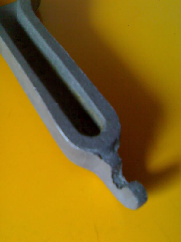

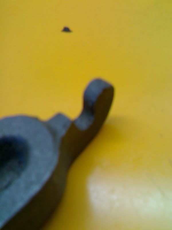

I like the new cast throw out fork but the hook for the cable looks a little... may I say... rough?

Yeah totally agree, it's rough, but as long as it works I'll be happy!

I would smooth it up a lil, may help prevent the cable end wearing but I do want one.

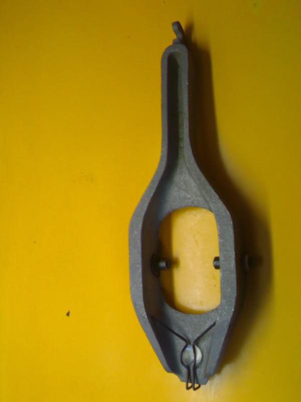

I just took delivery of this type clutch fork from Dellows made from cast air craft alloy and altho I will still take the dremel to it I must say that it looks twice as good and under half the price.

The new Dellow fork looks pretty nice TerrA! Cheers for the pics.
