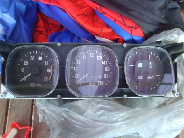

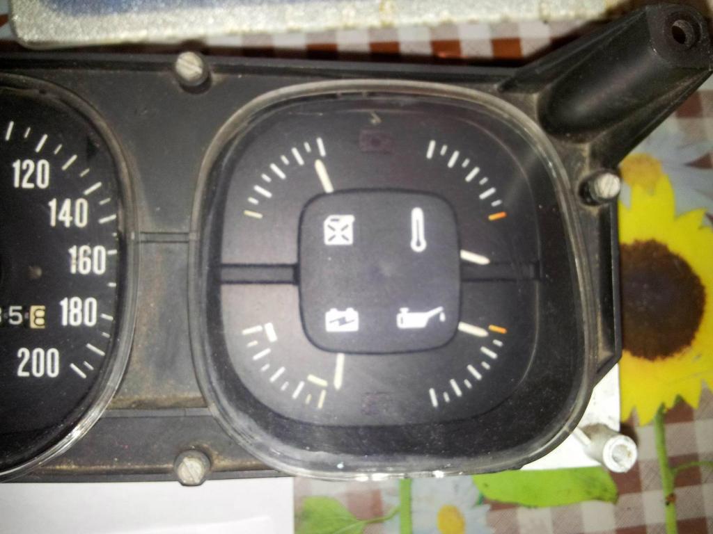

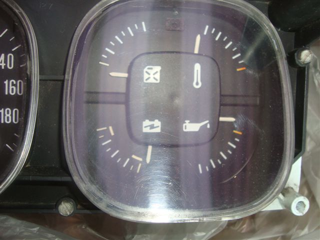

I took out my LH fuel tank to strip paint off and paint. In the process I didn't realise the float fell off the sender unit.
Once the tank was re-installed the fuel gauge was playing up and showed well over full when full. To cut to the chase I lived with it and you know what happened I blew the volatge regulator. This in turn blew up both the fuel and temperature gauge on my SLR dash (oil gauge never worked on it).
This is how it looks when you blow the regulator:
So I decided to rebuild the dash. Sent it away to the instrument expert (PM me if you want his details) and got the 3 gauges working again together with re-setting the odometer to zero (it had also stopped working a year or so ago). End result is tops.
Fitted it in today and everything works again (apart from the fuel gauge need to get the sender unit out and fixed.
I won't say how much it cost me but well worth it!
Phillip
