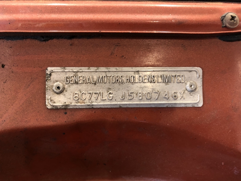

So I wonder with that 2.7 limit whether that means ALL SL/R's were build in OZ? And they just never added an ADR plate, because us Kiwi's don't need to comply to any aussie rules!....LOL
The letter prefixing the PSN tells you where the car was built. The tag below says J580746X, the J stands for the GMH Dandenong VAP in Melbourne, Australia.
Any Holden or Torana assembled in the Trentham VAP in New Zealand will have a Z before the PSN instead of a J.
If this Torana had been built at the Elizabeth VAP in South Australia the prefix would be an L.
So if the Torana in the pic had been assembled in New Zealand the VIN number would read 8C77LG Z (followed by the 6 digit Trentham PSN) X.
