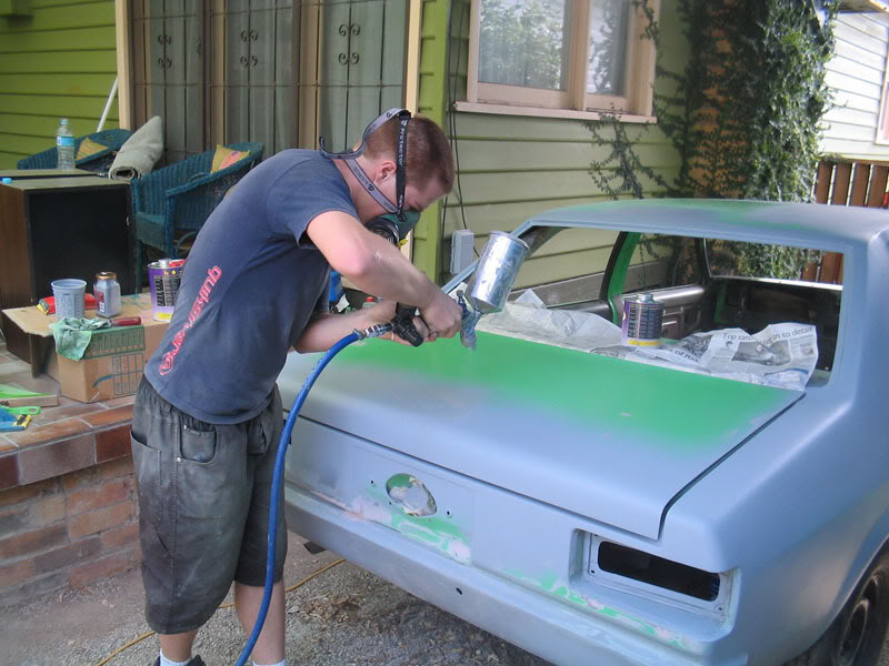

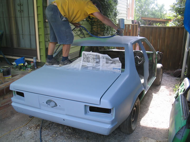

A bit delayed but as promised...
My mate came around and leant me his compressor and we ended up getting a fair bit done so all in all a good day. Won't be able to get much more done before school starts though, DAMNIT.
Ohh and yes I shaved my hair short, that isn't just some random in the photo lol.

:clap: :clap: :clap:
looks the goods heath! i would try to get some top coat on... especially seeing as your car is in a car port. plus schools over rated anyways! :P

Looking heaps better heath! It feels good getting it in primer doesn't it?
#391 Heath
Posted 28 January 2008 - 10:51 AM
Sure does Matt, you were right there. Now I am really seeing exactly how some of my repairs aren't spot on. I am aiming to fix most of them today (just got up, lazy me :P)
haha that is very true Brett, and thanks a bunch for getting those springs! Just let me know when you're gonna be in the area and I'll have some cash waiting, you're a champ mate
Believe it or not Herne, at the time when I was posting those threads, it was my most productive session of working on the car I've had (I just came in and posted in my regular breaks because I was getting dehydrated so often :P). lol cheers
Yeah Toryman it shouldn't be too long before I get some top coat on. Probably a week or two from now? Hopefully it will last that long in primer. If you look closely in those pics, there are unfinished repairs that I can see better now that I need to fix up before I apply any green.
Thanks guys!

Some advice (not that im any expert) move your regulator back to the compressor , it wil be much easier on your wrist and a little lighter,
And you could spay water around and under your car to settle the dust before painting ,
and its great to see you using PPE (cause i neva do)
Baz

Yeah I don't run anything like that on my gun, but it does have a built in regulator (not something that I use).
Didn't wet it down because I wasn't spraying anything very close to the ground. Will do it all for top coat

Keep a water trap on the gun. Will help a lot...
