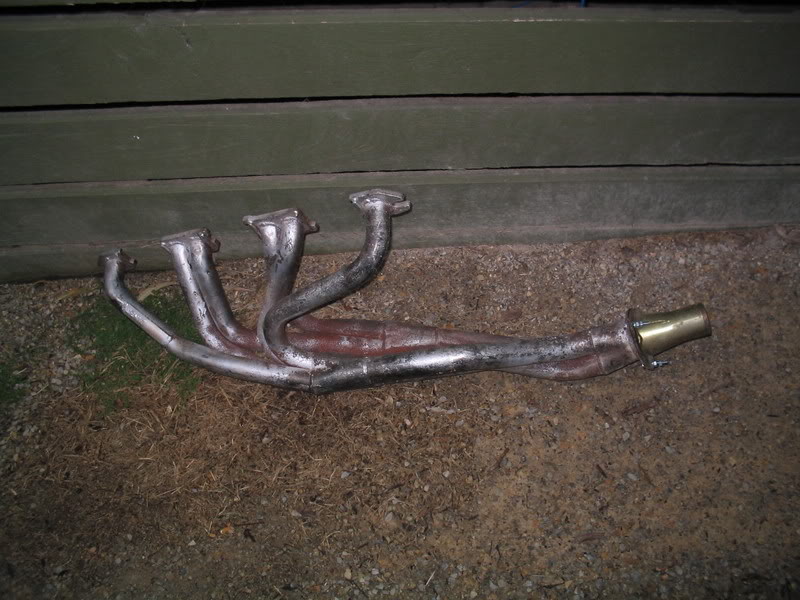

Anyway, my manifold gasket was leaking pretty badly so I got my hands dirty.
$25 extractors:

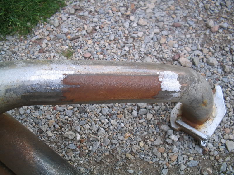

Before sanding it all back and painting em, I removed the manufacturer's badge for a slightly cleaner look (funny how I'm anal with some things and so careless with others lol):

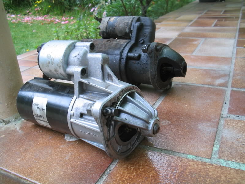

Pulled out the old starter, replaced with a smaller version (sounds a bit healthier too so win-win) so I can swap without pulling it all apart:

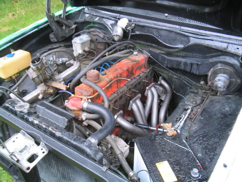

Slid em in

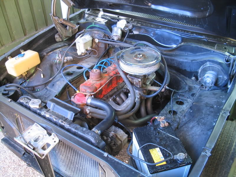

Bolted em up
Runs a heap better now but it's just out of a 3" flange atm so i would like to get a bit more exhaust on there soonish haha slightly too loud for the residential area I live in :P

gross engine bay are you going to tidy it up and paint that engine
whatd you use to sand the extractors back?
and whatd you use to paint them?
I'm going to do the same, mine are pacemakers but they are covered in surface rust.

how did the bolt sitting on the oil cap survive that whole operation?
dont worry about the engine bay heath just concentrate on getting it back together and registered! you must be itching now

Yeah leaving the "gross engine bay" so it looks like I'm not too performance conscious at this stage (for less trouble with rwc & canaries), will make it very very nice later on (wiring job, fully smoothed out and shit).
Mick, I've got an alloy chrome rocker cover & side plates but I actually want a black KC one in the end. Don't know whether I will fit them or not yet...
lol oil cap has a weird threaded system through it with a nut on the top, maybe a home-made job (haven't pulled it apart), once again trying to make it look like it's mechanically untouched by me. Good question though
I just rust converted the bad rust, ground down a few ugly areas (bad welds etc), rubbed it back starting with 40 and ending like like 240 (I dunno I was pretty rough with it, doesn't really matter much as long as you get the surface kinda fresh), prepped them with thinners and laid a few coats of VHT Flameproof on em. Too easy
That oil cap is not correct for RWC
Depends on what the car/engine had originally & what the current cap is - i'm sure Heath could find a cap off a holden 6 in a wreckers to get thru rwc if they hassel him about the cap!

I think rodomo is saying that it isn't allowed to have a breather, post ADR-27A
