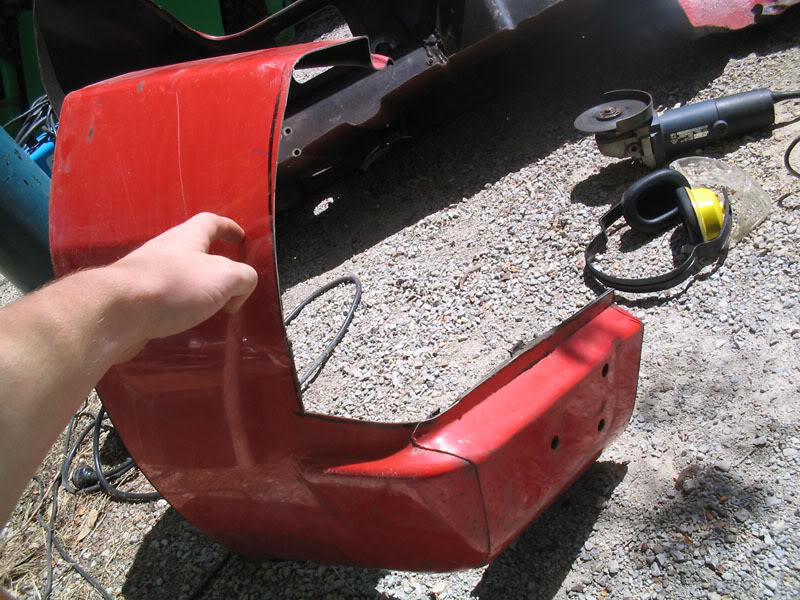

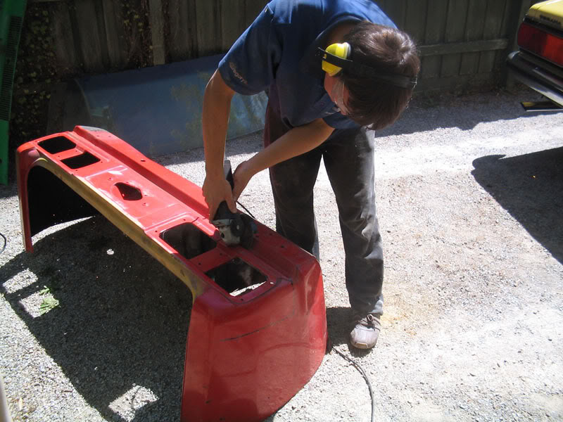

'Twas an early start... No actually that's a lame way to start a story. This morning a fellow Victorian Torana Club member; Peter UC came around and we got to work.
I think you have some idea of what we may have been working on? Just possibly
THE PROBLEM:
THE SOLUTION:

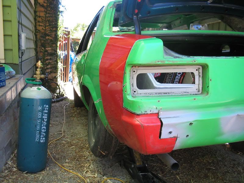

ROFL not really, in fact it was just to straiten that area of the guard up really; there's still the rust that has to be repaired, lol!!!

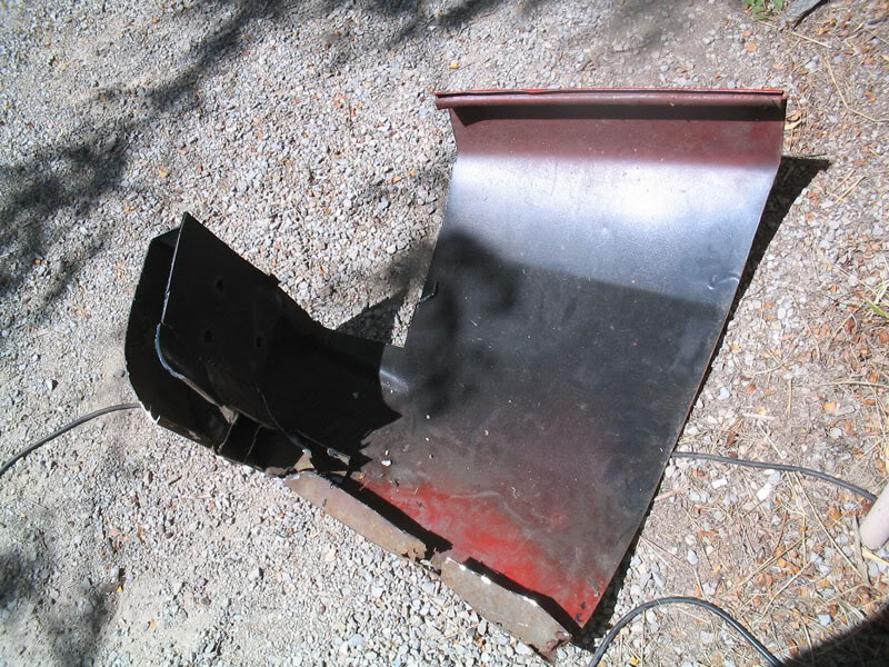

Peter and I got to work and after a bit of cutting complicated joins of skins and rails, we had freed a section which would be useful:
I got out the grinder (again) and made some room!
Not perfect, but not too bad, clamps are your friend :spoton:

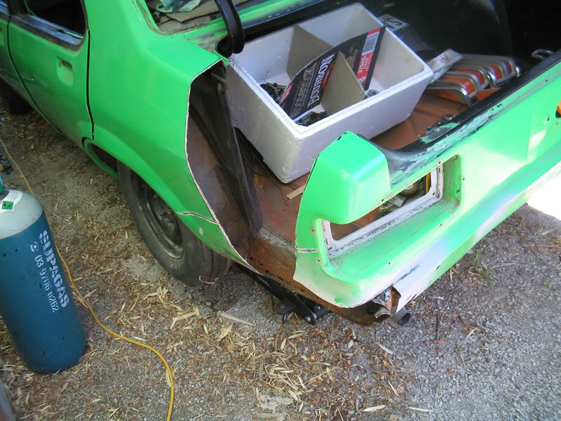

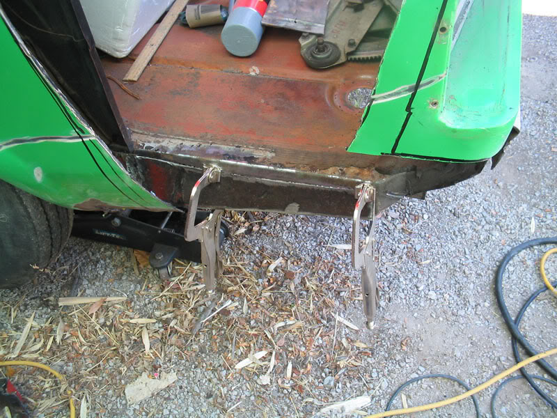

Anyway, before that went on, we had to repair at least the inner part of the rust problem (or we wouldn't have any access to it!)
With a bit of clamping:
With a bit of Peter's welding:
With a bit of my grinding:
And amongst some of this we also managed to fill all the holes for the brackets from the "SL" Chromed light surrounds (yes I like them too but they don't go with the paintjob I wanna do!) properly; by welding them. So that's some more progress, although we didn't get nearly as much as we expected done.

i may have missed something, but why did you cut right up into the boot jamb instead of just continuing the straight cut from under the tail light thru to the wheel arch opening.
#97 Heath
Posted 25 January 2007 - 11:34 PM
The panel was, as the Australians say, FAAAAARRRRRKKKKEEEEDDDD
lol the car's rear left is absolutely destroyed and ripped apart in every possible way. It's full of bog, wavey enough to surf on and it's not even aligned anywhere near acceptably.
