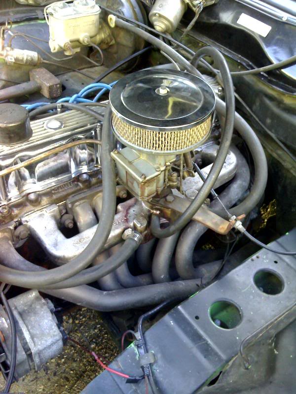

Heart of the old girl needed some love :P
Just put a new water pump on so far. Changing a few gaskets here and there; an oil leak and an exhaust leak, cleaning shit up, fitting the other inlet manifold & carb obviously.

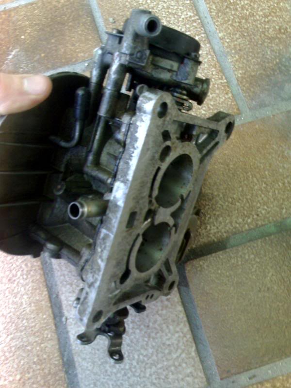

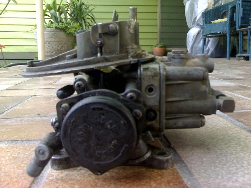

Old #@$^%& $30 350 Holley from wot179 arrived today :)
Reason it's cactus (look at the bend lol):
Bit I bought it for:
I'll give away anything I don't need on this carbie btw, so let me know if you're chasing spares!

I have heared of gas only setups using holley baseplates and doing away with the rest of the carb. when I worked in the carby shop we used to sell 4 barrel bases to the local lpg fitting joint every now and then. Im guessing thats what your up to heath?
#1339 MRLXSS
Posted 28 August 2009 - 08:32 AM
Yeh, that would be what he is doing... You can use the baseplate on a Gas set-up for optimal performance from a Impco setup i think.
#1340 _doogs_
_doogs_
Posted 28 August 2009 - 08:40 AM
That makes sense. I was also curious as to why you had the holley Heath,
(seeing you openly criticised them like many others).
#1341 Heath
Posted 28 August 2009 - 12:31 PM
Yeah I'll throw some more info up when it's all put together, but in the meantime: it's an Impco 300A running down through a tallish, throat-like adapter (which Impco also produce) to the twin barrel Holley baseplate which you use as a throttle body. Goes onto a normal 350 Holley manifold which is also cheap and easy to get your hands on. Same throttle linkage/bracket as you would run with the Holley too. So if you purchase a car with a working 350 Holley and don't want to change the carb to anything else, throw away the bad parts of it and put it on gas!
