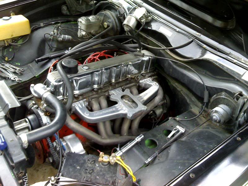

After the cruise yesterday I took the car back to Brad's joint and pulled it apart (convenient him being around the corner from my gas installer). We dropped the fuel tank out and I changed over to the Redline 2bbl manifold, removed pretty much everything that wasn't needed with the LPG system.
This morning I strapped it up for a quick flat-tow from my mate's ute and we dropped the car off. If all goes to plan I'll pick it up (running like a dream) on Friday arvo. Can't wait!

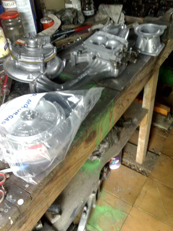

Single valve A90 in the boot with a custom bracket made of 6mm steel flat :huh: lol
Under the bonnet is an aussie B2 feeding an Impco 1&20 300A (rated to above 200HP). There is a 300A=>4bbl Holley adapter, and then a 4bbl=>2bbl adapter, which is like a nice tall spacer plate, but if I was going for all out performance I would have done that a little differently - it will be okay for my current application though. The throttle body is from a 350 Holley and that's ontop of a Redline 2bbl manifold. Photo is a bit shit sorry

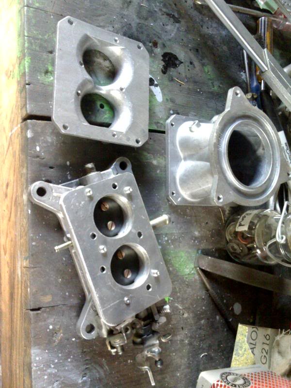

#1460 Heath
Posted 21 October 2009 - 09:14 PM
Why did I even say that? I jinxed myself
Lower adapter bolt pattern is wrong, it's for an IH Holley - why the hell they sell that and not an automotive 2B Holley in Australia is beyond me. So far I've removed some meat from where I don't need it and I should be able to fix it up tomorrow with the help of my mate and a TIG welder

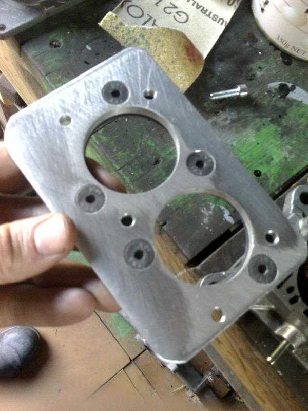

Posted 22 October 2009 - 07:01 PM
What a f*cken day.
Apparantly die-cast doesn't like to be welded so I got talked into making another (third) adapter out of some 6mm alloy plate. Will do the job but isn't what I had really hoped for
Edited by Heath, 22 October 2009 - 07:02 PM.

#1465 Heath
Posted 23 October 2009 - 08:04 AM
Well I ended up maintaining the threaded holes that were there, I just drilled them out and tapped them to M6 so I could use countersunk bolts in the adapter plate (needed to sit flush for the throttlebody surface & gasket to mate nicely)
NC milled out the two big circles for the throttlebodies
And yeah cleaned up the edges quickly and drilled and tapped whatever else needed to be done, and enlarged the holes on the throttlebody to fit M6 bolts through there too
All in my installers hands now :P
