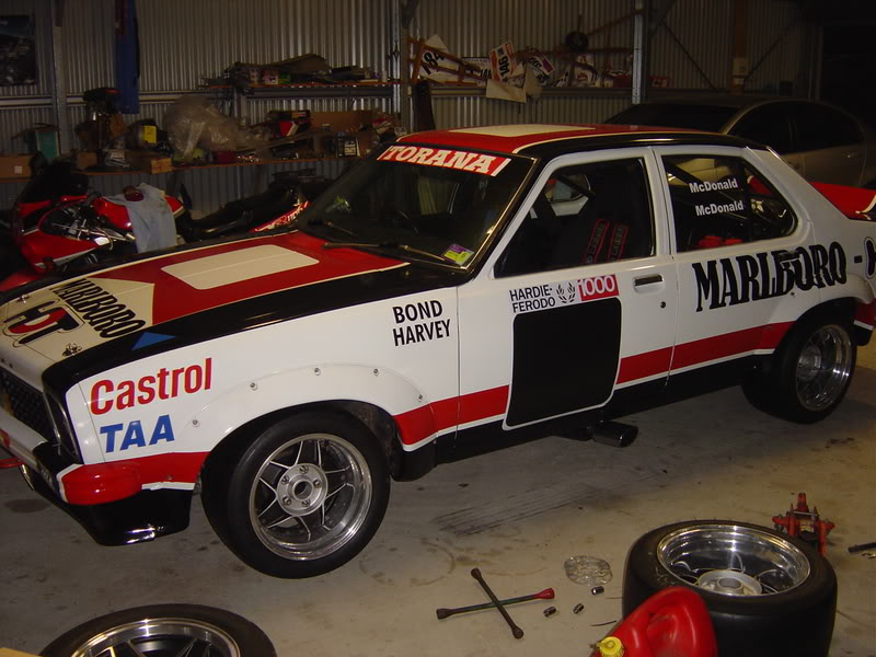

Went around and around our patch today bedding the brakes in...Shit it stops!!..10 times better than the yellow car..
From 2nd to 3rd under power I can't work out if it's wheel spinning or the clutch is slipping. The soft tyres dont make any noise and there is definately no clutch smell so I am guessing it is wheel spinning....might drive back up there and have a look.Temp sits on 205/208, oil pressure 52.
#1503 _rorym_
Posted 15 June 2008 - 02:15 PM
Forgot to mention... the diff whines like a banshee...only in 4th gear on power...pretty sure its the diff...might be toploader 4th gear but definately seems to be coming from the rear.
#1504 _rorym_
Posted 16 June 2008 - 03:16 PM
Got a breakdown /miss at about 5500rpm going into 3rd gear.
NOS and others have had a few problems with the MSD rev limiter plugs and thats basically the only thing I changed by putting in the 6400rpm one.
I will slip the 7000rpm one back in and see if that cures it.

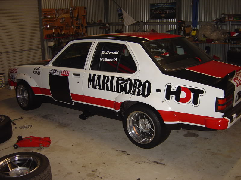

Hmmm...After all that work getting the Simmons to look the part...due to the Nissan calipers I now need 24mm spacers to clear the front rims/nuts of them!!..NOS has 2 spacer built in Simmons rims I might try but I am not keen on running that size spacer on mine so it might be back to the original plan and run 15 x 10 Challengers like all the rest of the Group C guys. Possible set of HQ pattern 15 x 9 and 10 B45 Simmons for sale.

I think I can trim a few fins and get it back to 20mm spacer,got a guy locally that will make up solid ones to slip over the 1/2" studs. I am not stumped yet!!! :spoton:

Sorted..The B45s need a 19mm spacer...I can get them made locally pretty quickly...also noticed I drill the caliper bracket out a fraction on the left making the caliper sit slightly higher making it hit the wheel nuts on the inside. Need to quickly cut out and make another one before the race.

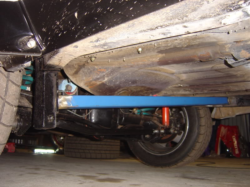

Panhard brace.

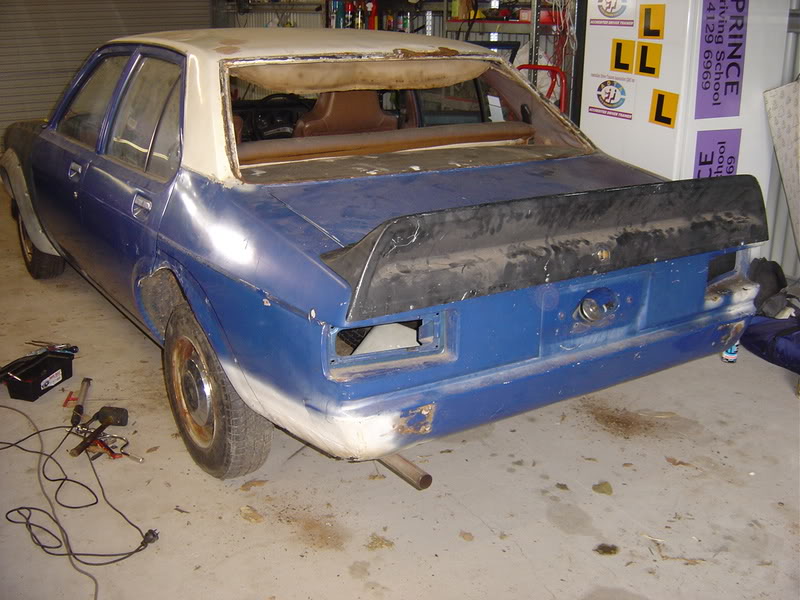

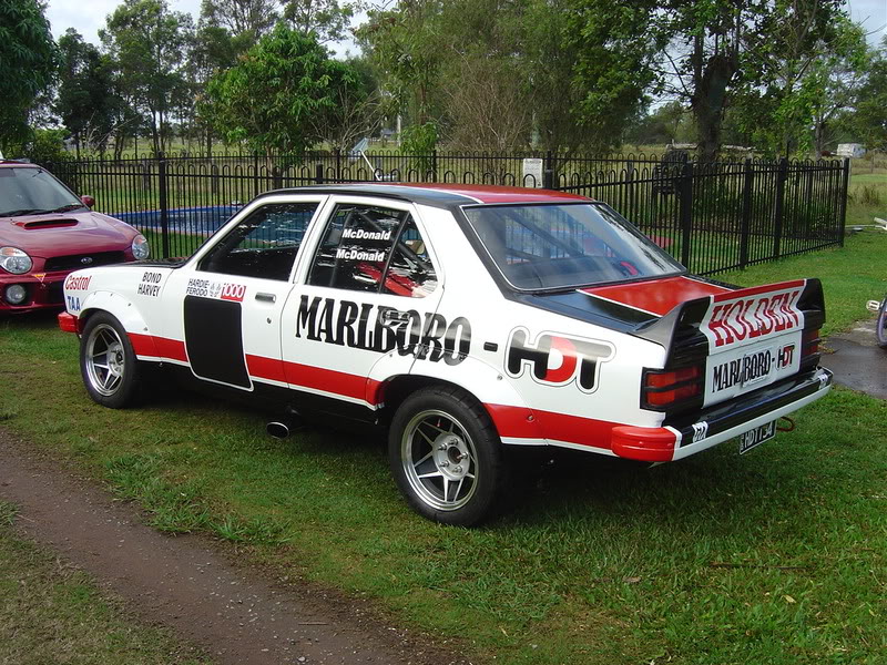

#1520 _rorym_
Posted 19 June 2008 - 11:22 PM

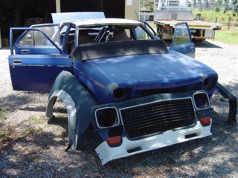

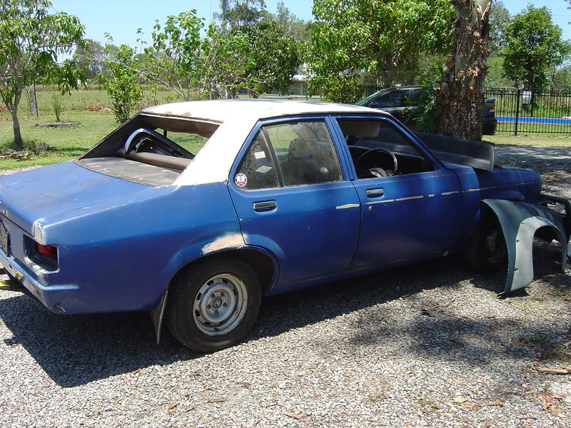

Where we started.
Where we finished.

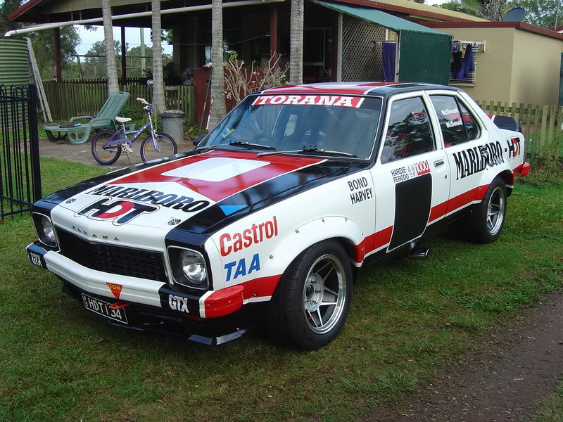

Pretty proud of that....Thanks to Lots..Especially to MRNOS for the paint.
Hope you guys enjoyed the ride. It was stressful, Fun,a pain in the arse, Fun, a nightmare, Fun...But it was mainly Fun.
Edited by rorym, 19 June 2008 - 11:33 PM.
