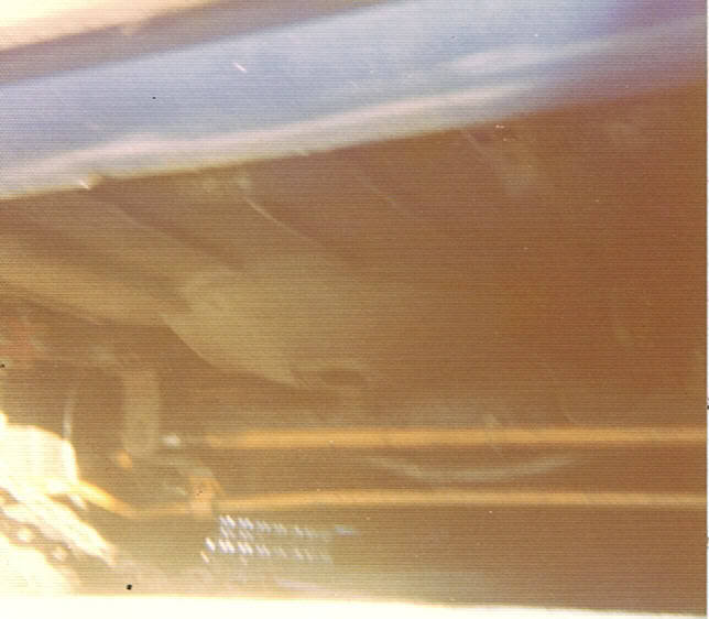

Here is a pic of Charlie OBriens L34 rear end I took at Bathurst in 1975. Notice the illegal panhard rod.

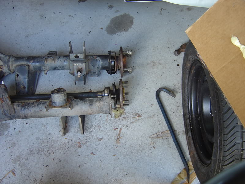

Here is the Nissan diff I used and the panhard rod mounting bracket. I have 2 VR/VS complete diff assemblies floating around here...just nee to cut off and weld the bracket and make a arm for the other end...I will thread it like Sam to make it adjustable as well....while it is being done.

Got a pic of the other end of it?..Unusual shock /spring setup...Trust Ron Nissan to do something different..He was my home town guru on cars.

OK..was just interested in the attachment/fitting it had.
