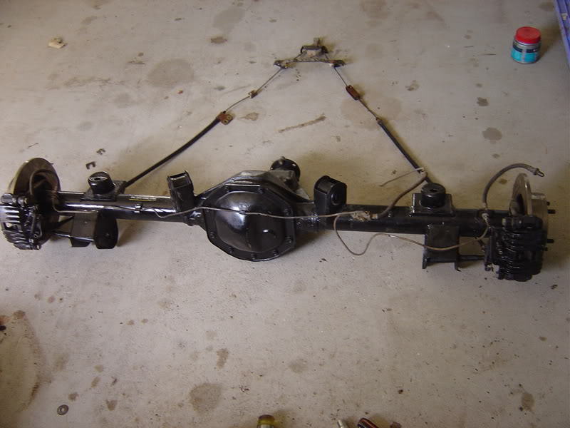

Went back and looked at my diff pic...the mounting brackets are actually pivoting about 1"..1 1/4" closer to the rear of the car...not directly under the housing as a std fitment!!..Clever!!
Would that be because it it an L34 using HQ arms? Same principle as longer pan hard bar.

More info?..I deleted most/all of the brackets.

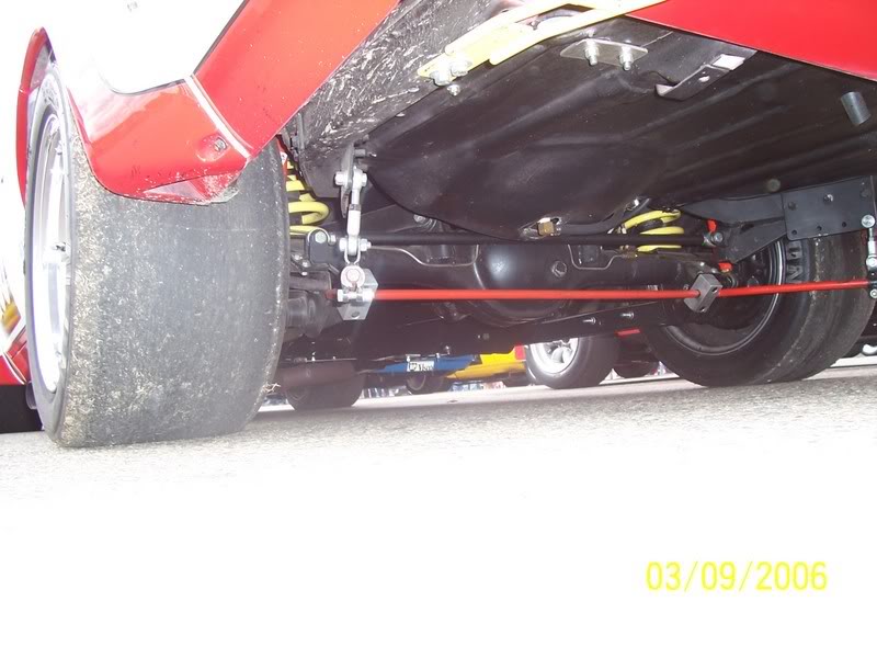

Anna Camerons 1974 HDT car.

Geez, rear roll centre is fairly high....
Bet it understeers on corner exit a bit.

Greg, at what height would be more suitable for the panhard, I'm in the process of putting one together at the moment. I was going to go probably just below the centreline of the diff, and make it a little longer than the one in that last pic.

Does anyone know where I can buy those clamps, links etc on the ends of the rear sway bar in rorys pic of the HDT car ?

Pretty sure it is a KMAC bar and Howard bought the brackets/arms only from them for his front bar so guess Kevin will sell you them on their own.
355LX...this is Moots mates car. I am also interested in Gregs suggestions for my location.

Thats the same location as mine, it does push a little on rough roads when the suspension travels.
#50 _rorym_
Posted 02 January 2008 - 04:02 PM
I was wondering with rock hard race suspension and minimal travel if that would be reduced somewhat.
