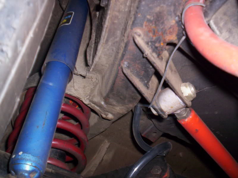

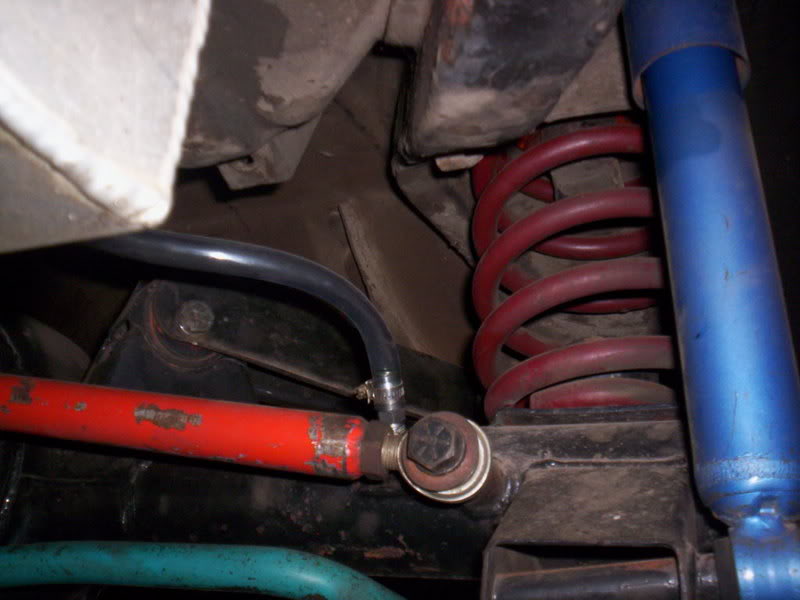

I have a Panhard rod on my jigger.. I will take some pics and post...
#55 _LXChev366_
_LXChev366_
Posted 03 January 2008 - 05:44 PM
Here ya Go... LH side. Note my new (1/2 inch clear plastic hose) diff breather, used to get oil leaking out the seals.
RH Side. Yep I have a breather on both sides. I drilled and tapped a new hole and fitted airline fittings. The original breather was only about 3mm in size on one side only. Now its 12mm on both sides.

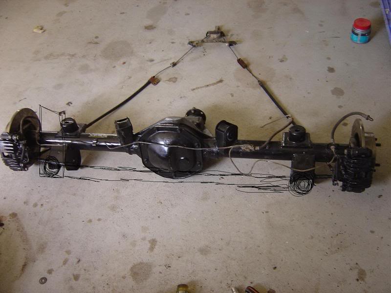

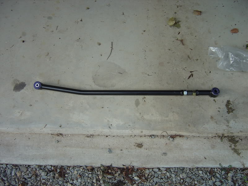

Got my new adjustable rod today..pick up the VN diff tomorrow...will cut off the in bracket and fabricate the arm at the other end to suit.
#58 _rorym_
Posted 05 January 2008 - 03:15 PM
#59 _rorym_
Posted 06 January 2008 - 02:31 PM
Finished my brackets today...will post up pics when I get them welded on.It runs parallel with the bottom line of the diff tubes so hope it is the height Greg was talking about.
Edited by rorym, 06 January 2008 - 02:33 PM.
#60 _rorym_
Posted 06 January 2008 - 02:38 PM
Like this if you get my drift.

where do those breather tubes go? through to the boot?
mine goes between the tank and the floor and i get lots of diff oil spilling out though and need to find somewhere better/higher...
and yeah, i think the lower the bar, the lower the roll centre.
and the first hdt pics lokks like a sway bar, not panhard.
#71 _rorym_
Posted 08 January 2008 - 09:21 PM
Brett...put about 3 loops in the line...that will fix you problem I reckon...agree on the HDT bar as well.
