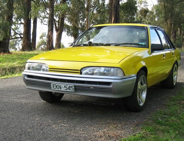

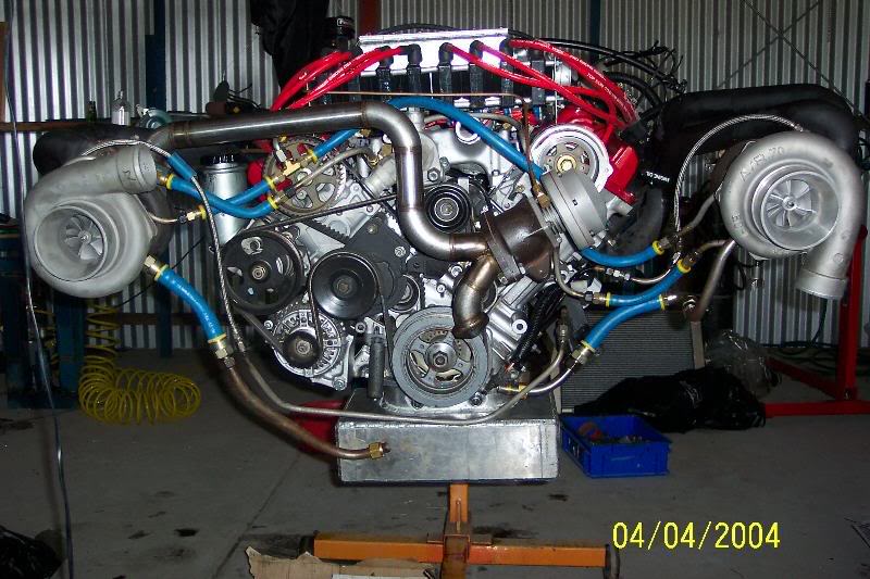

My mate, Chris, owns the motor which he had previously fitted in his VL turbo interceptor. It had two T04 turbos, full manual TH400 It was an awesome car but he pulled it apart and has since sold it as a roller.
The motor made 360rwkW when it was in the VL with standard cams and just 15psi boost. The pistons and heads have been modified to lower the compression ratio to 8.1:1, 1000cc injectors, custom stainless extractors, custom plenum, EMS computer with 8 coils, crow valve springs, custom sump and intercooler.
Here are some pics of the VL setup...

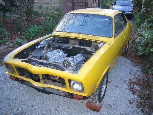

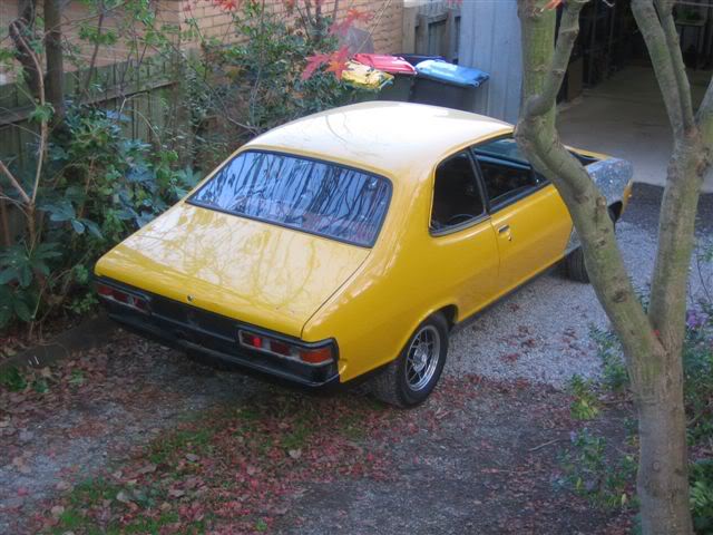

Here's a sneak peak at the LJ. The front guard has been stripped of paint for repairs, but the rest of the car is pretty clean. Fixing up the body will come a bit later on.

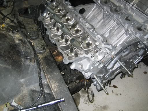

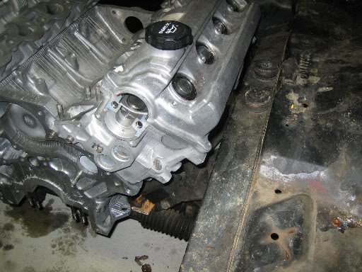

We initially sat the engine block in there to see if we had any chance of fitting it.
It will be a bloody tight fit, but it could be done.

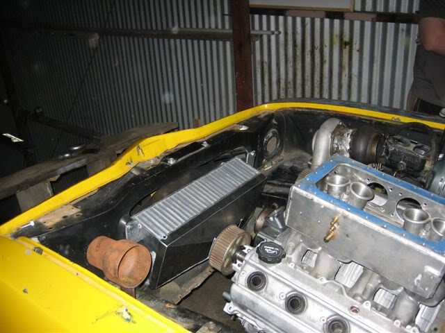

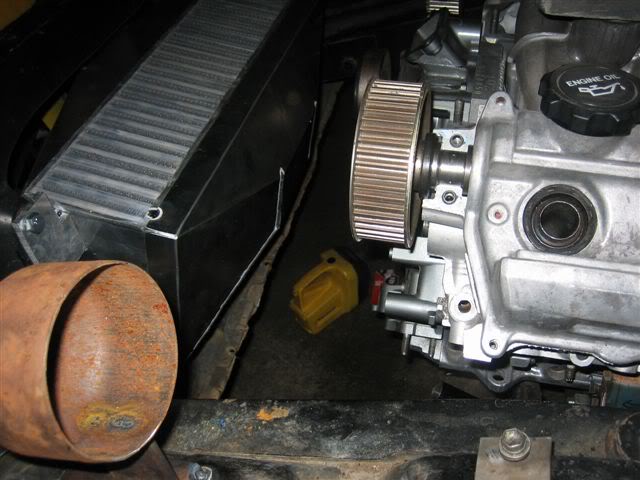

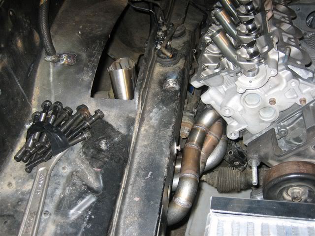

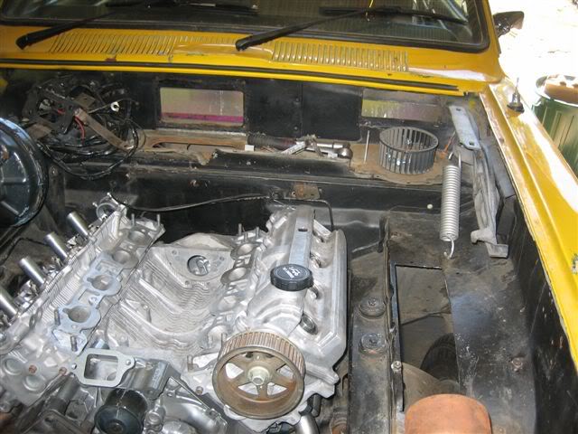

Since Chris had already made an adaptor to suit TH400 for the lexus block, we bolted up my TH350 and sat it in the car. I also have a CRS crossmember lying around the garage waiting to go into my LC, so we fitted it up in the correct position (using the standard bolt holes). We wanted to keep the engine in a fairly standard position.
The block was going to fit without any firewall modifications if we used the most forward crossmember bolt holes. Perfect! Next on the list, is to make engine mounts...

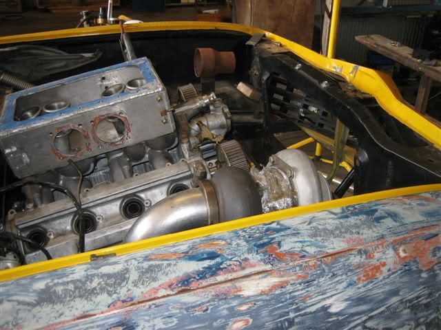

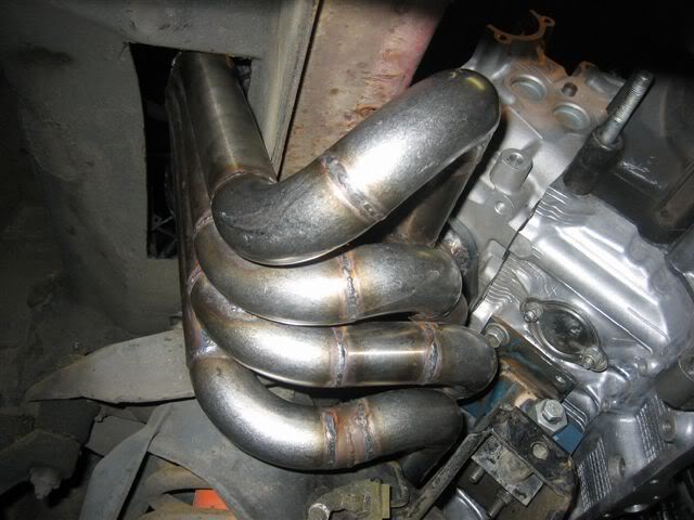

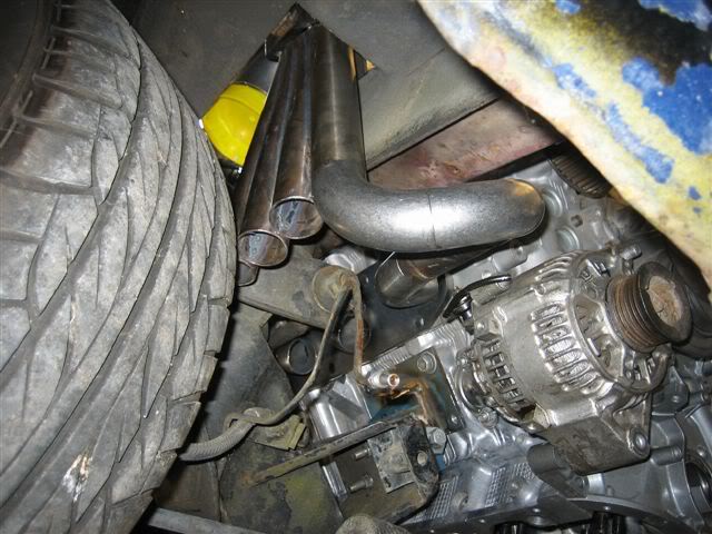

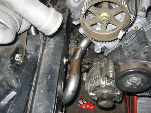

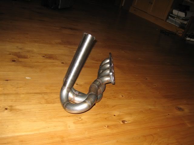

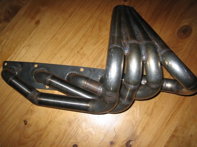

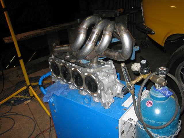

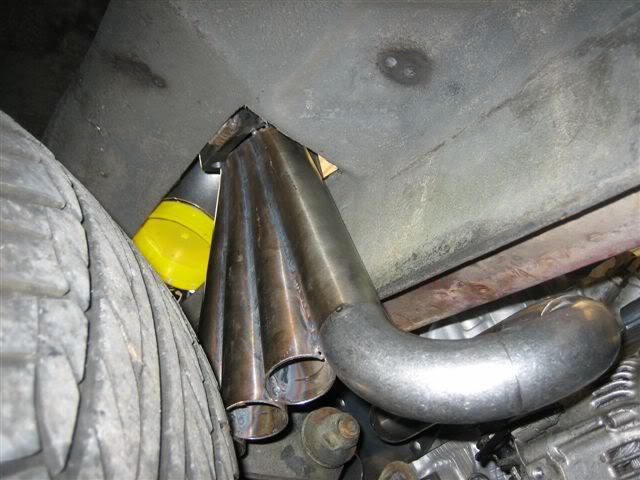

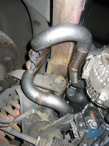

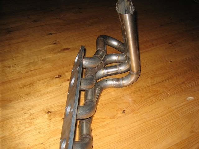

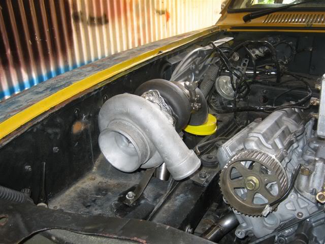

In the meantime however, we started thinking about where the turbos would go and how we wanted the setup to look. There were a number of options, but we settled on having the turbos sitting above the inner guards, just above the wheels. It would look a little like this dodgy schematic:
We would have to cut some holes in the inner guard. This wasn't ideal, as I wanted to be able to return the car to standard if I had to. After all, I may want to sell the car again one day. So we decided that we could cut out clean/easy rectangular sections out of the inner guard which could be welded back into place if required later on.
Its a bit frightening cutting out the chassis number!
Then we started fixing the turbo flange plates into position. We just tack welded brackets to them and to the inner guard. This was a bit tricky, because everything had to be perfect. The angles had to be right. Once the plates were fixed, work on the extractors could commence.

Are you using solid engine mounts, and bracing the turbo to the rail??
or will the manifold support the full weight of turbo and exhaust?
#14 _LHoon_
_LHoon_
Posted 17 November 2006 - 03:02 PM
very nice!!
Thanks for all of the comments!
We've made engine mounts using a round rubber suspension bush. So they're not soild, but still extremely strong. If you look closely in some of the pics above you will see bits of them. I will post a better pic of the engine mounts, but I haven't got a good photo just yet.
The exhaust manifold will support the weight of the turbos. For now, we have brackets tack welded to the body to keep the turbos from moving around. The brackets will be removed when we've completely finished the extractors.

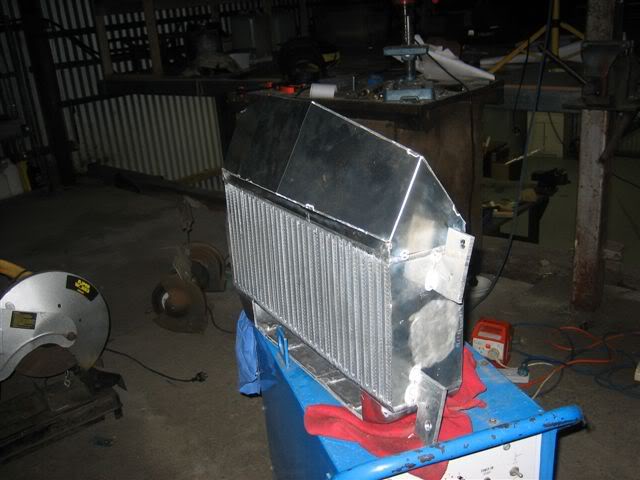

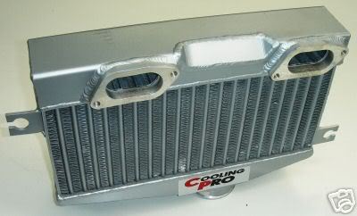

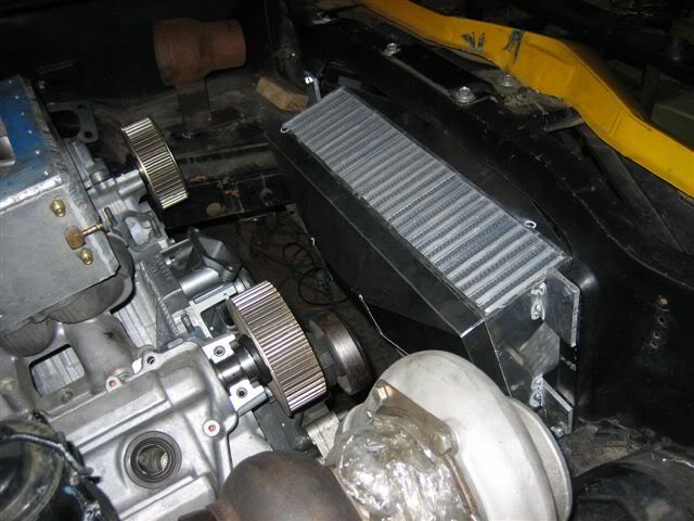

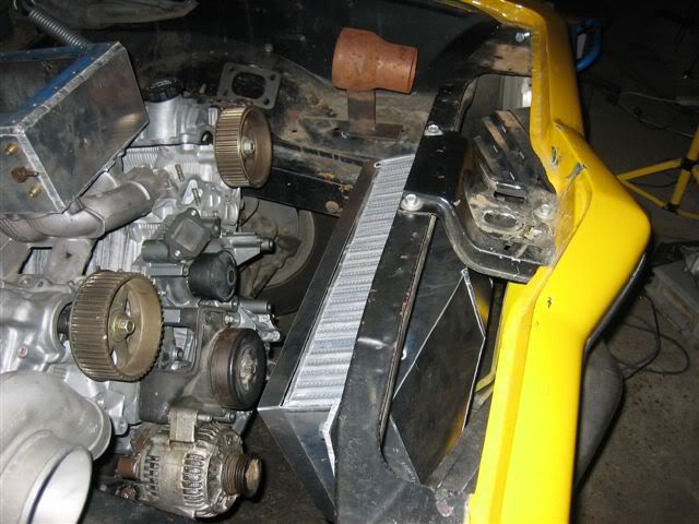

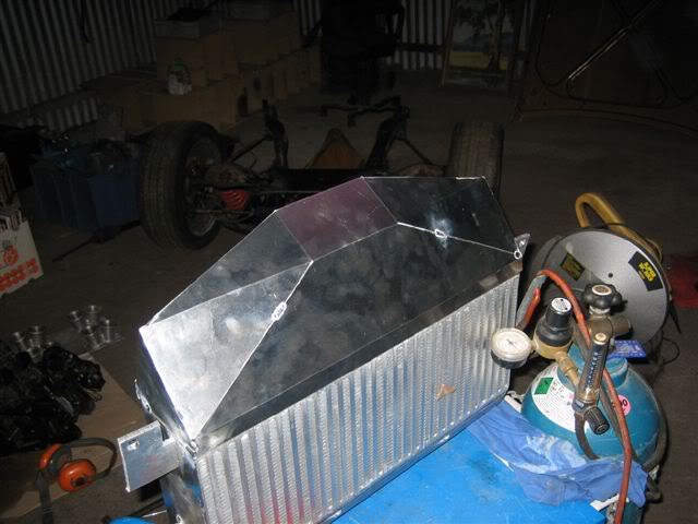

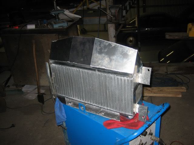

We bought a cheap WRX top mount cooler off ebay a little while back. They're selling heaps of them, and they're only about $270 or something. We only wanted the intercooler core, as it was a nice small size but is 100mm thick. The tanks would be changed.

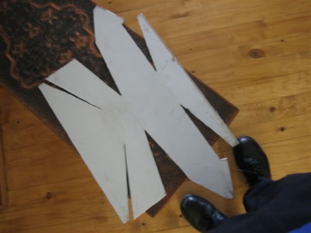

First we sat the intercooler core in the car, and figured out how it would be best. We've decided to save some space in the engine bay and have the radiator in the boot. Only the intercooler would sit up front. Its probably overkill (particularly if we're running it on methanol), but we wanted to make a water-to-air intercooler, rather than the typical air-to-air type. Its only a little bit more work making water tanks either side of the core, and a bit of plumbing. And besides, it will look cool!

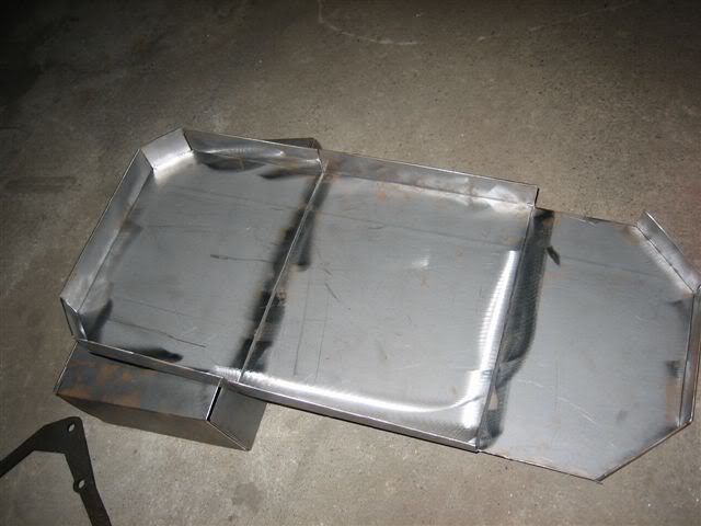

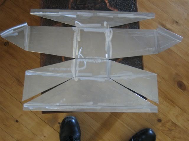

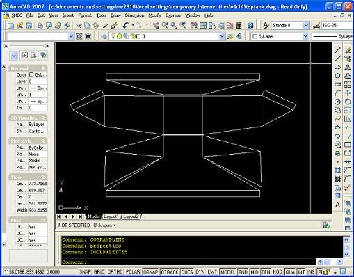

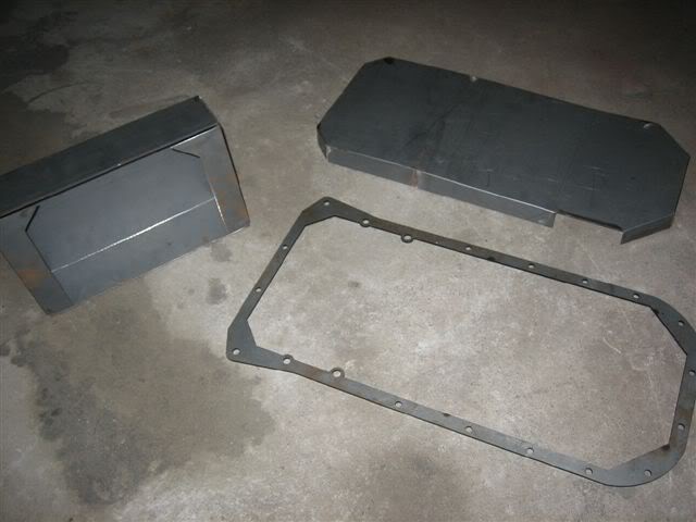

We designed the tanks on computer (AutoCAD program), and then cut the sheetmetal out with a jigsaw. In the past we have gotten stuff laser cut because its neater and easier. But they’ve put their prices up so we just jigsaw it now.
The fold lines are scored with an angle grinding disc so that it can be folded easier (and straight).
It all folds up perfectly like a cardboard box, and then welded together.
The intercooler will be water-to-air so (water) tanks are required for the front and back of the cooler. Again, these were also designed on computer first, then folded and welded.

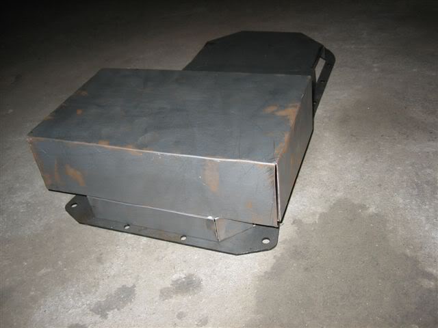

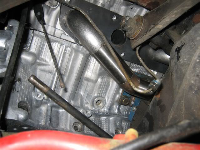

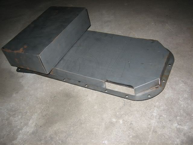

We started making a new sump as well...

With making the sumps, i've found they can leak around the welds. I'm using a mig. Is it poor setup on my behalf or do you use a special wire/gas setup?
I love the fab stuff, just nuts. Keep up the pics.
#23 _LHoon_
_LHoon_
Posted 19 November 2006 - 05:33 PM
Thanks guys!!
We've been using TIG on everything, with great results. Welding can be done slowly, with almost perfect welds everytime! We haven't had any problems with sumps leaking. :rockon:
There wasn't much room for the sump though. It will only hold just about 4.5 to 5 litres. We would have liked to have a bit more up our sleaves. I hope that's enough! Didn't want the sump to hang any lower than the crossmember... just in case its gets bashed when the car comes down from a huge wheelstand at the drags. ;-)
#24 _studricho_
_studricho_
Posted 19 November 2006 - 06:17 PM
Ahh, i thought it looked like a tig. I've been told the mig welds are porous therefore that's why it leaks. Is that true?
#25 _LHoon_
_LHoon_
Posted 20 November 2006 - 08:51 AM
I don't know about that! I think that a MIG would be able to seal fine if it was welded properly. Check your settings. Then make sure the two surfaces to be welded are clean.
