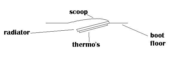

I have got an idea on how you could do it, I will scribble up a pic of what I think would work well

#31 makka

if you set it up like this:
you would get good airflow and keep most of the heat out of the boot

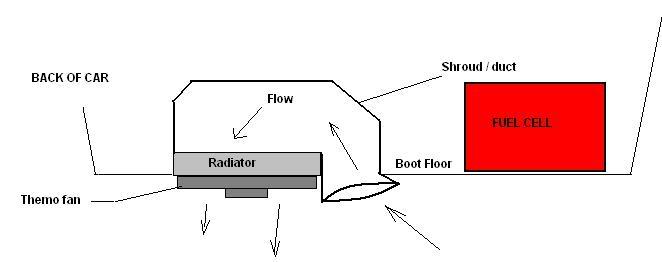

#32 _LHoon_
_LHoon_
Posted 20 November 2006 - 03:43 PM
Thanks for the sketch Makka! My idea is very similar, but still different. I really should draw my own, so that I'm clear.
LX406 - The boot will be full of fresh cool air, which is drawn in directly into the boot through a port hole. This cool air is then drawn through the radiator (by fans)to the outside of the car. There would be a constant flow of cool ambient air into the boot. I don't expect the it to get hot at all in there.

#33 _LHoon_
_LHoon_
Posted 20 November 2006 - 04:25 PM
Here is my sketch. I'm also just thinking that the shroud probably isn't even needed if the fans are sucking. Because the whole boot acts to force the air through the radiator.
The only thing I'm a little concerned about is that the air might be continually recirculated around and around. It would be ok when the car is moving, but when stationary the hot air may just hand around under the rear of the car. It might not be that bad. What do you think?
#34 makka

Posted 20 November 2006 - 05:54 PM
yeah, thats basically the same as my idea, except mine uses an angled radiator, the front of the car is on the LHS of that picture

Posted 20 November 2006 - 09:27 PM
Ahh I understand your diagram better now Makka. That's not too bad an idea at all! But I'm just not sure I want any part of the radiator hanging down. I suppose the standard fuel tank hangs down there a bit anyway. I will think about that some more. An angled radiator might be the way to go!

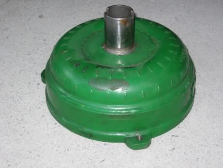

We bought a hi-stall convertor for the powerglide. Although we don't actually have a powerglide yet, but we'll get one eventually. We bought this convertor off ebay. Its a Dominator 5500rpm convertor!! Awesome!!!
The guy I bought it off said the stall speed has been designed for a small block chev, so I expect the flash stall to only be around 4500rpm with a little ol' 4.0L engine... but the boost will help with torque to push up that stall speed a bit. This convertor will be helpful off the line when we get new cams.

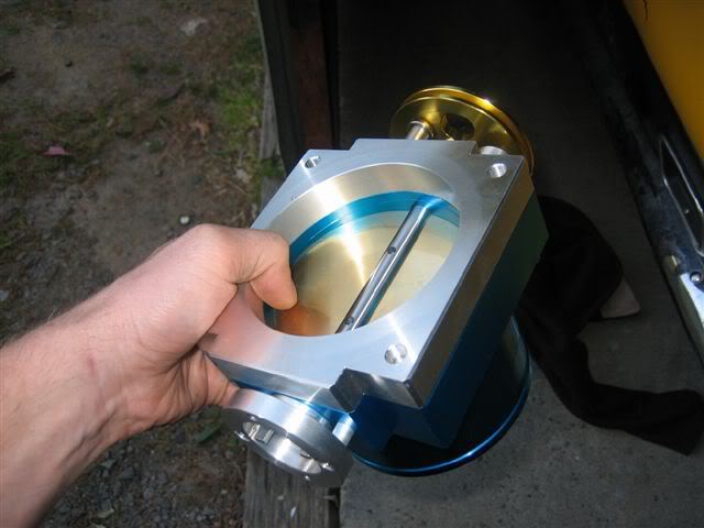

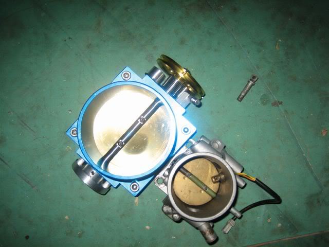

We just bought our new throttle body!!! 100mm.
I doubt that this will restrict power. Check it out, its massive!
And here it is next to an XF throttle body. The XF one is what VL turbo guys usually use as an ‘upgrade’.

It came from Thailand.

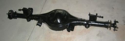

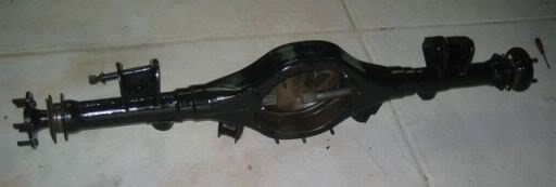

I've now got a 9 inch housing and axles for the LJ. Its torana stud pattern and standard LC/LJ length. I might consider shortening it a couple of inches later on. I will probably also convert it to HQ stud pattern eventually.
I'll be keeping an eye out for cheap diff centres now!

lhoon i recon if your going to shorten the 9" and change stud patternaswell as look for a centre you'd be better off buying another 9" pay for it to be cut down ect then sell the one you have :spoton:
you'll save atleast a couple hundred dollars :rockon:

Muro - Yep I've been thinking the same thing myself. I may or may not use this diff. We'll see. I could also use it for my LC, and get rid of the borg warner.

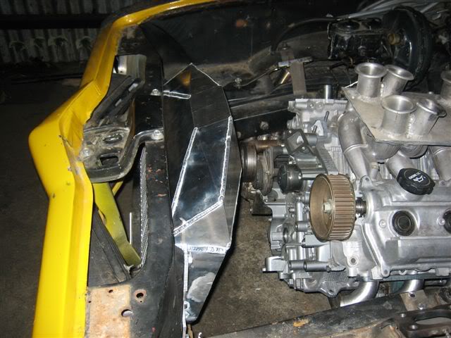

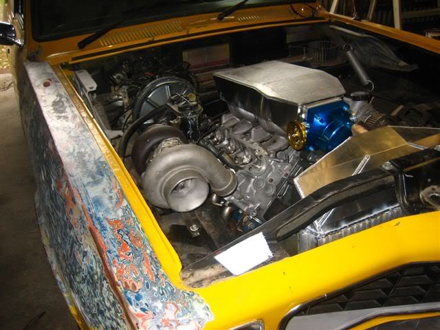

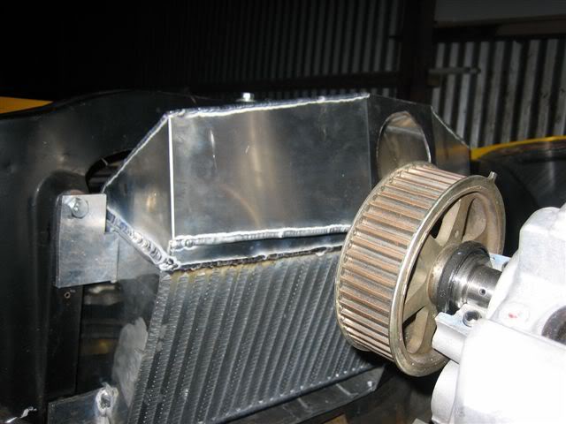

I've got another update for you guys.

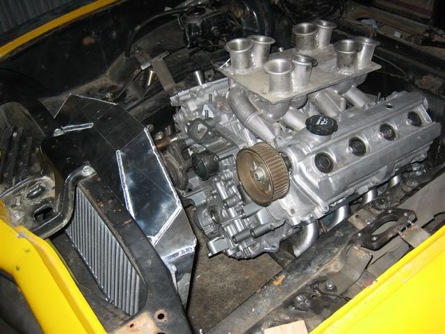

Finished welding on the top tank of the intercooler, and drilled a 4 inch hole for the air outlet to match the huge throttle body we've got.
You'll also notice that we chopped the top off the old intake manifold plenum. We're re-designing it so that it fits under the bonnet of the LJ.

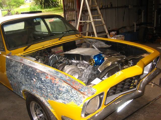

Posted 01 December 2006 - 05:16 PM
Thanks guys!!!

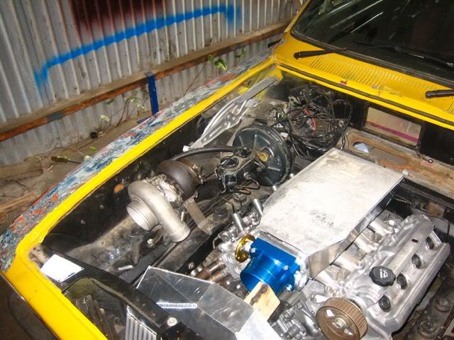

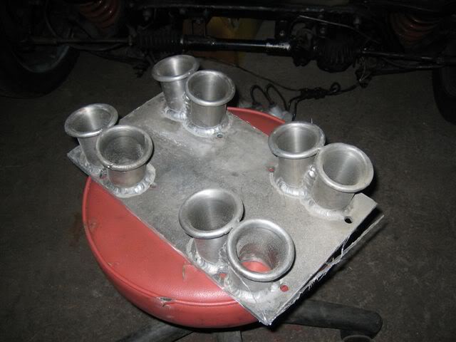

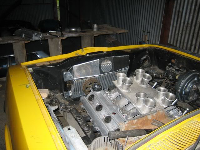

We've now fabricated a new plenum chamber!! Unfortunately the old trumpets/bellmouths are a bit tall, so we're going to have to remake them. But the exterior is made, and you can now see how the throttle body will fit, and plumb straight into the intercooler. It all fits under the bonnet, and it should look pretty sweet!!
