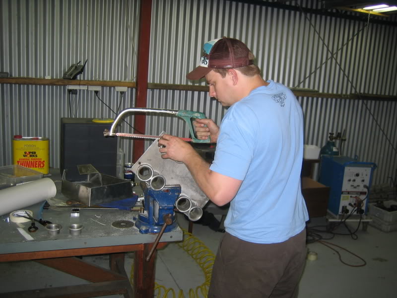

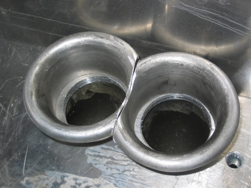

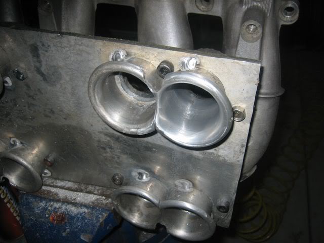

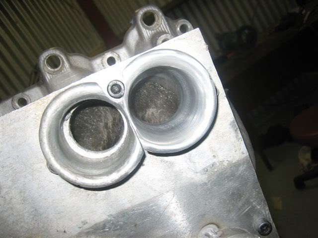

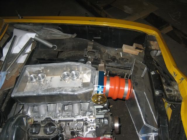

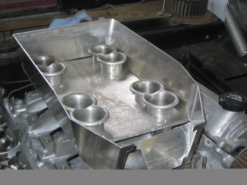

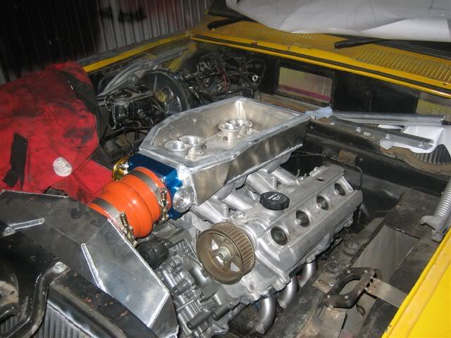

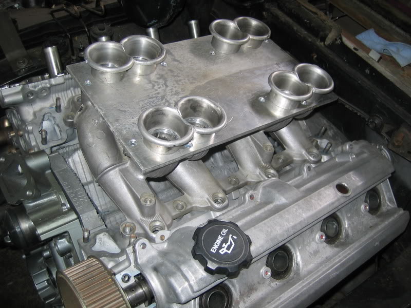

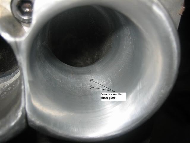

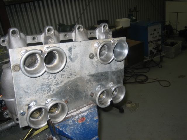

We wanted to shorten the bellmouth/trumpets a bit within the plenum, so we decided to simply slice them off the old manifold rather than making new ones. But the runners are too close together, so when they are shorter the tops of the bellmouths would hit. So we trimmed them so that they fit together. See photos.

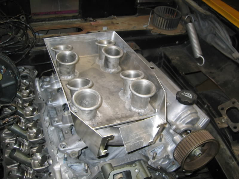

We re-used the trumpets from the old VL plenum, but cut them much shorter...

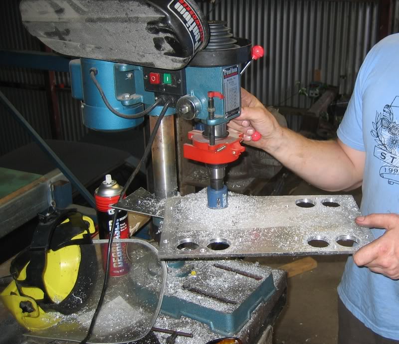

We made a new 6mm thick base plate
The trumpets had to be modified so that they would fit close together
Tack welded them into position
Had to die grind the base plate (and trumpets) to match the runner of the lower part of the intake manifold. Pretty smooth!

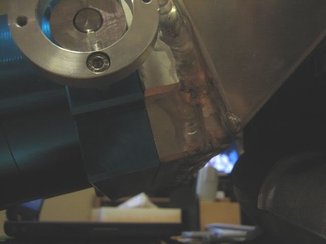

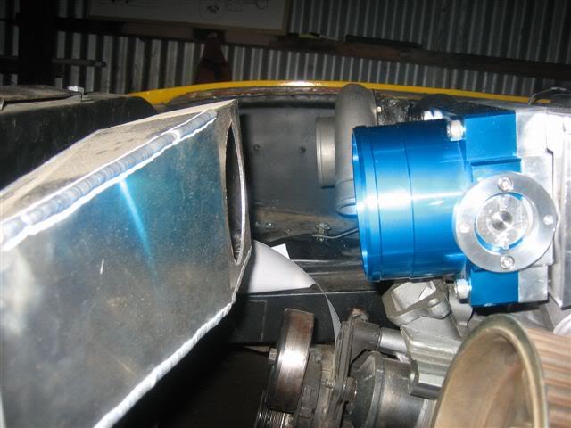

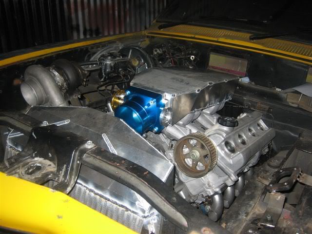

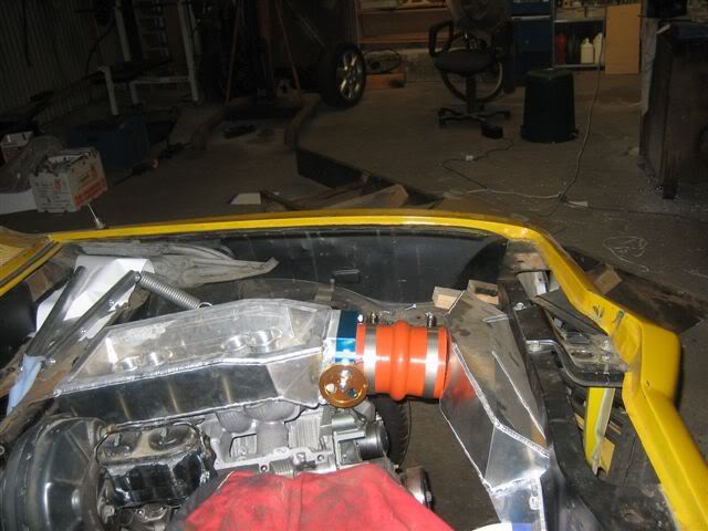

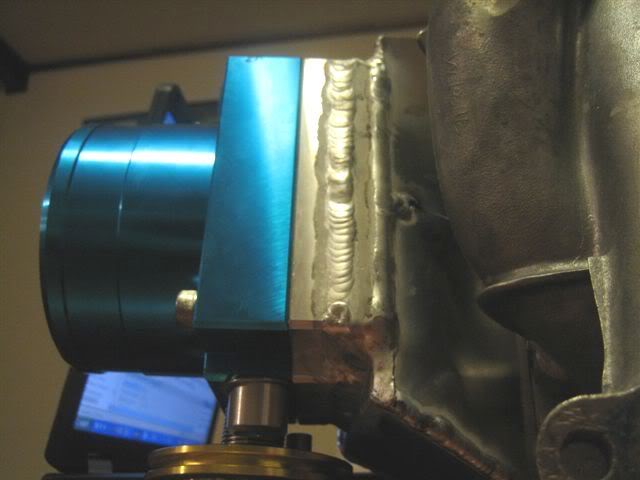

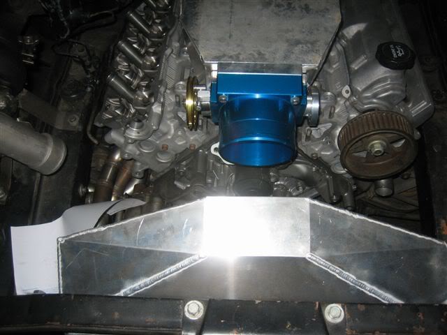

After the trumpets were welded properly, the rest of the plenum was reassembled and tack welded. Unfortunately we discovered a minor problem with our design, causing a slight misalignment problem of the throttle body to the intercooler. It was angling down a bit.
A small mod to the sheet metal and all is good. Its all welded now.

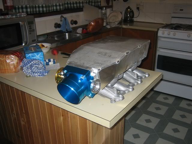

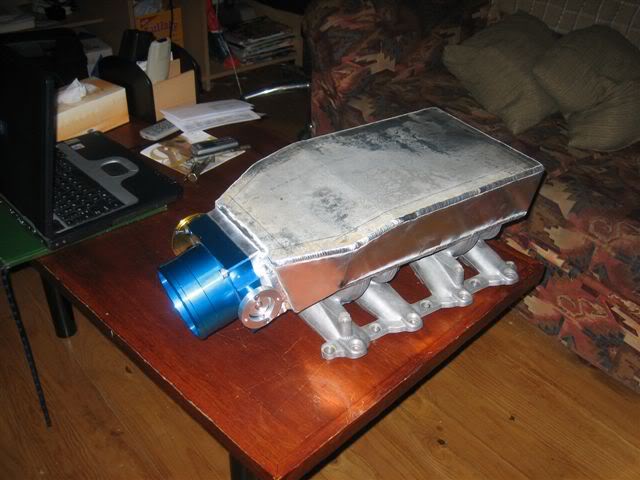

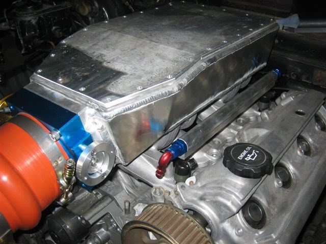

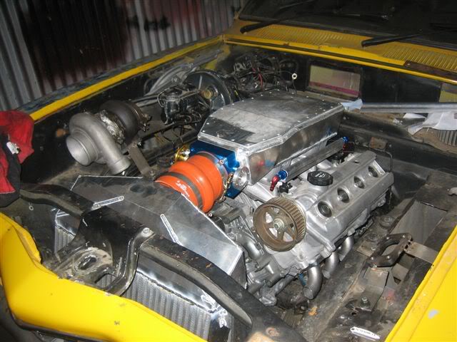

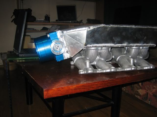

We also bought a (massive) flexible hose from a truck store to go from the throttle body to the intercooler.
The top of the plenum needed to be removable so that the bolts inside it can be done up. So another top plate was made.
You'll also notice in those pictures that we've made fuel rails as well.

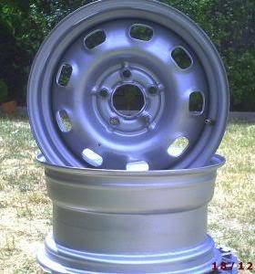

Also, I just bought two Volvo rims for the back of the LJ. Found them on ebay. They suit LJ and they've been widened using ROH steel outers and are 15x8". Not a bad find I reckon...
Unfortunately my 9 inch axles are Torana stud pattern so it was either that or change to HQ. So for now I'm happy just to run silver volvo rims . I plan on running MT 235/50/15 (street) drag radials.
