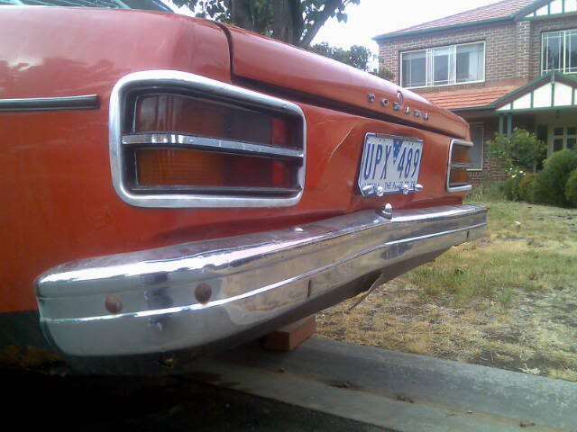

Been a slight misshap were the car is been stored/worked on. 2 days before we were going to fire her up, a car in the drive way had its accelerator pressed instead of the of brake.
4wd got up a little speed went through the garage door and into the back of "Red Rocket" pushing her to the front of the garage into a tool box and work bench :( Luckily no one was hurt and they had insurance.
Insurance has taken a month of F#$&king around and last week said they would't cover it, but after much abuse is now thiking about it again! At least i set salvage rights, just not sure if it will get fixed, written off and some cash for me OR nothing just the car as is.
Oh well it proves these things do happen, this is how she sits at the moment........
So annoying to be so close after being a year off the road and without a car (on my push bike), so many set back etc and to be so close and have this happen, hopefully they will right it off and give me a decent amount so i can fix it. Then maybe i may come out of this with a nicer car they i would have and just had to wait longer!!!!!!!! So much for a 1 month 355 4sp 9' conversion!!!!!
End of vent/rant :P
#56 Statler
Posted 22 April 2009 - 07:09 PM
Chin up m8!
It doesn't look like a hard fix.
Fingers crossed the insurance ppl come up with the $$$ m8!
Did you tell them that the 'imported white wall tyre' was destroyed in the mishap? LOL

I heard about that Luke, the pics are much better than the ones I had in my head tho!
shouldnt be too hard of a fix.....

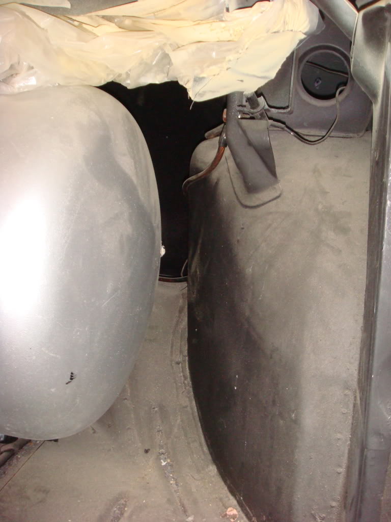

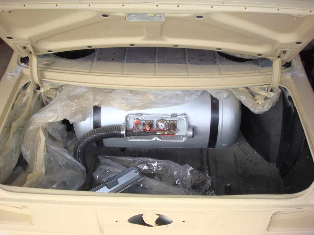

Who's converting your car? Pity your converting now I'm working on a Torana specific tank now (in my own time I don't think work would pay for me to convert the Torana) which will probably be ready in about 3 months. It will be still a normal cylinder though but it will be bracketed instead of it sitting on a cradle. What size tank are you using? I know a F90 (355mm diameter and 900mm long 65Litres usable LPG) fits but I'm hoping a A90 fits (375mm diameter 900 long 72litres of usable LPG). Tell the installer this as the old APA wall chart states that the F84 to A86 fit but you can get the wider tank in there. Well acording to my measurements.
Does your mate Ollie's LH have one of the larger tanks that you are talking about in it? Because I remember looking inside the boot when Michael owned it and the tank looked huge

Yeah, i've got an A90 tank. Its probably the maximum size that you'll get in the A series as the clearance between the shock mounts is about 5mm each side. My tank doesn't have the best mounting, if you can get them to stuff it right up against the back seat and get the service pad a high as possible it'll give you better boot space. As LPG has a low range, i would strongly suggest spending that little bit of time finding the biggest tank rather than taking what they've got on the day, but A90 does me well...

Yours is a A86 Ollie (68litres of LPG), hence the large space either side. What those pictures doesn't show is the fact the tank is about 200mm from the panel between the boot and the back seat. It really wastes space in the boot, to push the tank further forward for more boot space the tank needs to be lifted up over the diff hump. I think a A90 will work as long as you don't have speaker magnets lower than the boot springs, but I cannot guarantee that it definatly does fit. It definatly will without the boot springs.

Oh forgot to mention, If your choosing your tank size you can do some simple calcs to find out your range so you don't get too peeved that you run out of gas to quickly. A90 fills to max 72 litres @ 80% AFL (automatic fill level for gas expansion with heat), my mild 308 twin gas research chews ~20L/100km for town driving; therefore the range will be ~300kms (bit left because its a little harder to refuel on the side of the road, although can be done with bbq canister if really really really desperate)
Well it definately has A90 stamped on the tag on the service pad, see attached photo, so we have to options, your wrong or your company put the wrong tag on it.
Yes, i probably should of mentioned that there is an amp and dead space behind my tank and the tank can be stuffed in a fair bit more ~150-200mm.. If your putting the tank right up against the back seat its gonna be tight/foul on the boot springs, but you could put it in as far back as you can.
