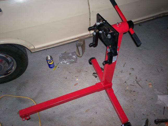

good thinking Tiny,i have the same stand in your first pic RIM,ive never liked the
look of it stability wise and it doesnt roll very good the wheels are pretty crappy,gonna get some box tube & decent castors and fix it up asap.might even paint it a better color. P

I've got one like the first pic, I've had it for about 10 years and it's had several engines on it. The wheels coould be a little larger but apart from that it has been great. The ability to pull it apart when finished to store it is a bonus. It is very stable with the 4 wheels.

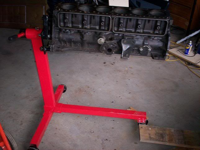

heres a super shit one that i bought today, took 20mins to put together and yeah, its not exactly the best out there, but hey, it cost $70 so itll do.
