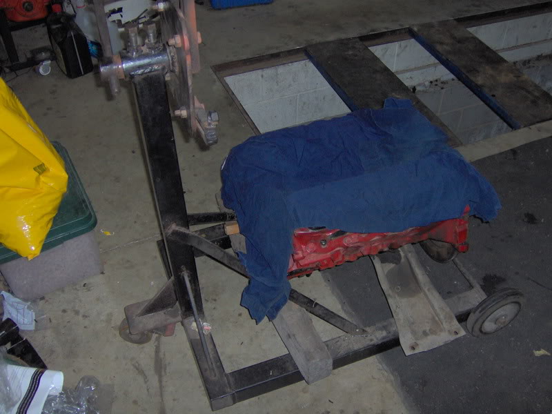

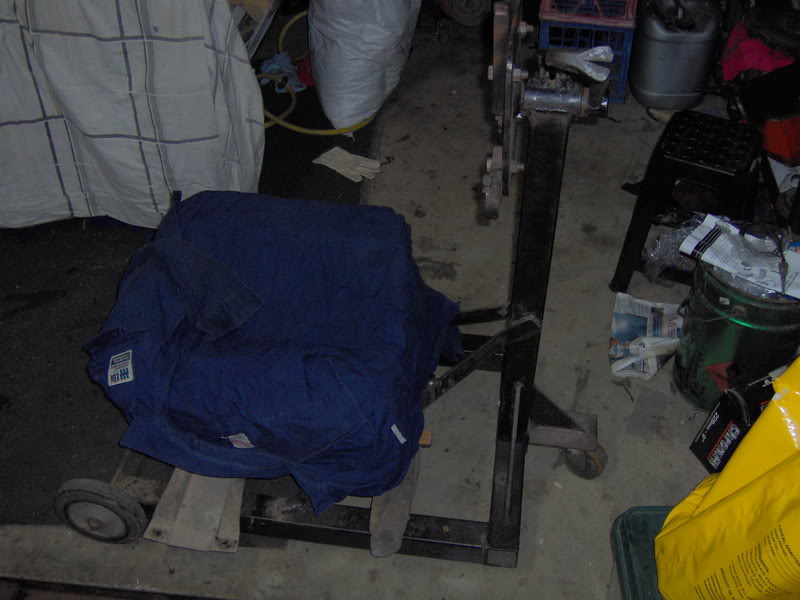

the front wheels are from a wheelie bin,and the back one is a lockable castor.
as you can see it is also used for putting spare blocks on when they r in the way.
the handle is just a crow bar or what ever is handy.the shaft that goes through the tube is a twistlock spigot.just a piece of 6mm plate cut at 400mm square with some 3/4 bolts holding the arms on.
pretty simple stuff,but it works

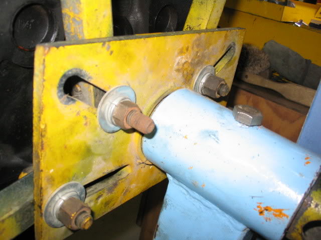

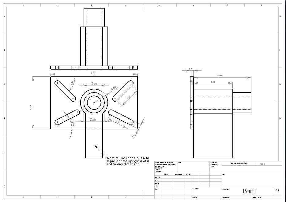

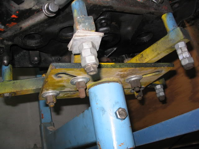

Can someone get a pic of the 'head' on their engine stand, with a few measurements? Like how long the arms are, how long the holes in it are, how thick the plate is, etc etc.

Posted 09 May 2007 - 11:06 PM
hope this helps ya mate!
