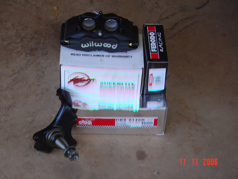

The stub axles I have got are standard HQ, I am using 15"x8" Simmons wheels with 225x60x15 tyres (50/50) offset
Thanks to Dattoman for hooking me up with all the new brake components and look forward to hearing all your advice.

Yes I am using HQ discs and the Wilwood calipers that are in the picture(bolt straight up to the HQ stub axles) I have an LH torana.
