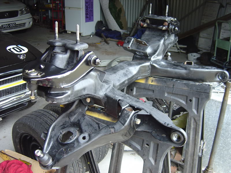

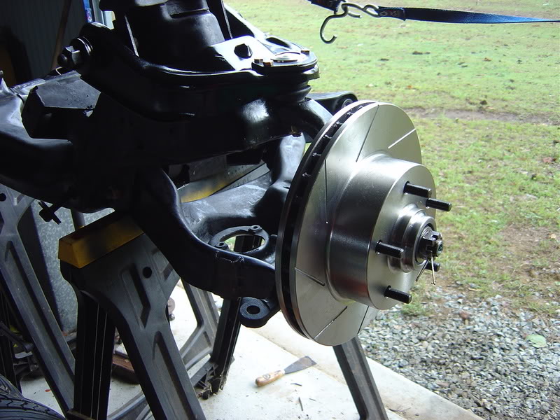

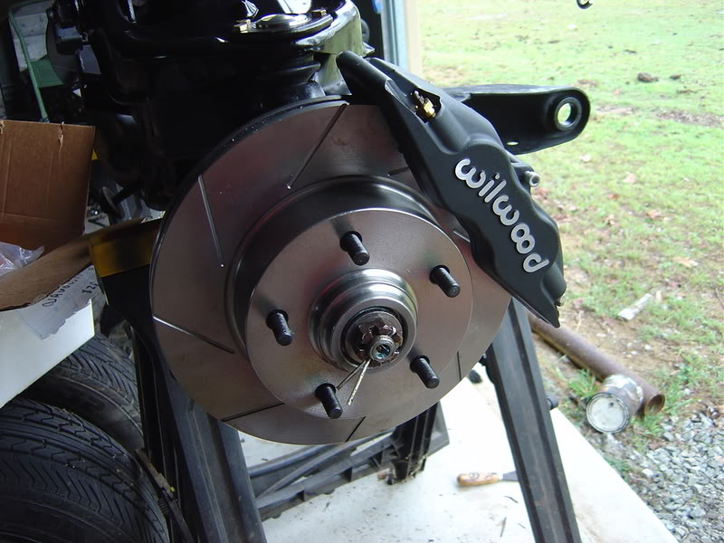

#68 _rorym_
Posted 04 January 2007 - 09:32 PM
UC front cross member,UC top arms, UC rack, Nolathene everything. UC steering arms. HQ Slotted. Wilwood calipers. 1100lb front springs, Koni shocks set at 10/10. as per HDT specs.I will post more pics when the springs and shocks are fitted but for the money..I reckon you would be hard pressed to get a cheaper/better value front end. After watching the build of this thing from scratch you mongrels better come out and watch it run and fire a shot in anger! :D
