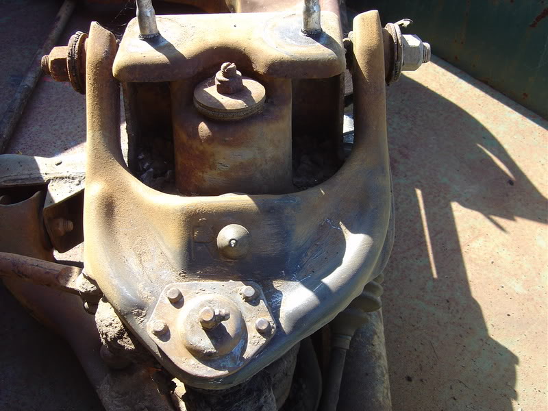

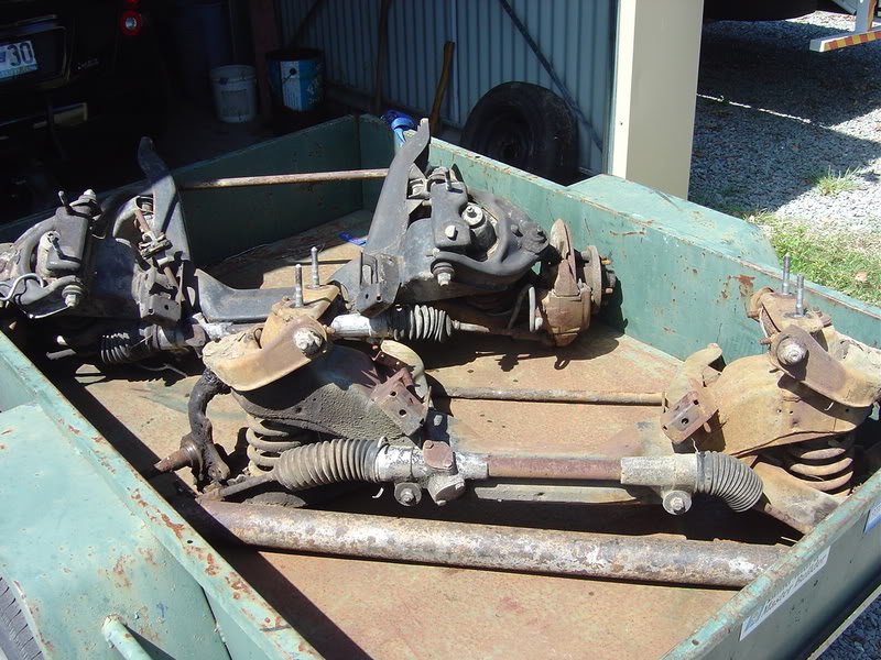

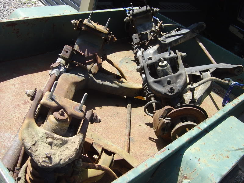

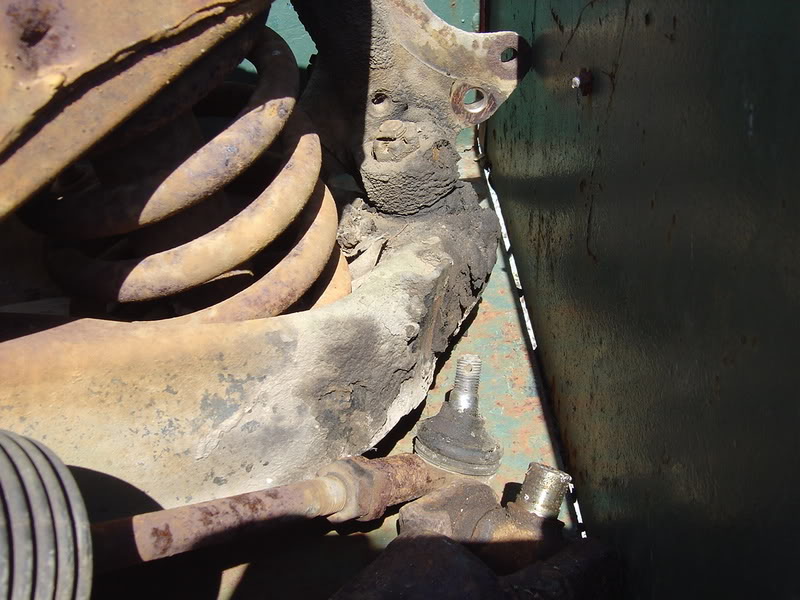

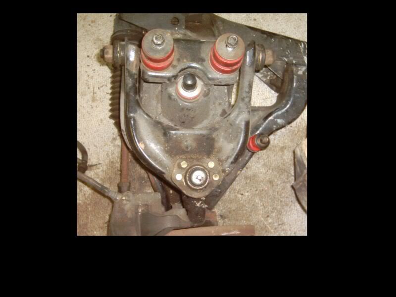

I now have a UC and LH front end side by side..not cleaned yet but I will post a pic to show the differences talked about up there ^^^
#35 _rorym_
Posted 25 November 2006 - 02:32 PM
The UC is the front one..notice the balljoint is off set to the rear.
The UC steering stop
Side by side..UC closet./dirtiest one.
#36 _rorym_
Posted 25 November 2006 - 02:50 PM
The LH UCA is located 40mm down from the flange lip...the UC is 25mm.

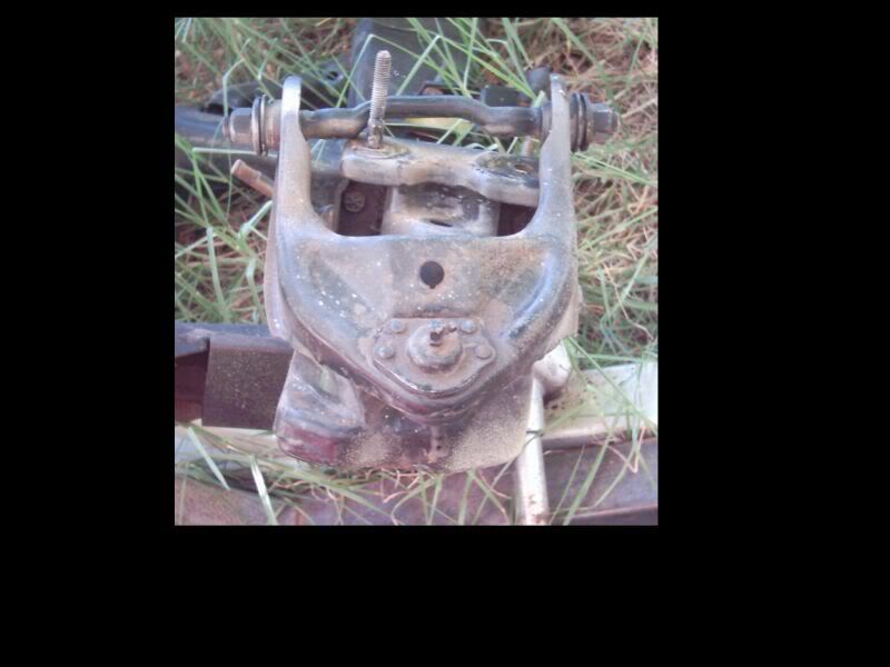

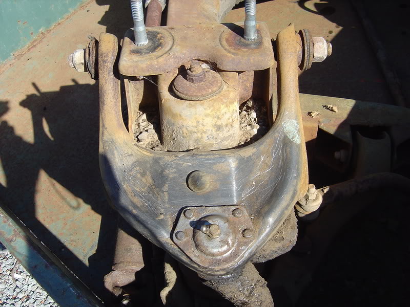

Those top arms aren't UC
UC are offset top balljoint
#39 _rorym_
Posted 25 November 2006 - 04:43 PM
First pic...right one came out of an LH...notice the grease nipple lines up with the bumpstop rubber and top mount...left hand..dirty one I personally dropped out of the UC...the top ball joint is not inline and offset to the rear..?..Or am I not looking at it right?
Neil? Dont you confuse me now!! :huh:
Charlie...25mm lower than the UC height..50mm down from the flange..I think thats what M@ did..I will go back and check.
Here tis!!
I have redrilled my UC one on the test bed to the same as what is in my car and that front end is an RTS LX front end. The bolts for the Upper control arm are about 50mm down from the flange - you could probably have drilled this one about 3 or 4mm lower if you were after every skeric but I was trying to simulate the setup in my car.

#41 dattoman
Posted 25 November 2006 - 07:43 PM
Must just be the dirt then
Cause they didn't look very offset to me at first
Mine are cleaner and more obvious
#42 _rorym_
Posted 25 November 2006 - 08:28 PM
Whew! Thank christ for that!!..I cleaned the dirt off..they are the same as Neils..Dattoman..WILL YOU STOP GIVING ME A HEARTATTACK! :spoton: Lol!
