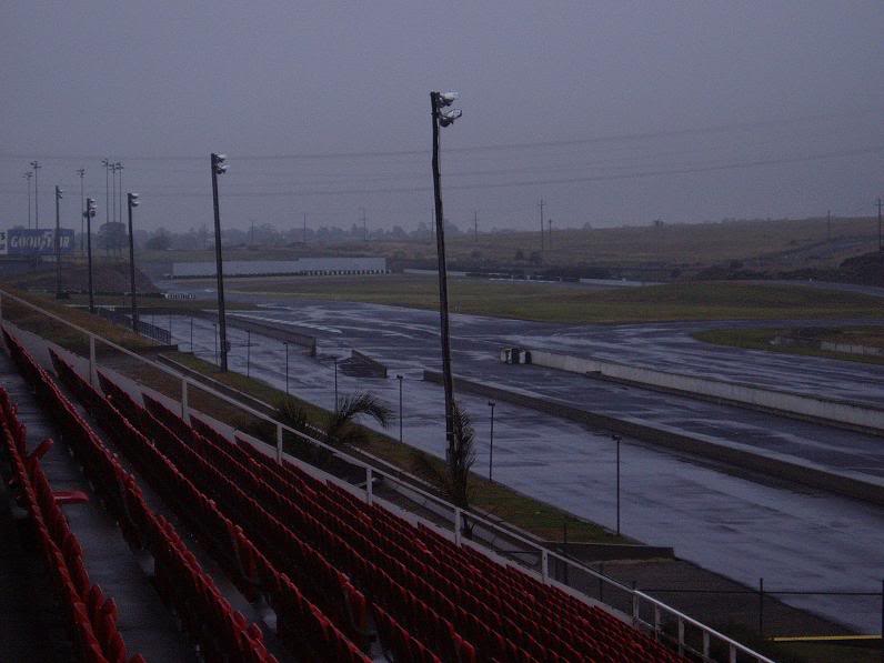

The day was washed out DAMMIT! :Headbang2:
An hour and a half return to Calder from here.
Entry fee will be refunded though. :)
No more club racing this year on the calendar. :cry:
