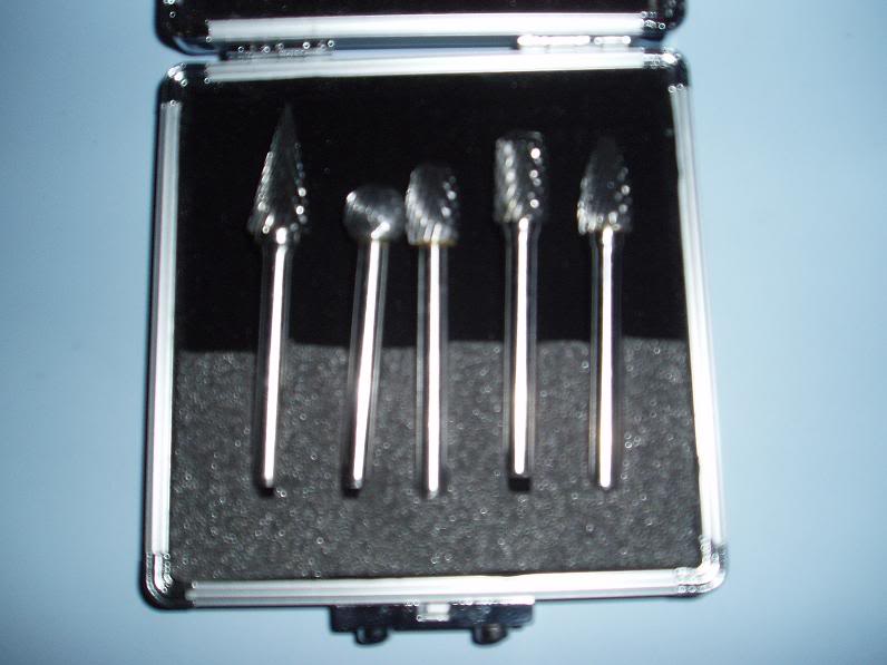

5. Port matched, hand finished, extractors.
These are the extractors that have always been on the motor. They are Motorvators.
I've never really been happy with them but there aren't much better around unless I want to spend big bucks.
The "off the shelf" stuff all seem to have some sort of manufacturing "quirk" about them from what I've seen. Whether it be the way they weld the primaries to the header plates, the shape of the collectors and the way the pipes, primary and secondary, are welded to the collectors.
So I bought a set of these. $99 at Total Tools.
Then proceeded to match port and hog out the header plates.
Another problem I have found with "off the shelf" extractors is the way the secondary pipes are fitted INTO the collectors.
So I cut them off and removed the portion of pipe protruding into the collectors.
Then, using the RoDoMo flaring tool, put a slight flare on the end of the secondary pipes.
And welded them back on OVER the collectors rather than INTO.
These are the prototype, I have better ones for when the R&D developments are complete :ph34r:

Was it hard to seperate the collector and the secondary? Looks great
#459 rodomo
Posted 06 December 2009 - 10:13 AM
Not the easiest task.
Obviously thin cutting discs were used and the cut finished with a hacksaw as the discs wouldn't go the depth in the area where the 2 pipes are close together.
I cut "just" to the collector side of the middle of the original welds if that makes sense?
You can see in a pic above that the pipe was still welded in places but I could get a grip with pliers and twist it out to a degree. The burrs and angle grinder helped to complete the task.
If you cut too far above the weld, you would have trouble getting them to match up again I think.
