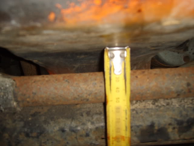

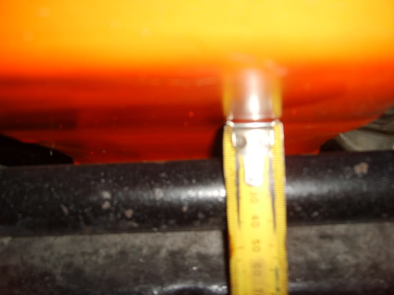

Posted 09 March 2007 - 04:29 PM
the other car uses the HQ type bracket and the gap is only 13mm.
the top pic is torana with old original mounts 22 mm
the bottom pic is torana with new HQ mounts 13mm.
