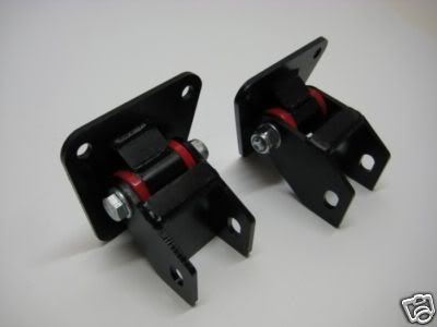

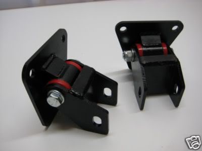

#74 dattoman
Posted 17 June 2009 - 11:20 AM
I want to throw this cat I've been saving amongst you pidgeons
How about these.... anyone seen them, used them , know anything about them ?
For $325 they look exxy ... compared to normal plates and rubber mounts... but I can see some benefits in these
http://cgi.ebay.com....em=260426937452
Posted Image Posted Image
These mounts are to suit all HQ-WB Holdens also LH- LX Torana's
These mounts have been designed to suit big HP applications but would suit all applications
All "TUFF MOUNTS" are made from 5mm steel with an easily removable bush
These mounts have been designed to mount the engine steady at all times
Ideal for race and burnout applications
They are a straight bolt up fitment with easy to replace bushes
Also makes engine easier to remove and refit
Designed and manufactured in Australia
Available to suit
LH-LX Torana, HQ-HJ-HX-HZ-WB with Holden 308
LH-LX Torana, HQ-HJ-HX-HZ-WB with Chev small block
LH-LX Torana, HQ-HJ-HX-HZ-WB with Chev big block
VB-VT 308 Commodores
#75 lx308
lx308
  • 2,843 posts
  • Name:Tony
  • Location:Australind
  • Car:Nuffin. Goin touring.
  • Joined: 25-March 07
Posted 17 June 2009 - 12:57 PM
Available to suit
Datto,
I wonder if there is a difference between the Torana mounts & HQ mounts? Probably not. I looked at these, I think A1 Hiperformance in Perth sell them also. I agree they look the goods, but like most things aftermarket that fit Torana/HQ-WB - they are for HQ-WB, & can also be used for Torana.
