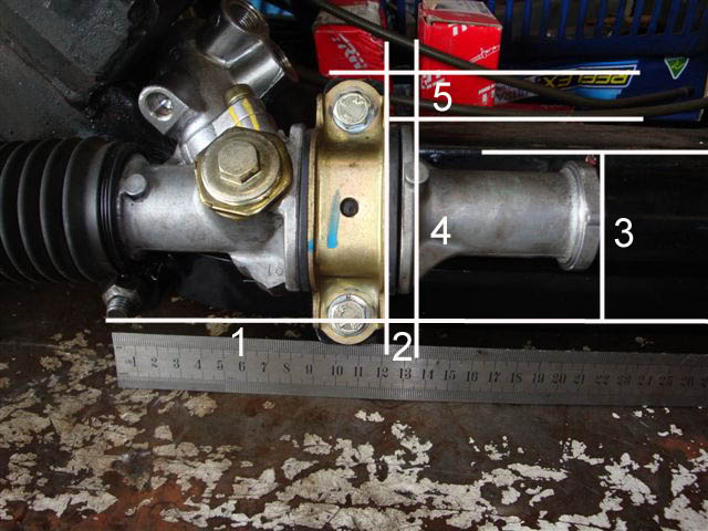

Hi All, I am getting heaps of PM for power steering racks to suit LX with chev GEN3 engines, I have attached photos of a rack in the setup cradle. Check to see if your engine falls inside the envelope of the steel rule measurments, if it dosen't then the engine mounts may have to be modifyed to suit. CRS never made there mounts to do this conversion. It may mean you only have to raise the engine by 15mm or shift it to the passengers side to clear the rack mount cradle bracket. My concern is more to do with the sump and sump rail clearance on the drivers side not the hight of the rack in the centre.
Lenny.
Attached File  DSC04439.JPG   53.62K   70 downloadsAttached File  DSC04440.JPG   51.44K   80 downloadsAttached File  DSC04441.JPG   64.84K   71 downloadsAttached File  DSC04438.JPG   60.51K   77 downloadsAttached File  DSC04437.JPG   55.74K   26 downloadsAttached File  DSC04437.JPG   55.74K   26 downloadsAttached File  DSC04435.JPG   73.53K   68 downloads

These are the measurements using the center of the cradle mount bolts as the baseline that I would like.
Measurement #1 appears to be 120 mm which would put it around 10 mm into the oil pan.

Thanks ls2lxhatch nice work on the lines in the photo, 10mm interferance is around the number I come up with to, can you move the engine over to the passengers side by 12-14mm ?
If you can fill in the other measurements then I will be able to see how much clearance is required and can look at options
I would not be prepared to move the front of the engine off centre as it would most likely cause problems with vibration at the tail shaft. It may be possible to move the engine and transmission across but this would probably require a redesign of the headers.
It may be possible to cut into the oil pan for clearance.
It may also be possible to redesign the rack mount bracket to improve clearance. Possibly rotate it 90 degrees.

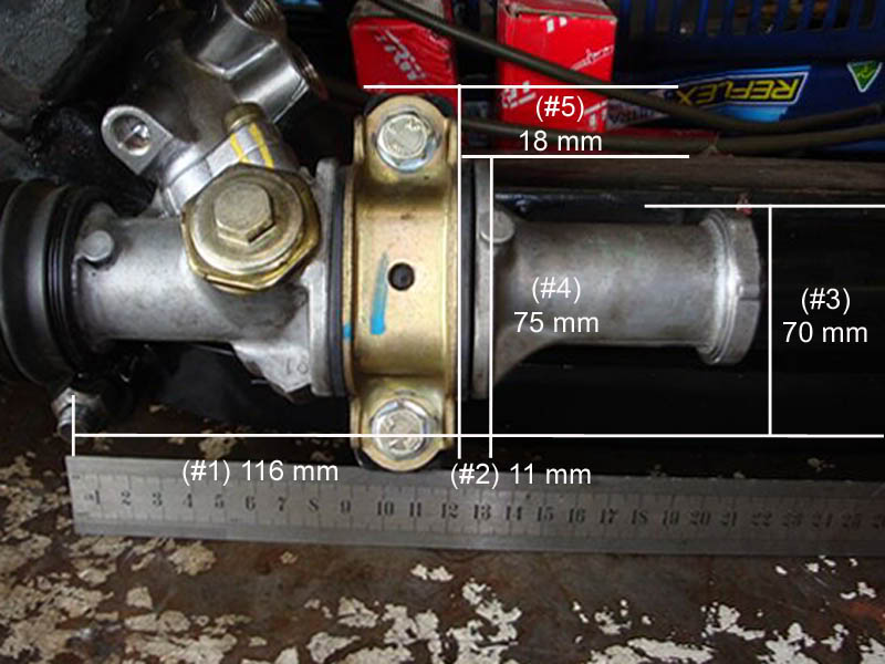

ls2lxhatch,
1= 116mm
2= 11mm
3= 70mm
4= 75mm
5= 18mm
#1 is from the original rack mount bolt centre to the edge of the front cad plated rack retaining plate as in your line in the photo.
Note; right rack mount bolt is not level across to the lower cad plated bracket retaining bolt the line you put on the picture is not level in relation of the rack. also check the other photos for measurments for hight. I sent five racks out yesterday to get them reconditioned so I carn't get a one hundred percent measurement untill I set one up again. For #3 if you put a straight edge on the K-frame section this K-frame section hads about a 8 deg slope down at the rear and then increases to about a 20 deg angle further back put it on the 8 deg flat section and the measurement would be around 3-4mm to the top of the power steering rack cylinder to the underside of the straight edge. Where you have #3 on the photo the line and the aluminium hex would be no gap under the straight edge i.e this hex is raised by 3mm.
Hope this makes sense and I didn't confuse.
Axistr.

#309 ls2lxhatch
Posted 12 February 2010 - 10:09 PM
I think that the HQ-WB CHEV mounts rotate the engine but maintain the centre line. If the gearbox is skewed then that would create uncancelled angles which if large enough will cause vibration.
I have 75 mm between the center line of the rack mount bolts and the oil pan. I can lift the engine around 5 mm but much more than that starts causing issues with bonnet and header clearance. I can cut another 10 mm out of the oil pan which would make it the same depth as the Camaro oil pan.
If you could come up with a revised mounting bracket then it should fit with minimum of 10-15 mm clearance.
Do we have the same issue with the passenger side mounting bracket?

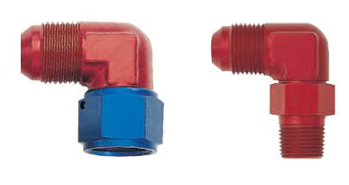

Can you provide the measurement for the hose fittings?
Going by the pictures I have seen the lower fitting will be a problem.
A couple of options.
1. Machine the steering box to accept banjo fittings.
2. If the thread in the steering box is NPT then there may be an XRP fitting to suit.
3. Weld an aluminium Male flare fitting to the steering box
I think the banjo fitting is probably the simplest and most compact solution.

Hi ls2lxhatch, I went into the hydraulic fitting clearance issues and tried to use banjo fitting but not available as the rack has o-ring seals at the bottom.

If you machine the face of the steering box to seal the banjo fitting then the o-ring seal will not be required.

ls2lxhatch I did some more checking on the bango fittings and they can be used but the space saving would only be around 8mm it all helps, but I think there is still some reason why I didnt go that way.?the problem might be trying to attach the flexable hoses, needs 1,200 p.s.i fittings. There is a small recess where the fittings go into the rotory valve which will take a copper washer so we shouldn't need to do any further mechining.

Hi all, I got some spare time today to check out the bango fittings for the rotary valve with my hose people, the bango bolt and fitting is no problem and will save around 25mm of room over the current fitting. The down side is that the only bango fittings that are available only in push lock style connection for the hose, this would be ok for the return but no good for the supply from the pump. The push lock type will handle 400 p.s.i the pressure side needs around 1,000 - 1,400 to make the connection work. They would need to cut the tail off and drill out the bango fitting, and silver solder a threaded nipple into it, this would be getting close to the rating of the fitting and solder. Allthough the bango fittings will work they would be more supseptable to leaks as the rotary valve was designed for an o=ring seal fitting at the base of the fitting.
It can be done but you would need to be carefull when fitting the hoses and bango fittings, the bango bolt will need copper washers on both sides but do not over tighten the bango bolt as they stretch very easy.

G'day ls2lxhatch, Andy I have now had a chance to sort out the fittings to reduce some more room needed in the supply and return hydraulic fittings on the rotory valve, sorry about the bad photo on the old motorolla mobile but it should give you some idea between the two types. The revised fitting should save around 25mm. These fitting have been modifyed to take standard hydraulic fitting and takes a lot of time to do just like every other mods with these racks, they just take up so much time to do and the lack of time has been the killer. The racks are not designed to take banjo fittings and should work ok but I would still prefer to use the nipples fittings with o-ring seals where possible as the banjo and copper washer would be more acceptable to leaks on the pressure side. I even had to mechine the banjo bolts because they are not available in the right length.
Axistr

The banjo fittings will help with the clearance issues. I am still doubtful that I will be able to fit the rack with my setup however there is only one way to find out for sure. Let me know when you have a rack ready to trial fit.
