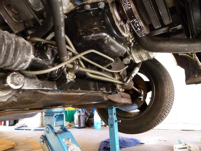

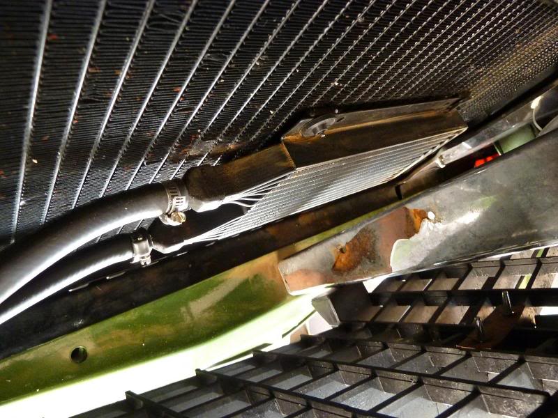

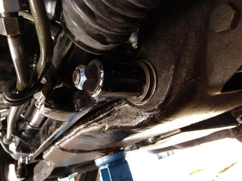

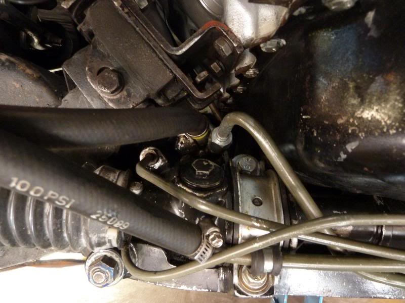

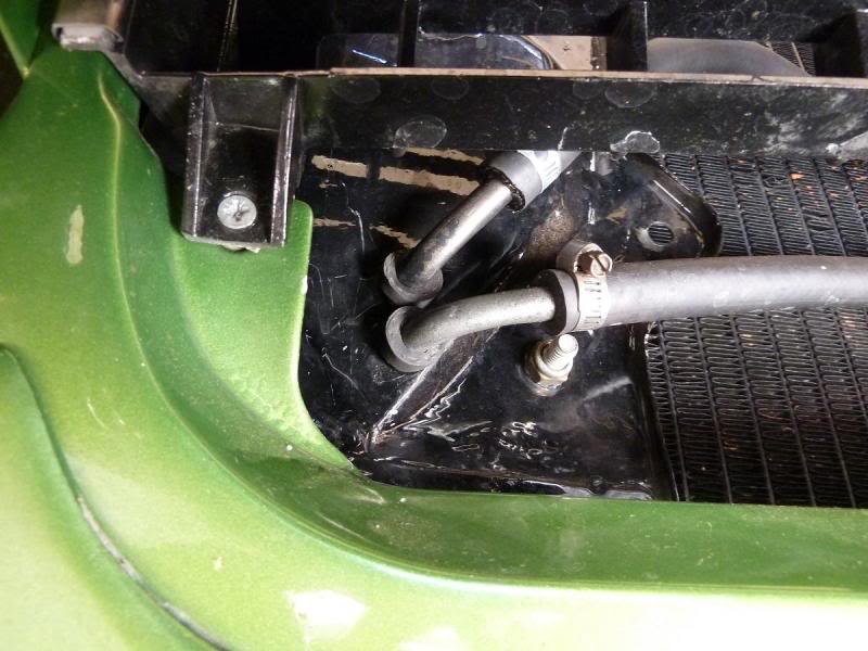

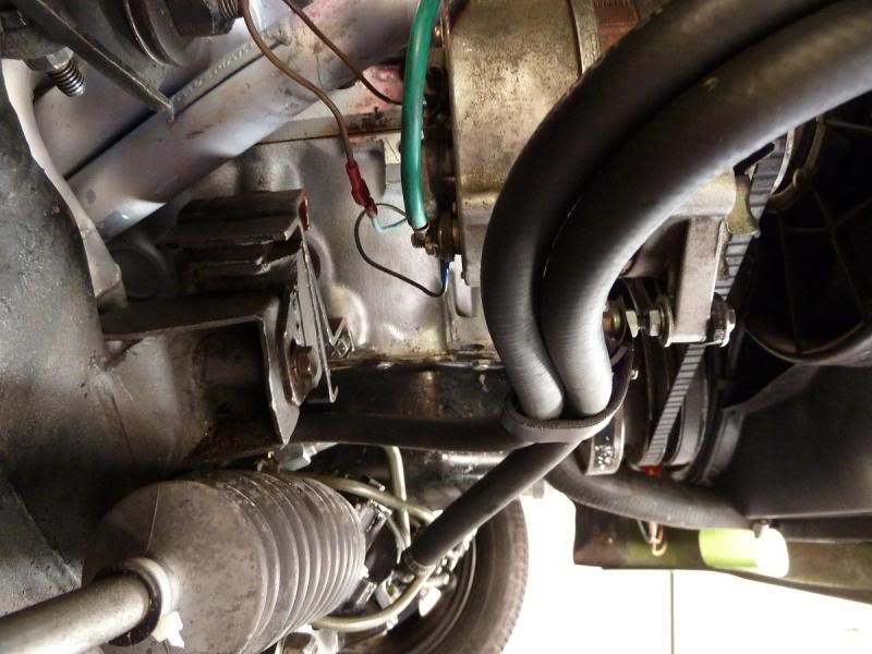

Posted 07 April 2011 - 02:47 PM

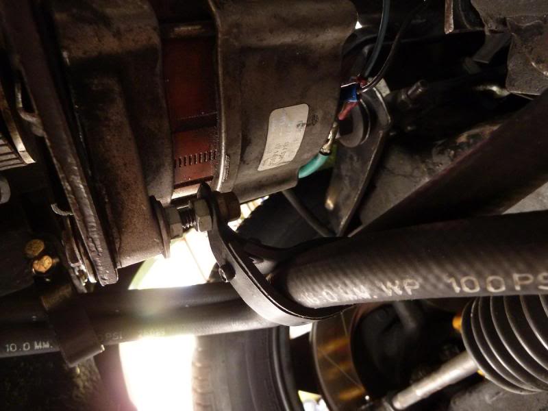

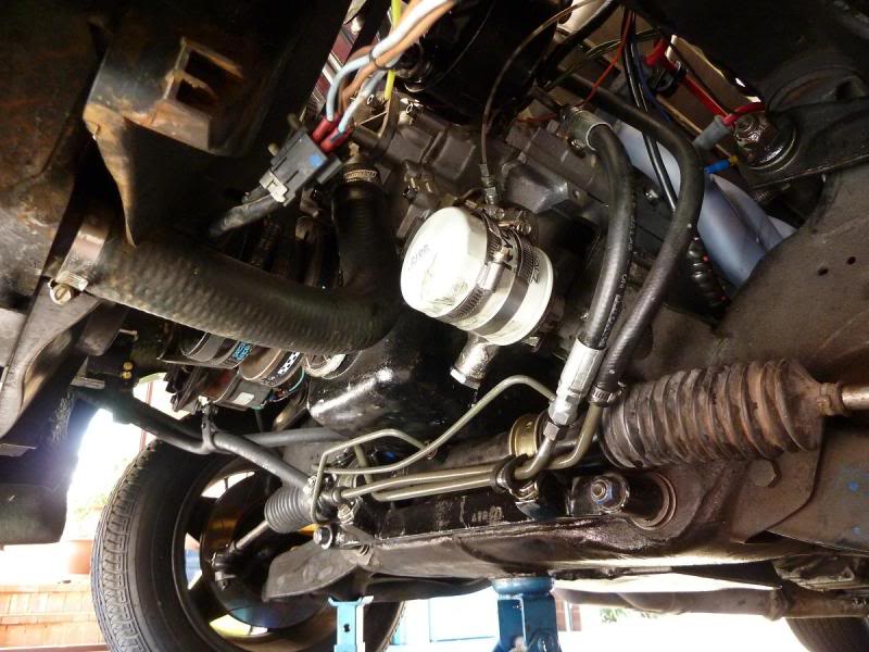

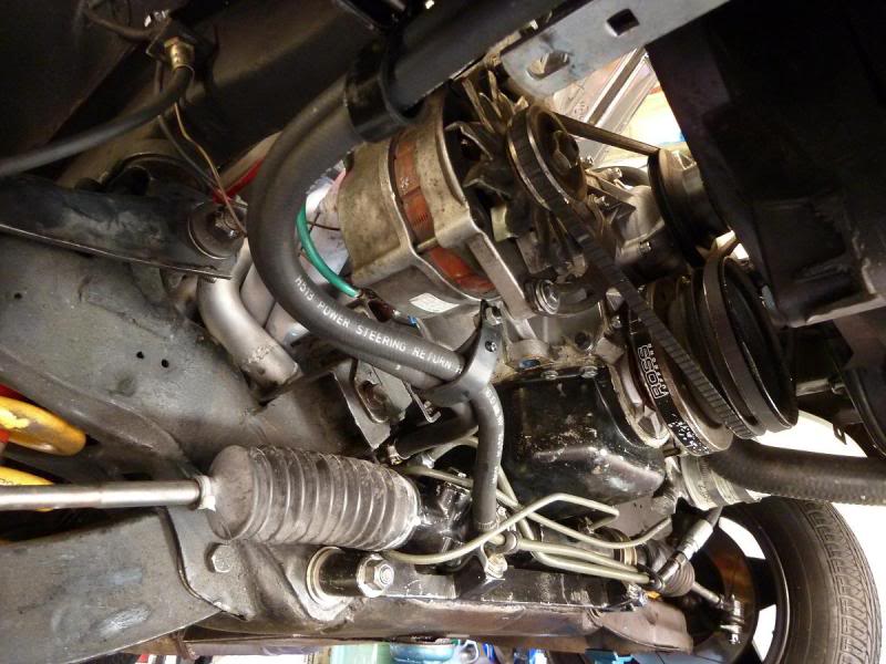

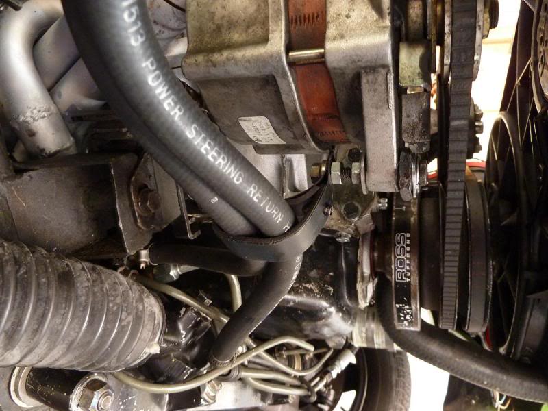

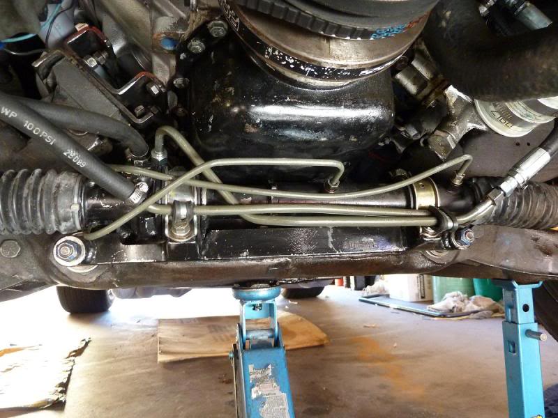

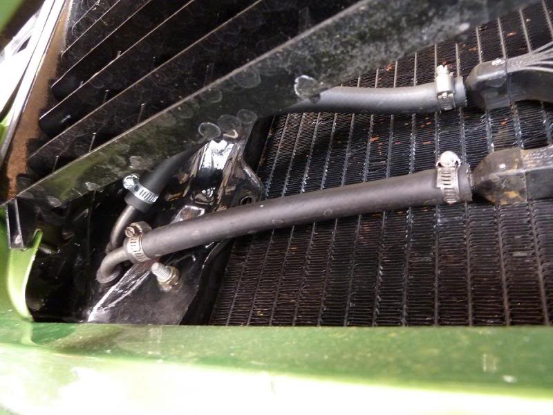

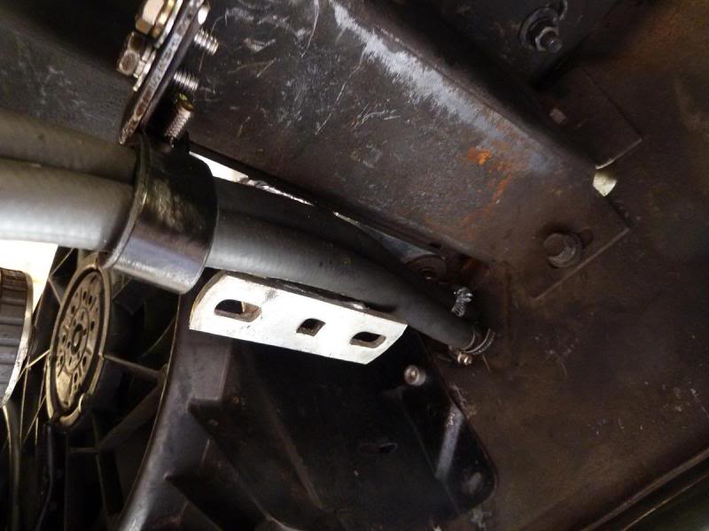

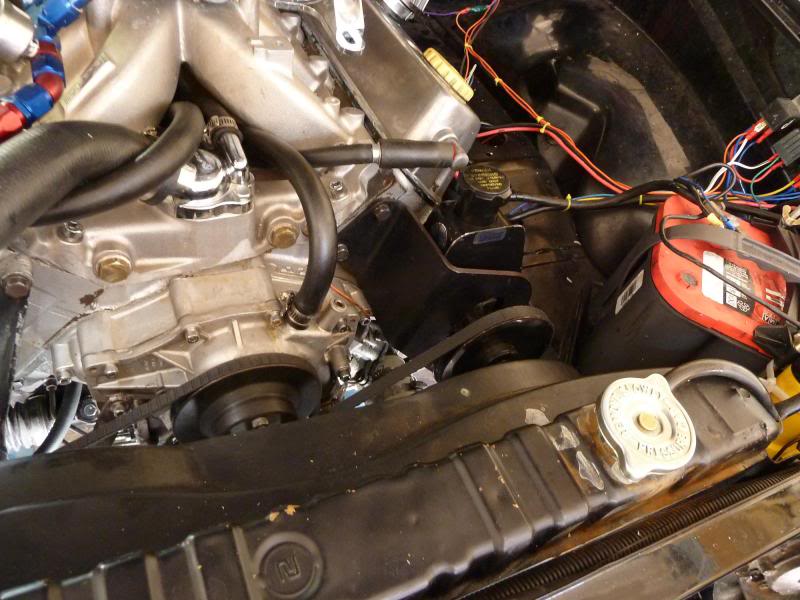

I would like to thank Lenny for the kit. Quality workmanship and service.
I thought that I would put some photo's of how I ran all my lines and cooler for it.
It was a little time consuming but in the end I an Very happy with it.
I had to put some 5mm shims under the rack mounting to the cross member as it was fouling and wouldn't bolt up flush. As Lenny has said, these cars weren't built to precise measurements. lots of little mods and brackets were made to make it look a little more factory. I had to do some extractor mods too which was expected as I had to put my flexible coupling back on.
the Torry certainly doesn't feel like a muscle car any more. With power steering, hydro clutch and Toyota gearbox. I kind of miss the muscle feeling.
My only problem I have at the moment is I keep throwing the power steering belt off when I give it a rev. I will start another thread to try and figure out that problem.
Enjoy.
Evan.

Posted 09 April 2011 - 09:24 AM
G'day Evan good work, Just check you power steering pump alignment as I have installed two pumps & brackets with VN heads and both we had to space the bracket further forward to get them to align up. Also check to make sure that the pulley's don't have excessive runout.
Hope this helps.
Lenny
