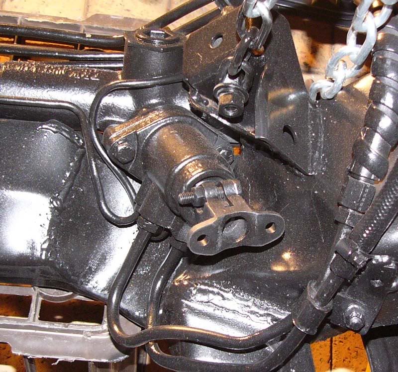

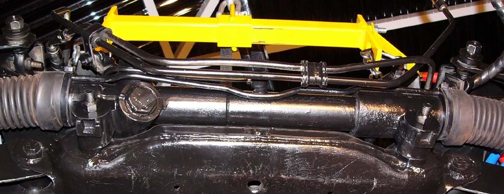

#82 ls2lxhatch
Posted 20 November 2006 - 08:37 PM

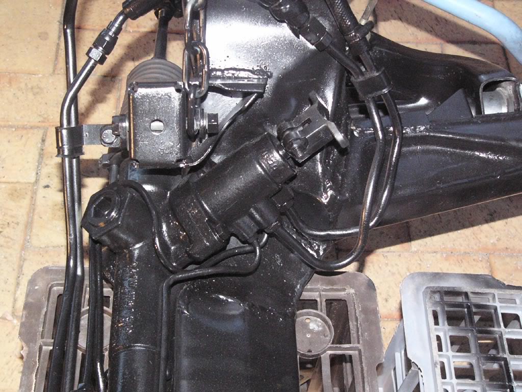

https://cache.gmh-to...h/P1110889a.jpg

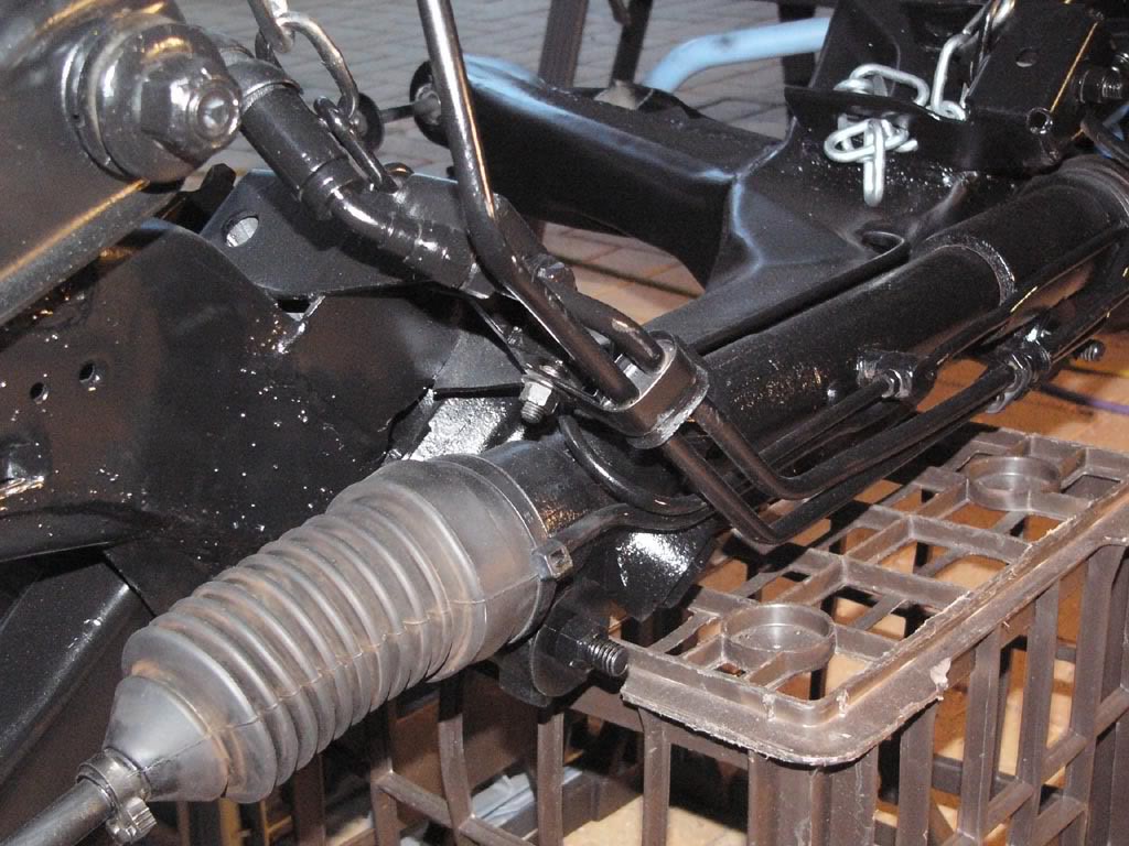

https://cache.gmh-to...h/P1110888a.jpg

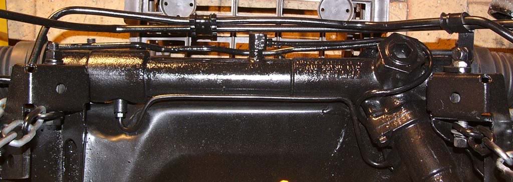

https://cache.gmh-to...h/P1110884a.jpg
The conversion was done in 2004. The rack was reconditioned and a new commodore power steering pump fitted. It is about two turns from lock to lock and the turning circle is close but not quite the same as the standard rack. A large chunk has been removed from the K-frame to accommodate the power steering unit and get the rack to steering arm angles right. The RHS engine mount had to be modified to provide clearance.
When I had the wheel alignment done by WA Suspensions I asked about the bump steer and was told it was within normal range for a Torana. I have to get the car engineered because of the LS2 conversion so I will get a formal analysis done then. I hope to have that completed by the end of the year but I am still waiting on parts. I expect to refit the K-frame in the next couple of weeks so If you want a specific photo let me know soon.
Personally I would like to see a K-frame fabricated from steel tube and designed for a power steering rack. In the late 80's there was a company that advertised a fabricated K-frame on the back cover of Street Machine but I have not be able to find the ad or the company since. I am sure there would be many people happy to purchase a K-frame setup for common power steering that is stronger than the original.

Thanks for the pics Andy,
Did you do the conversion? or is this a CRS or other mod?
What steering arms are those ones? They look rather Hq-ish.
It looks like it has been mounted right back and as high as possible which is where I estimate it needs to be. How are the main mounting bolts done?
Does the rack bolt hard against the crossmember or do you use some spacers between them?
I have no idea of the facilities at WA suspensions but I highly doubt they plotted your bumpsteer curve during a wheel alignement - this requires your spring and shock absorber removed. I find some places will just feed you BS if you start asking hard questions rather than just tell you they don't know something.
Any chance of a pic directly front on to show if the Cortina rack sits proud of the crossmember through the mid section below the engine?

#86 ls2lxhatch
Posted 21 November 2006 - 11:57 PM

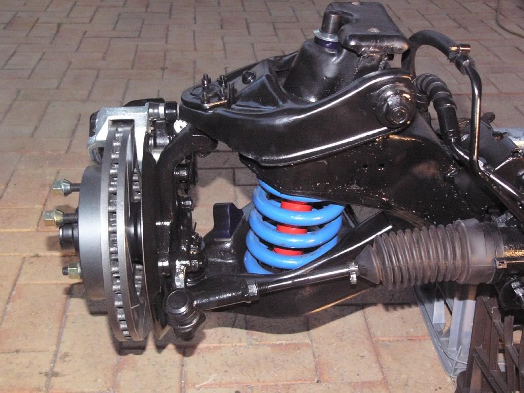

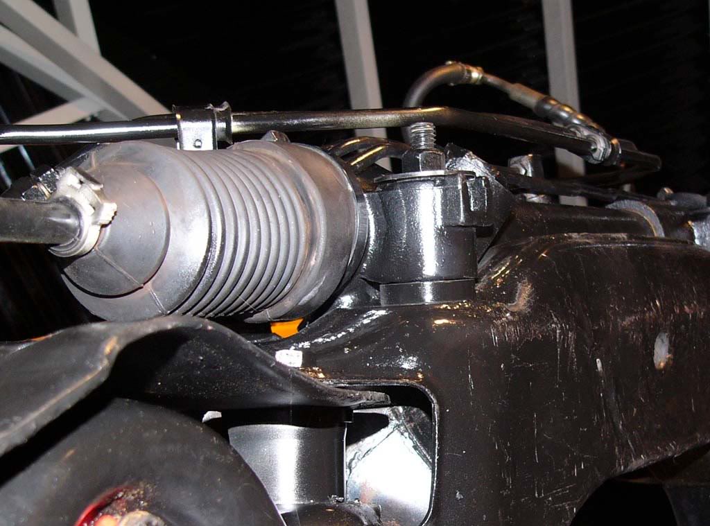

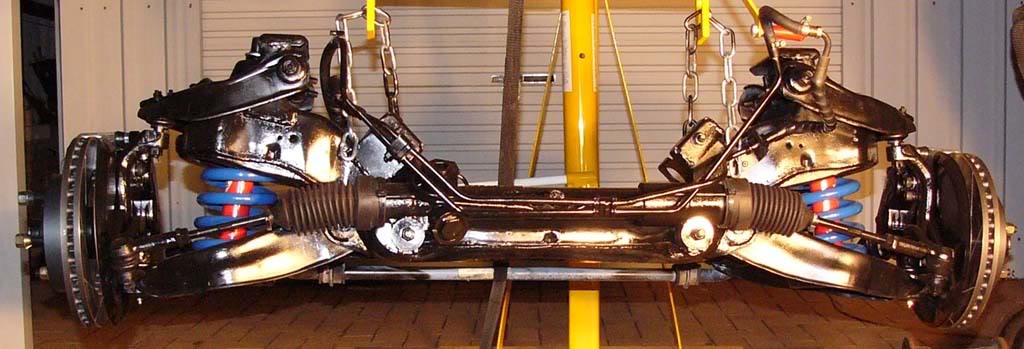

The stub axles and steering arms are standard LX RTS Torana with Hoppers brakes.
I have owned the Torana since 1988. During most of that time it has been my only car. I drove the car for about a six months with the power steering and wished I had done it years ago. The first thing I did after getting the power steering was replace the GTS steering wheel with a sports steering wheel. I like the look of the GTS steering wheel but they feel like they would be better suited to a bus.
The two turns lock to lock steering ratio is the most significant difference, it makes the car feel more responsive. The steering feels very similar to the steering in my Subaru Forester positive but not heavy. It was good enough for me to decide to continue on to stage two of the rebuild (drive train, brakes, rims). Once complete I will sell the Forester which I only bought so I could work on the Torana.
WA suspensions did not do a formal bump steer analysis. It was just a casual comment based on the comparing the affect on toe in/out over a limited amount of suspension travel whilst performing the wheel alignment.
The rack is mounted on aluminium bushes using the same style bolts as the standard rack but about an inch longer. It is very difficult to find two high tensile coach bolts in the required length. The standard bolt holes were moved to slightly to the RHS. (From memory)
I would not have thought that it would be that difficult to get a steel tube K-frame passed by an engineer if the original geometry is maintained. I would like to see a picture of the one that was on the back cover of Street Machine again. I think is was between 91 and 95 now.
I will take some more pictures in the morning.

A few more pictures.
https://cache.gmh-to...h/P1120083a.jpg
https://cache.gmh-to...h/P1120087a.jpg
https://cache.gmh-to...h/P1120090a.jpg
https://cache.gmh-to...h/P1120092a.jpg
https://cache.gmh-to...h/P1120094a.jpg
