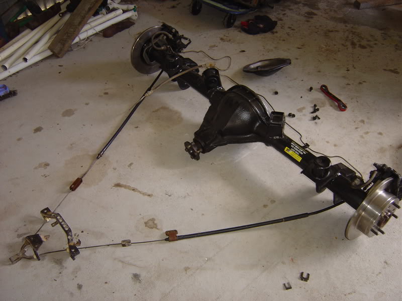

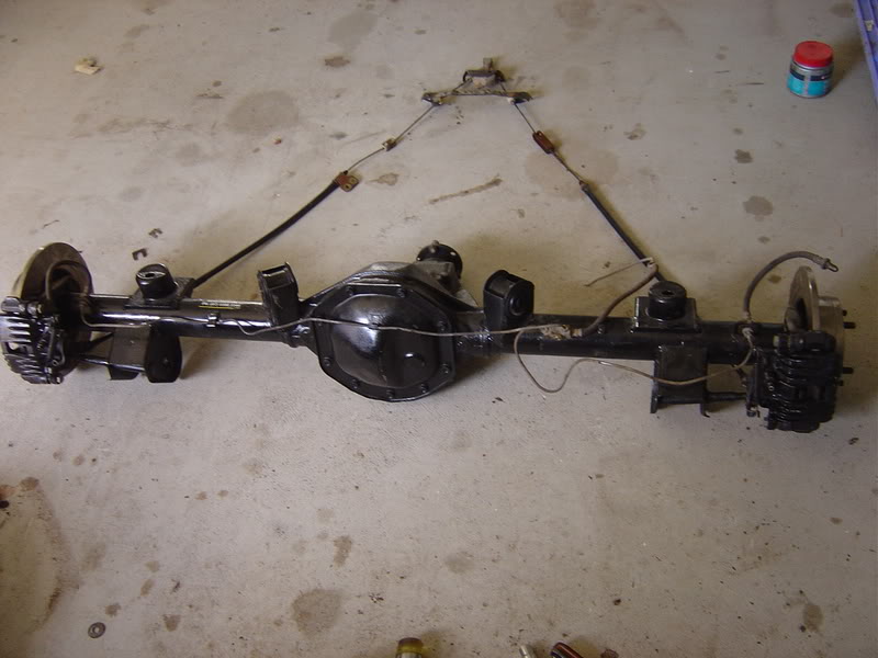

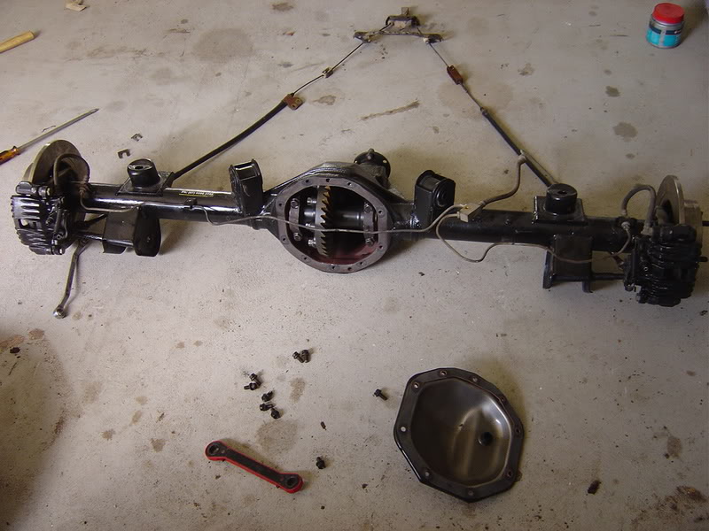

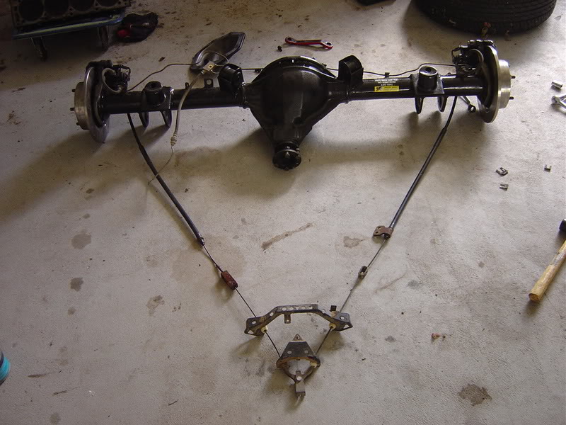

If you measure the distance from BUF to BUF, it won't be the same as the track.
Assorted BUF measurements:
LH - UC: 1435 mm
VK II & VL: 1526 mm
Most VN: 1546 mm
I didn't bother with the L34/A9X measurement, as it's fairly unlikely you'll find one.
Bolt up Face 1439mm disc to disc. I can live with that. We took 10mm off each side while it was apart. One of the tubes had a slight bend in it from a rear ender.So un touched it is 12mm wider on each side..1/2"..You could get away with that on a std Torana. You can see what I mean about the handbrake cable going into a single pull on the bracket..Just need to attach it to the UC handbrake bolted on the floor. See the Full Spool?.
Forgot to weight it before I put the brakes on. Just have to shorten some brake lines and get Datto to do the braded steel lines and the arse is finished!! WooHoo! :rockon: :spoton: :clap: :D
