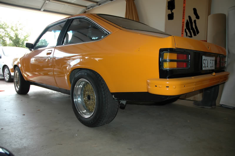

Heres My 15's
BY the way they measure up at 11 inch wide on the rear with 295 rubber and 7 inch wide on the front with 205 rubber. Bewarned you need A9X gaurds for tyres this big

Obviuosly not, you have L34 rear flares there......

Actually you do. As the tyres do not fit under the car. I have a set of A9X flares waiting to be painted up. the tyre stick out about 5mm and it looks stupid.

lol fair enough, it does look tight there. You will have to fill some holes up too if you fit A9X rear flares, compare the bolt holes to the ones on my car.
PS, Neils wheels right? Nice.

Yep they sure are Neale Wheels. I dont think they still make am i right or wrong.

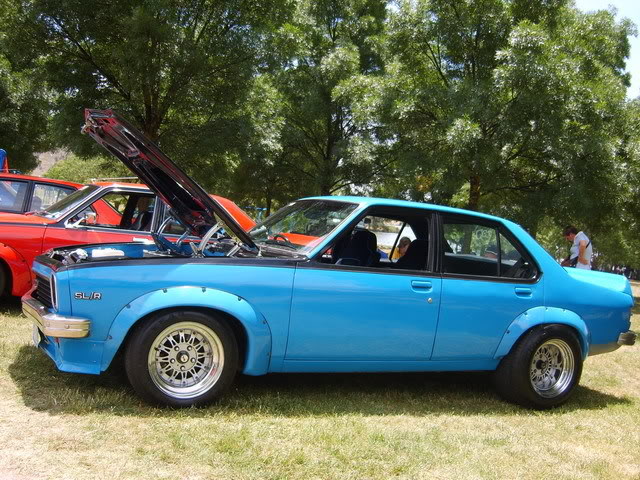

Arrimar has a set of the same neales wheels on his SLR, ive got a spare set of centres to suit too-slightly different design, Chris Neale has a wheel repair and modification shop 10mins from here

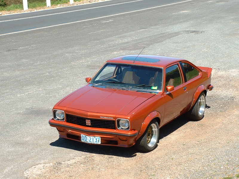

Here's a pic of the 15 x 8's with 225/60's and 15 x 7's with 205/60's on the SS.

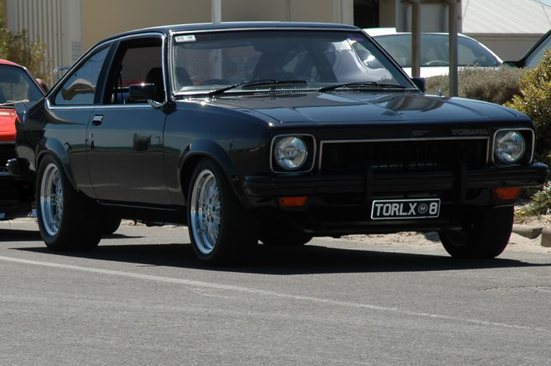

...And the 16 x 9's with 255/50's and 16 x 7's with 205/50's on the blue hatch.
If I had my time again I would go 15's coz wide rubber is a b1tch to find for 16's.

wat rims are those on the black hatch TORLX8? and wat pattern and offset are they?

TORLX8 i think i asked you before, so one more time for the dummies, what back spacing you running on the orange one thanx.

VK, the wheels on my BLUE hatch(often gets mistaken for black) are ROH Chicanes.
They are Torry stud pattern.
6 inch backspace on the rears & 5.5 inch on the fronts from memory.

ALX, SS has 5inch back space front and rear.

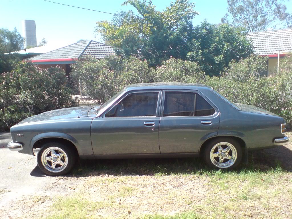

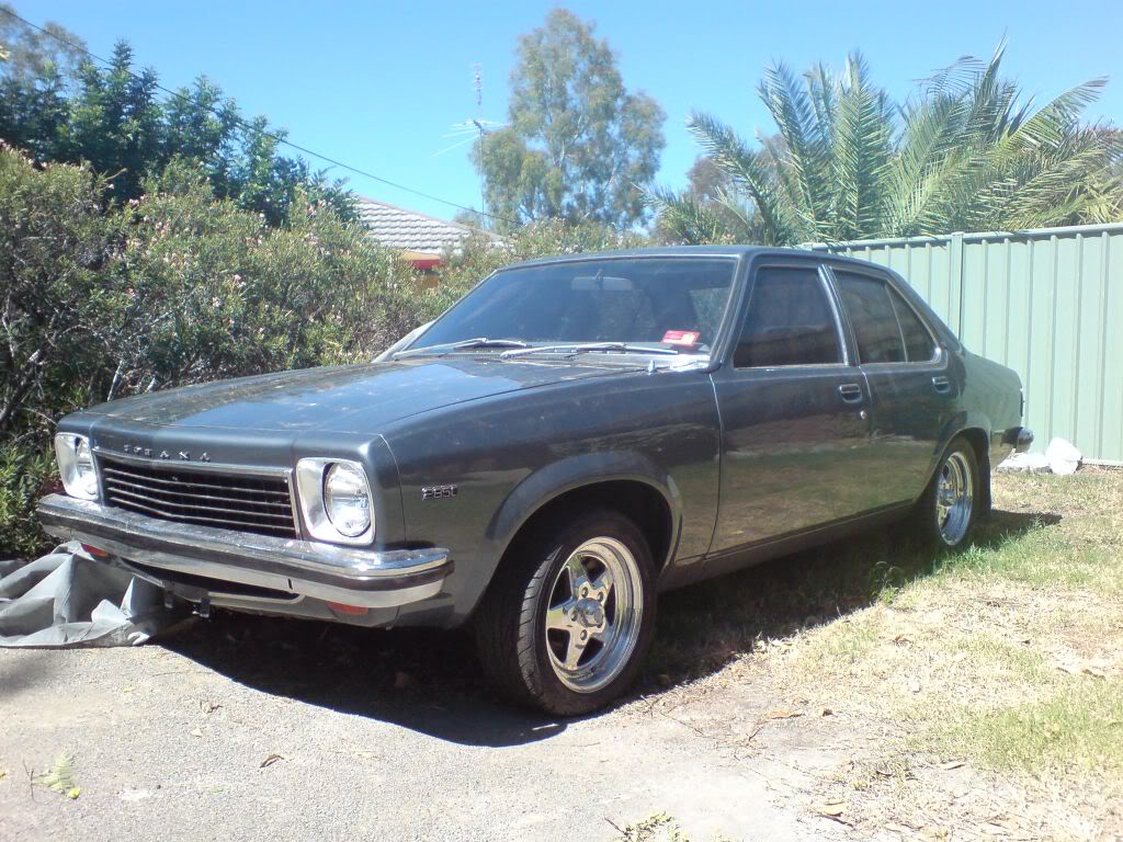

here is my LH with its new wheels just slapped on. they are 15x6 at the front and 15x7 on the bum, 195/50 and 225/50 respectively.
