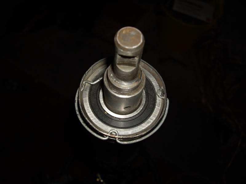

Posted 03 June 2007 - 11:09 PM
Hi,
I just finished mine using your method RODOMO with another mod.
I used a R16RS bearing which took only 5mins with coarse emery paper on shaft to fit make it but had to shim outsideof bearing in tube to make it atight fit.
I cut the useless section away.
Then cut the old nylon bearing bush in half and used it as the back support for new bearing by sliding it down the tube and screwed it in with 3 stainless steel screws from the outside.
Then cut new slots for the original wire clip to fasten bearing.
Some paint, all done.

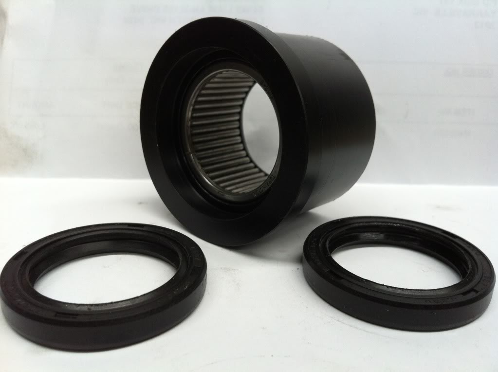

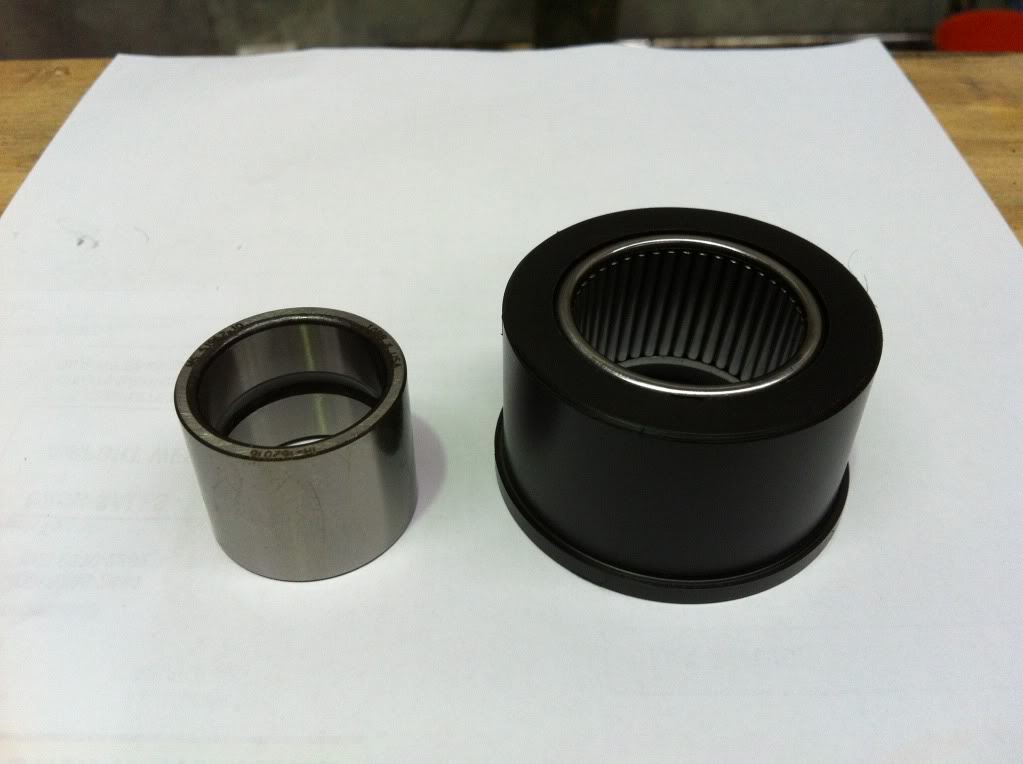

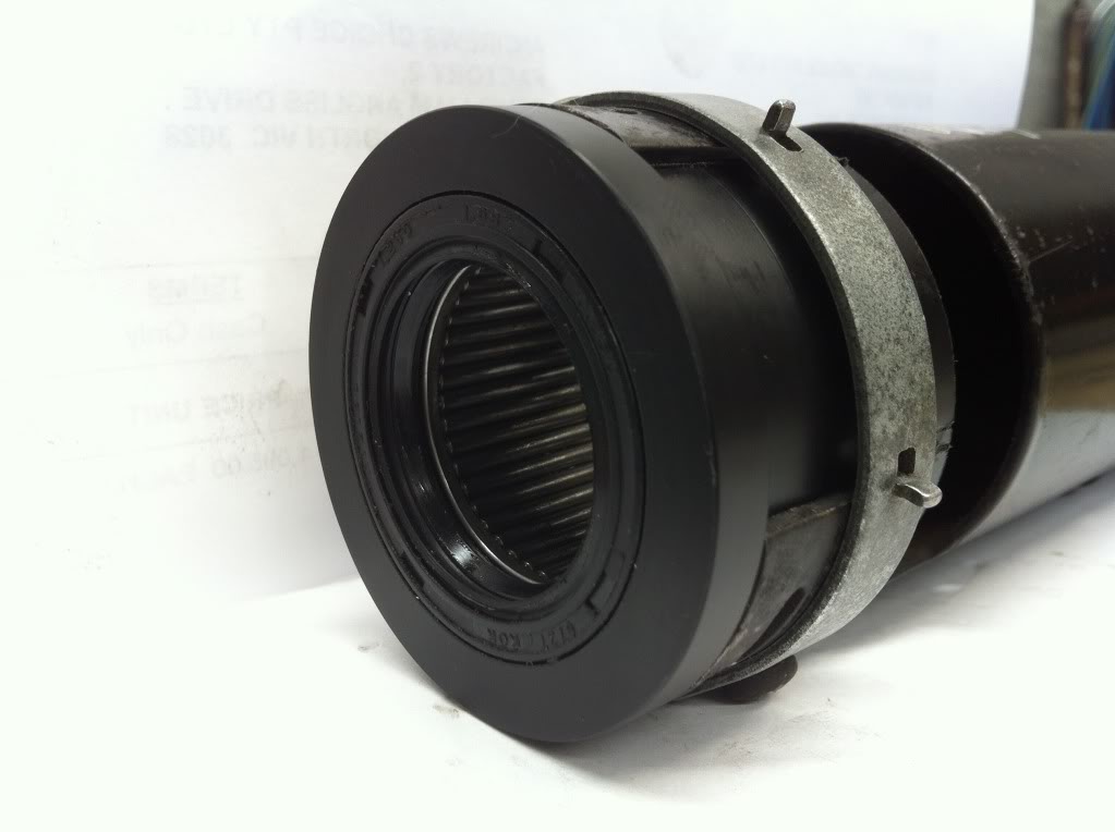

Just to open this bottom bearing thread again, i started looking at mine the other day and after 3 variations think i have a good solution.
1st was just a bush with good bearing quality material, nahhh to crappy!!
2nd was with a needle bearing, nahhh not sealed enough.
3rd is the needle bearing with seals either side and 2 inner rings so the seals work all the time and the shaft can move up and down and not cause drama.
I havent got the list of part numbers with me as i type this, will add them tomorrow.
The bearing is a Torrington imperial bearing and the seals are also imperial so havent touched the shaft.
1st time ive machined in imperial for years, was interesting on a metric lathe.
Its so handy to have a lathe available for this stuff :spoton:

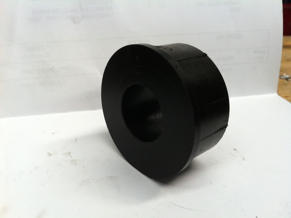

Posted 08 November 2011 - 08:17 PM
What sort of plastic is that you used? I like machining things like that out of plastics and alloy so always interrested in how they are done and what materials are used.

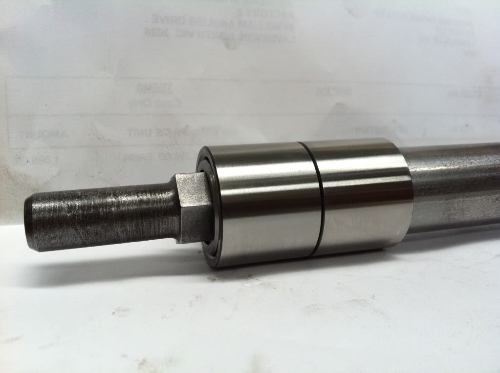

#48 LX2DR
LX2DR
  • 1,763 posts
  • Joined: 21-November 05

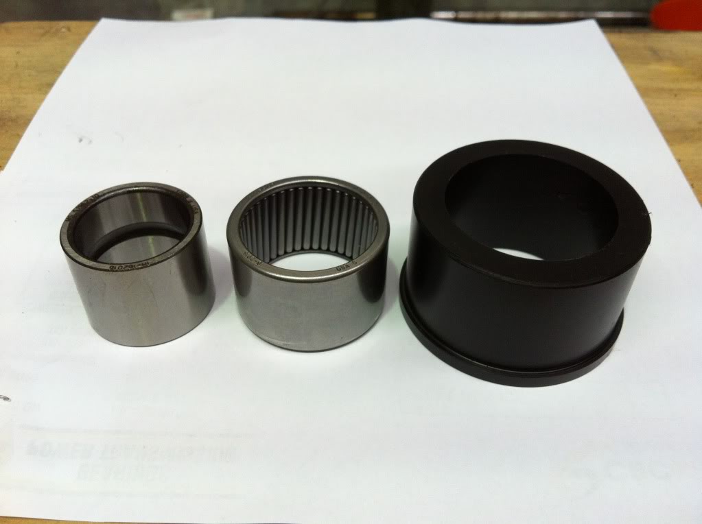

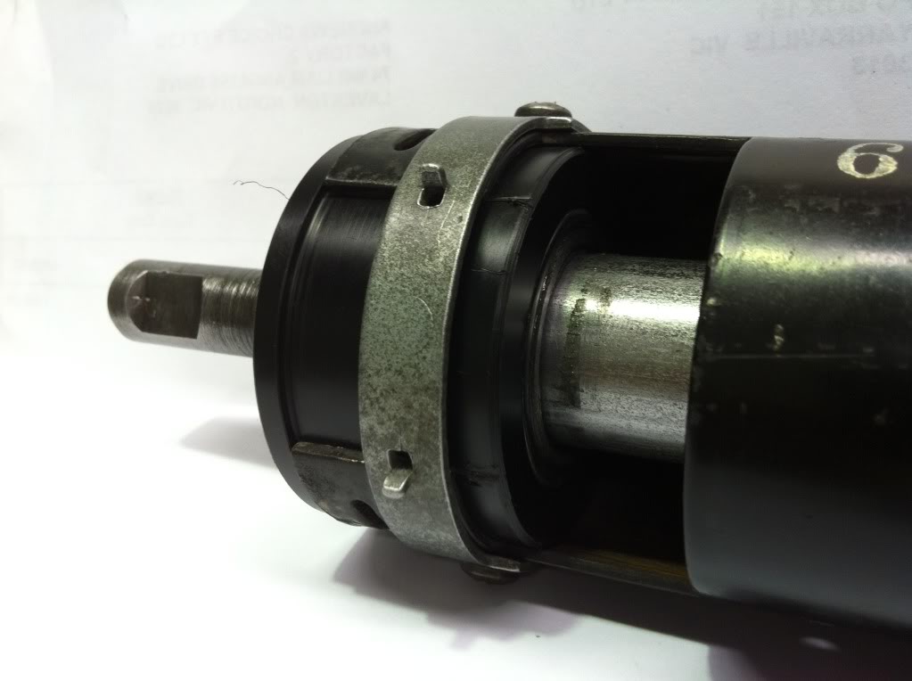

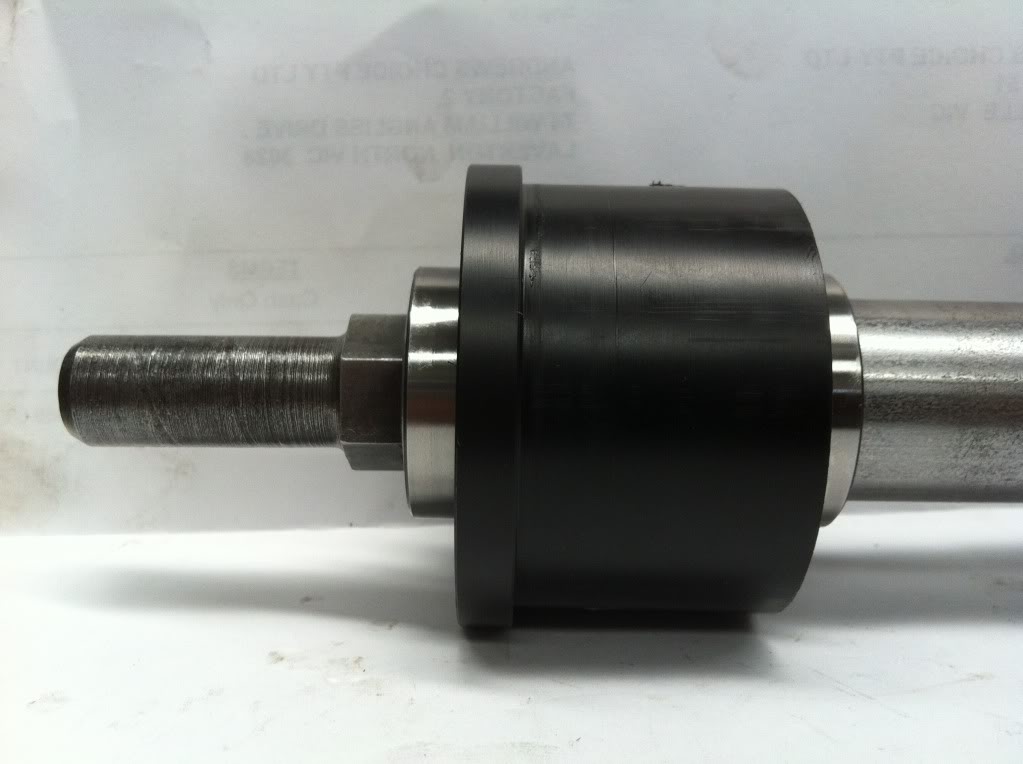

Posted 09 November 2011 - 09:30 PM
Finished and ready to be swapped in.
Bearing and seal numbers are:-
2 x TC12056 seal, 1.250" id x 1.687" od x 0.250" wide (1-1/4" x 1-11/16" x 1/4") ($6.00ea)
2 x P162016 Inner ring (1st one cost me $88.00, freaked!!, guy did me a favor on the 2nd, $30.00)
1 x S2016 Needle ring ($29.00)
Only problem is the area that the old bearing was, has worn down the shaft and the ring was loose, so had to locktite the end one in place.
Edited by LX2DR, 09 November 2011 - 09:31 PM.

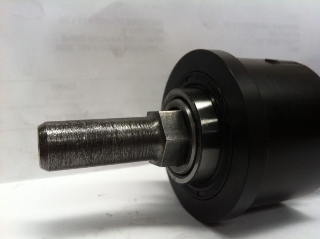

#49 LX2DR
LX2DR
  • 1,763 posts

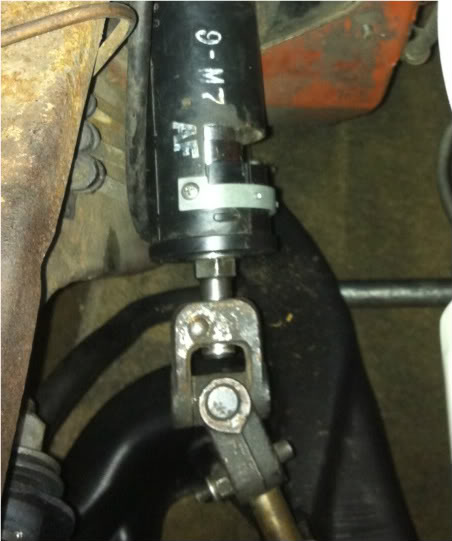

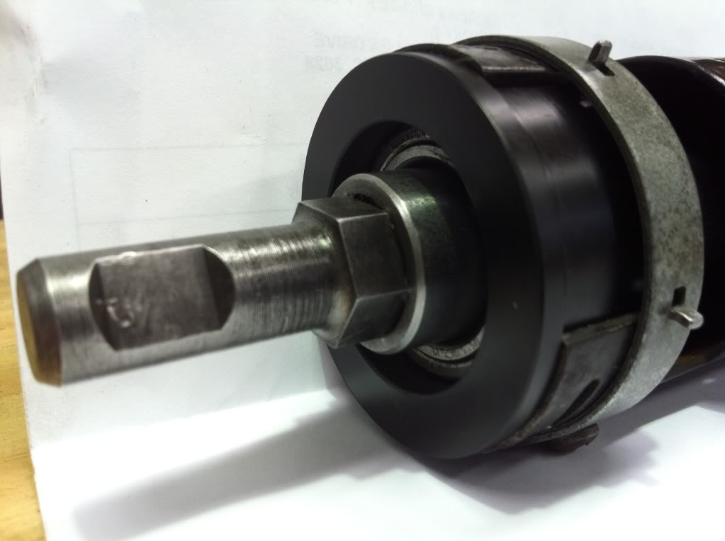

Posted 10 November 2011 - 10:05 PM
Installed
