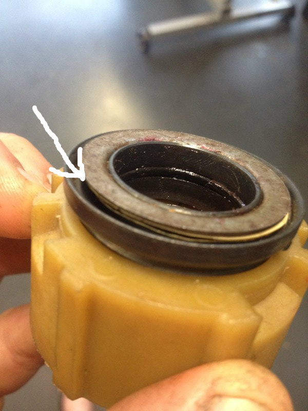

Where are the ball bearings actually located in the original bearing???

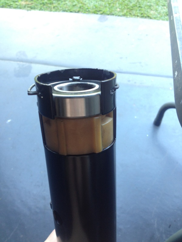

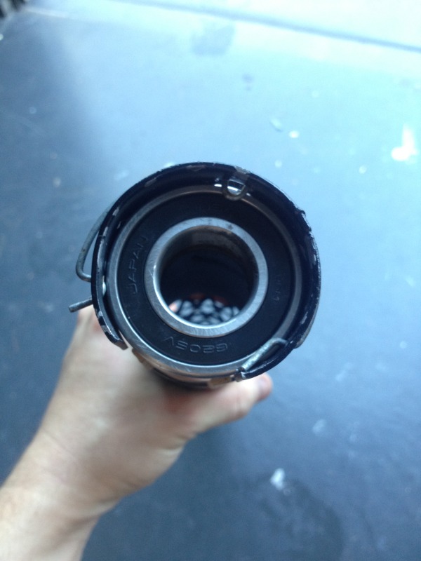

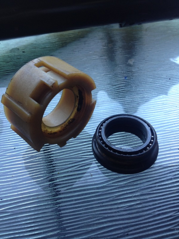

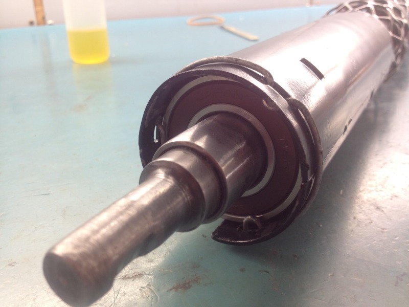

So I dunno if I'm doing something wrong here... But this took me all of 2mins..
I just popped the old bearing out of the plastic section of the lower bearing assy, slid it into place, then slipped the new real bearing into position and fitted the retaining clip. I "just" cant get one tag of the clip into place but I'll sort that.
I'm also going to source the better 6205-2RS-1 bearing. As the one I have has a rubber dust seal, does the other one have a metal seal?
Can anyone see why this wouldn't work what ive done? Seemed extremely simple... I know I'm simple but most things I do aren't simple.

Brad, it looks like the two ribs down the side of the plastic bearing holder need a tiny bit removed off them at the bottom to allow the holder to sit a little lower in the column tube. Then the wire retaining clip should slip into place.

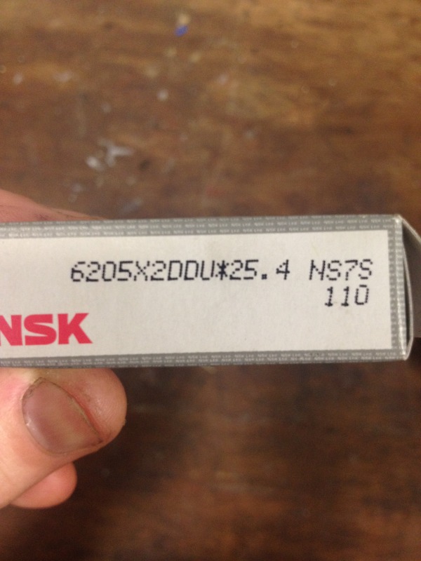

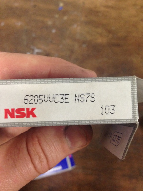

Bearing # 6205VVC4E NS7S
The ID is just a fraction to small for the shaft but I believe bearing # 6205-2RS-1 is a perfect fit. I am concerned about a rubber/plastic dust seal in an engine bay, a metal one would be perfect.

This is the bearing I ended up using :
This bearing needs the shaft skimmed down for it to have fitted.

Brad, do you know what the measure is from the face of the bearing to the end of the shaft? (from your pic above)

Thanks Brad the 25.4 works a treat.
Took about 30 minutes for me to do. The steering shafts are out for a power steering kit installation though.
My only issue was fitting the C clamp which holds the end of the open outer shaft tight. Used a stainless hose clamp instead.
Looks ok as you can hardly see it there nestled in there with the headers. Holds the bearing in nice and snug.
Wire clip snapped in place first .
