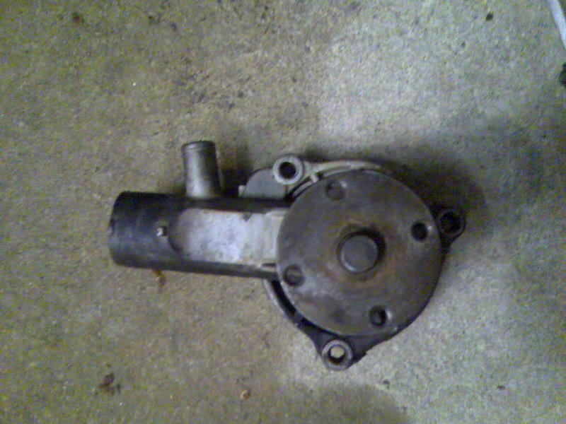

Gday all,
In my quest to fix my overheating problem, I am down to testing/checking the water pump.
I have removed the water pump, and it is stiff to turn turn, I assume the bearings are shot.
My question however has to do with the fan blades.

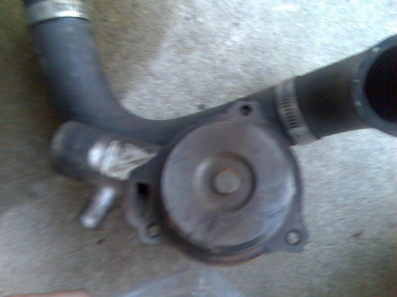

I removed this one from the Torana. As you can see the blades are inclosed. There are no stampings or markings anywhere on the waterpump that I can see. I believe this to be a geunine water pump.

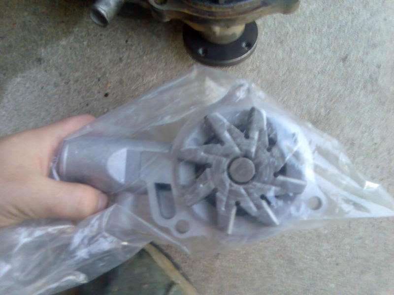

This one i just purchased. It has 'open' blades. In the past with one of these installed I had bad over heating problems (before the car was put on gas) and i believe the reason is the blades allow too much water to escape. It has 'HD1' 'GMB' and 'Japan' stamped on it with one of those date circles all located on the tube that connects to the lower radiator hose.
So can someone tell me which one of these (if either is) is the geunine one? And has anyone else has problems with aftermarket water pumps causing overheating?

#2 REDA9X
Posted 26 March 2007 - 06:40 PM
Throw the one you bought back and buy genuine. The top one is genuine, uses a cast impellor. You will find it much more efficient. I had the same drama, at higher revs it used to caviate. Make sure while you have it off the area behind the pump is not corroded away

#4 LXCHEV
Posted 26 March 2007 - 06:43 PM
You are spot-on Steve, we've just been going through this too with Deb's EH.
The first type of pump you showed has the cast iron impellor... this is the factory type, and what lots of engine builders swear by, and prefer to use.
The second pic is after-market (open blade design). A lot of people steer clear of these pumps.
Couple of things I've found out recently:
There was a lot of the aftermarket type getting around that were made in India/Taiwan etc... these are notorious for not providing adequate cooling, apparently they cavitate the water.
Some people I asked however, said there are some good ones (still the aftermarket open blade type), that work well..... look for ones that are made in Japan, apparently GMB is one such brand.

Ok, more info, sorry I forgot about this... when I spoke with Holden, they said in the past, they have always sold the genuine Holden cast-iron impellor type pumps, but recently, they've stopped making them, and are now providing the crappy type ones!!!!! What a shame! Don't hold me to this, but it could be correct that you can no longer get genuine cast iron Holden pumps....
The bloke at Holden even told me that engine builders used to always buy their Holden pumps, but now they've selling the new versions, they're not selling anywhere near as many now.... there must be another supplier.... (not Holden by the sounds of it)....

#23 _73LJWhiteSL_
_73LJWhiteSL_
Posted 27 March 2007 - 12:37 PM
All sorted.
I return to the Holden dealer, and after I said to them it was not the same as the one I removed from my engine (which i brought in as well) I said that it looked rather like the aftermarket pumps I was offered at autobarn. I also stated I wanted one the same as mine, as last time I had one that looked like the one they supplied I had over heating problems.
First he had a go at me for saying the pump supplied was non genuine, even through I did not DIRECTLY state it was not genuine, I simply said it looked closer to the aftermarket ones than my genuine one. Then he came out with this line...
"Its in a Genuine box, therefore its a genuine part."
Never mind the fact it has KGB or BGM or something like that and JAPAN stamped on the side. And the fact the box has a little GM sticker on it and the box isn't even the right size for the waterpump.
Then he refunded my money and took the pump back.
Then I headed out to Barry Bourke Holden in Berwick.
I showed the guy there my pump and told him my problems with the other dealer. He went out back and returned with a water pump. Upon inspection it was the same as my old one. So i was picked it up off him
The part number for the one i got from the other Holden dealer is 92008366, However the part number on this one was 92008365. It cost me $66 but well its better than the aftermarket ones.
