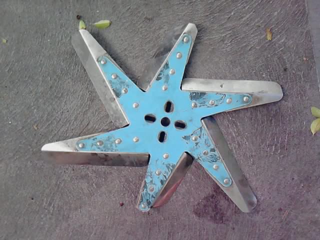

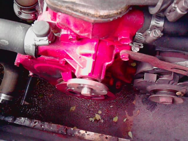

I went to change my fan from this one back to standard as it has two broken blades
And found the bit that locates the fan isn't long enough for the standard fan.
What I want to know is, is there different fan I can use, that isn't the flex type.
The standard fan I have was off an LX from memory.

Also, it's in an LC.

That looks like a later water pump with the bigger bearings. VC onwards.

In case you're wondering, my engine isn't pink either haha
Do I need a different water pump to put a normal fan on?
Or is there a standard non flex type fan that will fit it?

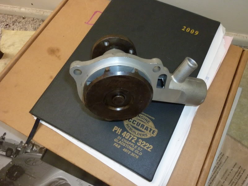

I pulled the water pump off my old HZ motor I had lying around, and it has a cast type impeller on it. The housing is pretty badly corroded though, but I'm wondering if I can remove the impeller and fit to my old pump, or a new pump myself? I know others have asked the question above, but no-one has responded... has anyone successfully done it? If so, what's involved, and how do you do it?

You can remove the cast impella by carefully drilling and tapping 2 holes at 180deg.into the cast impella
and use a purpose made puller to remove it.
Remove the steel impella from new pump then press the cast one onto the new pump.
Be sure to give about 10 thou clearance between impella blades and pump body.
