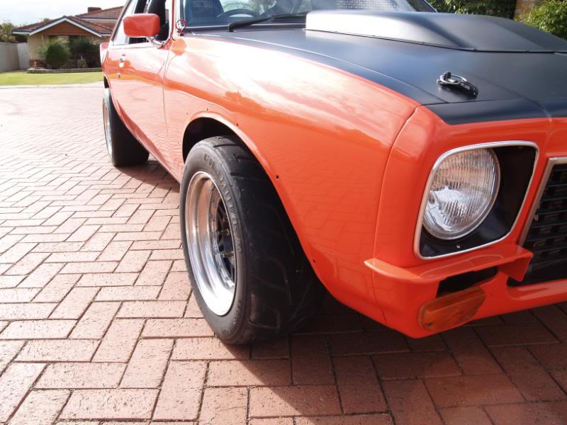

Picked up my new Michelin TB15 rears today, they are very soft in the sidewall compared to everything else i have.
Hi, keen to hear what you thought of the Michelin TB15's so far? I'm looking to get a set of the 295/40/15s onto 15/10 mags on the rear of a flared LH. Interested to hear how they go in general, wear and what they are like in the wet? :spoton:
thanks
#452 A9X
Posted 22 July 2008 - 01:30 AM
Very happy with them.
The soft sidewalls give them some flex, the tread sits quite square on the road.
They are quite sticky for good hook up cold and they are not too bad in the wet.
At this stage, a good allrounder, seem to be wearing well.
I'd buy another set.
I'll post a pic of them in the new Jongbloeds very soon ! :rockon:
Welby

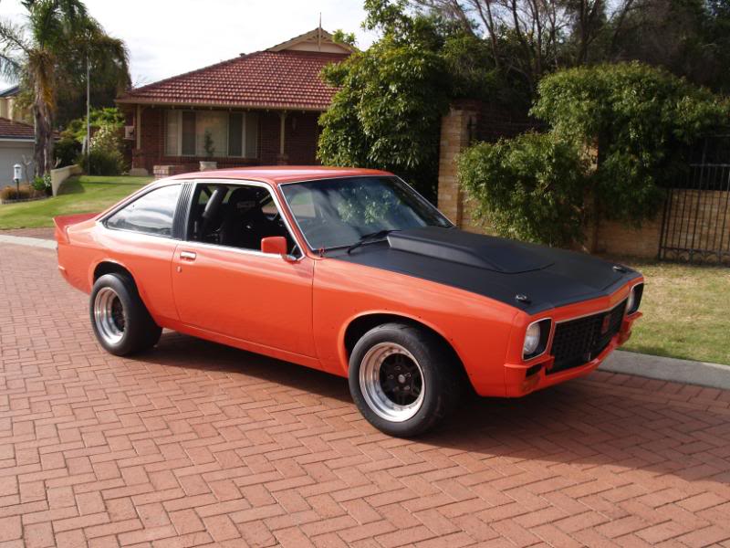

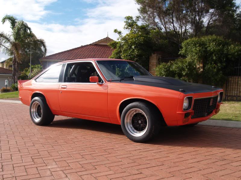

Posted 03 November 2008 - 08:51 PM
Just back from the paint shop after the having the stone chips and race grime cleaned off.
The rear flares were shot, stones had practically wore them out from the insides. Fronts were shot, same story but also had some cracks from bottoming the spoiler out on one special stage.
Spoiler was shot too, lots of little cracks and wear marks along the bottom lip.
while she is undressed, i will post some pics up on one of the many flare threads for those that are interested.
Welby
