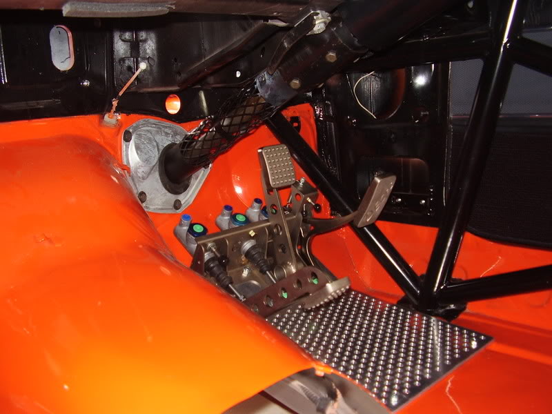

I hope to retain the mech clutch so I will not need to modify the firewall.
I was hoping to see how the trans/shifter mech comes up through the original floor pan hole.
Ben at Mal Wood said I would need to trim the back of the shifter hole. I wonder if this is to get better drive line alignment considering Welby had to shim his up.
I would love to crawl through an actual install.
#481 A9X
Posted 17 April 2009 - 09:02 PM
Hi Baron.
Don't appear to have pics of anything useful. Other than the box sitting on the floor.
Happy to happy snap anything that you might find useful, if i can.
Mark

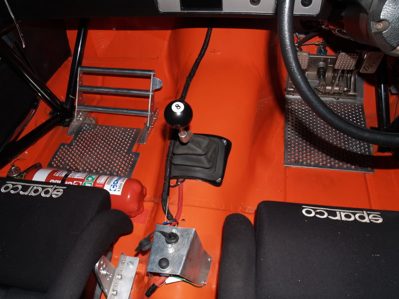

Posted 18 April 2009 - 10:32 AM

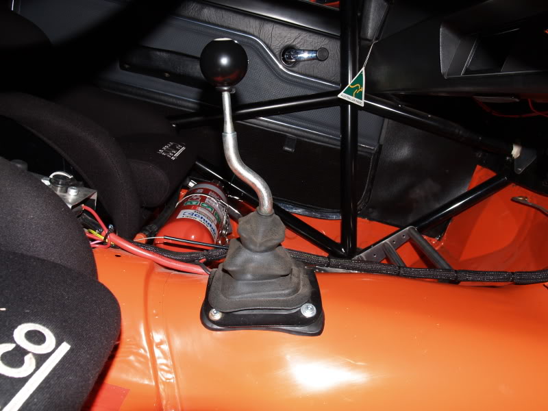

Thanks Welby.
The particular area I am interested in is around the shifter hole. A shot from inside the car with the shifter boot removed one day if you do any work there would be great.
Did you trim the shifter hole or massage the tunnel area?
Did you use the GM box or the fraud? (different input shaft lengths)
Do you live far from the Perth airport as I may do an over nighter before travelling on to or back from Newman so I can (with you permission) have a sticky beak.
#484 A9X
Posted 18 April 2009 - 07:25 PM
Hi mate.
Pics can be organised as you wish.
I have done no work to the shifter area at all, nor have i done any work to the entire car floor other than paint n pretty preperation.
As to Gm or other box, i can't tell you. Mal wood knew it was going behind a 308 into a Torry and supplied accordingly.
Is there a cast or part no that may help?
I will post the pic of the box on the floor for the hell of it.
Wait out.
I'm a fremantle fresident who works in northbridge.
If you were staying o'nite, we could arrange something, in know Dave wanted to say hello as well.

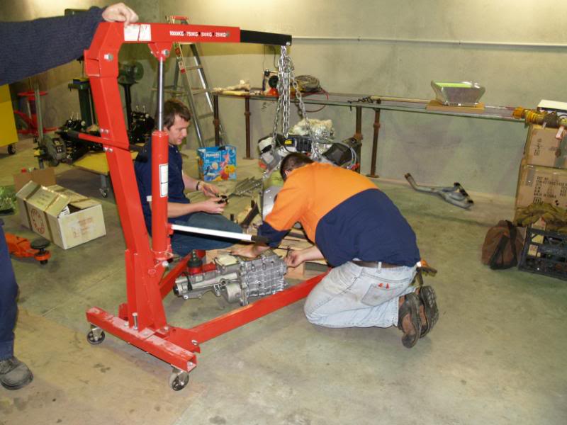

#485 A9X
Posted 18 April 2009 - 07:35 PM
an early build pic
Here is another early build pic
and finally, a pre build pic

Posted 18 April 2009 - 08:57 PM
You smoothy. :D
Here ya go Baron,
Taken tonight, i'm looking for the old pics as well.
#488 A9X

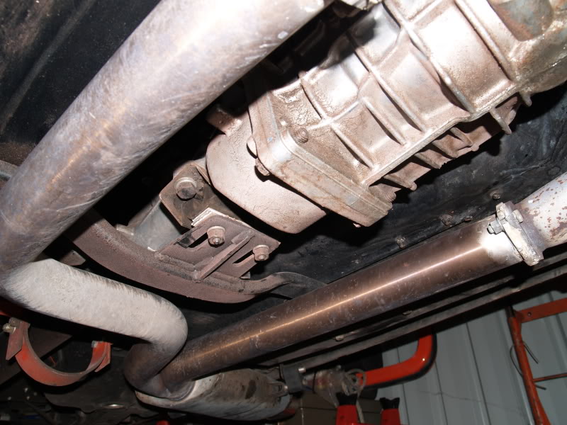

Posted 19 April 2009 - 04:01 PM
Here you go.
Some old pics.
Here is the underneath, spot the transmission shifter hole.
a better interior shot pre installation
and a couple of the box on the floor to help with ID.
#489 _The Baron_
_The Baron_
Posted 19 April 2009 - 11:14 PM
Thanks alot for the photos Welby, appreciated.
If you ever take off the shifter boot in the future, that photo would be the clincher for clearance for me.
I plan to put the black epic on a hoist next week for a poke around. I will try to get the measurement for the GB output shaft centreline to tunnel distance to check against yours. To see if it varies by much.

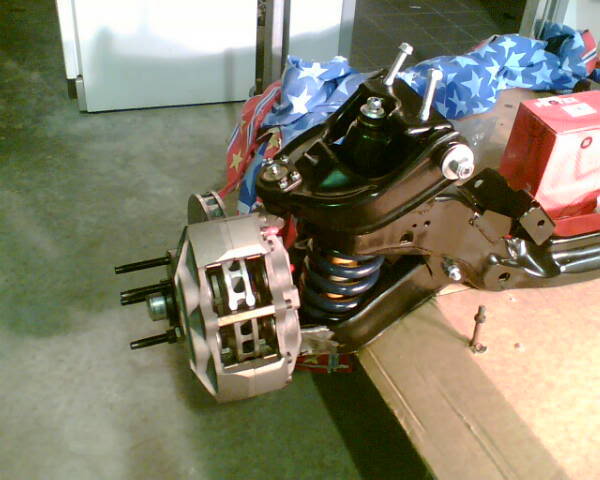

Posted 21 April 2009 - 01:43 PM
Mark

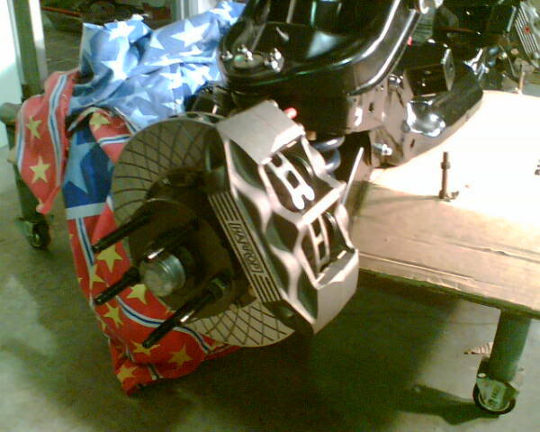

Harrop caliper to stub axle showing adapter plate if fitted would be much appreciated.
Thanks
#492 dattoman
Posted 21 April 2009 - 02:17 PM
Caliper has regular ears on it and bolts straight to the stub
They fitted these steel spacers to get the caliper centred over the disc as the screwed up and sent Commodore calipers first up
We had to send the whole brake package back and get a refit done as it was way off
I'm sure Welby has some pics though
#493 A9X
Posted 21 April 2009 - 10:09 PM
Hi Baron.
I'd be happy to take some pics, here are a couple that may not cover what you are after. I'll snap some over the next day or so.
If you are thinking of these, i'd be inclined to let Datto talk you around to a different choice.
Datto bolted all this together and was often heard to say that if he had got to me before i'd bought them, we would be using something else.
The quality of Harrop wasn't top notch ( and v pricey) and now that Ron has sold........ who knows.

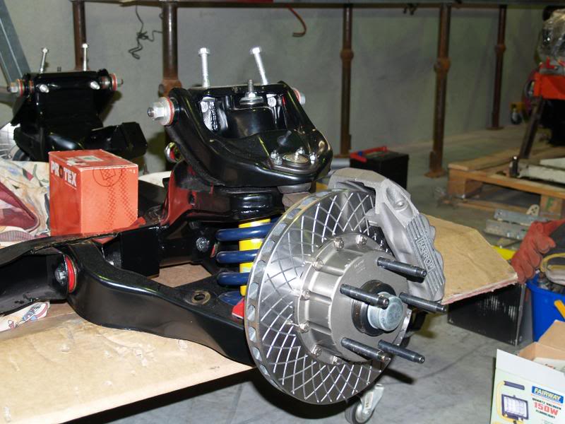

#494 _Barman_
_Barman_
Posted 22 April 2009 - 07:57 AM

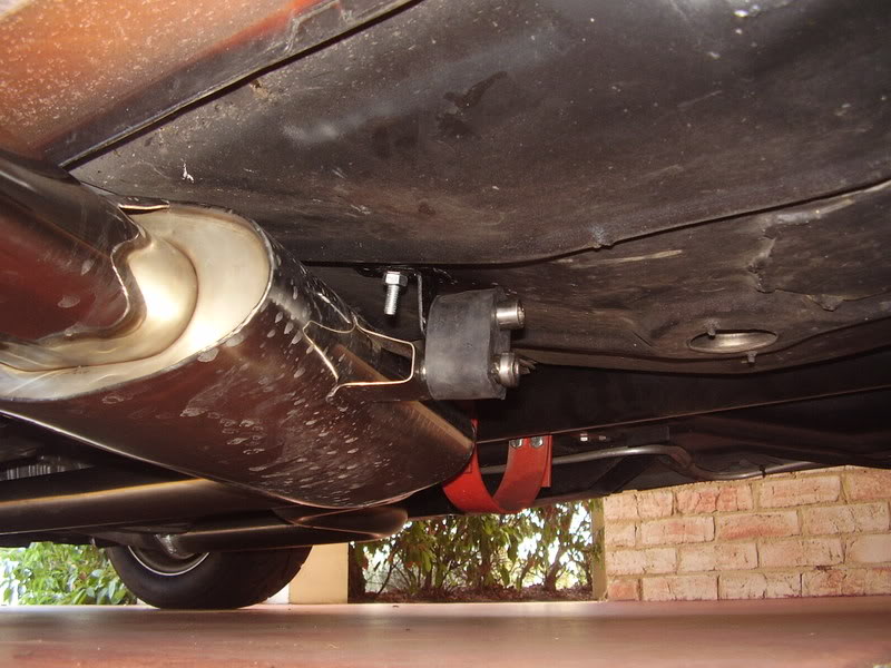

Very nice
1 question would that exhaust be legal for the street?
i need to replace my dump pipes (dust makers) and i do like the idea of side pipe.
Cheer Baz
#495 A9X
Posted 22 April 2009 - 10:56 AM
I don't think i could name all the different ways the car is not street legal.
Just the exhaust noise, location and the roll cage kill it for me.
The car was built for club sport and is set up that way. I enjoy driving it on odd days and don't cause any drama so its been so far so good.
Thanks for the comments though.

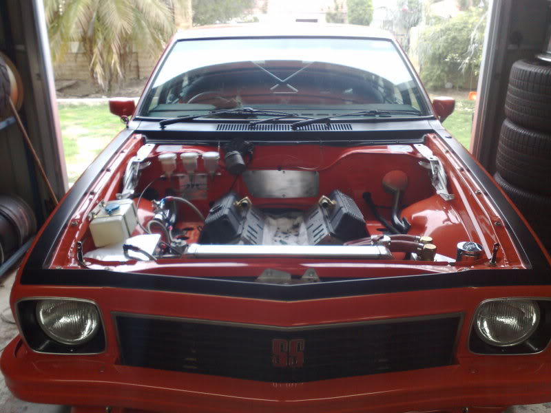

#497 A9X
Posted 25 April 2009 - 10:34 PM
Quick update on the old girl.
Ripped the rochester and manifold off.
And
now working on
#498 _The Baron_
