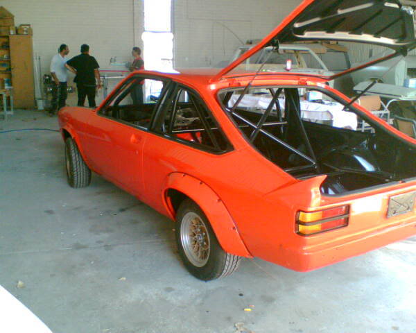

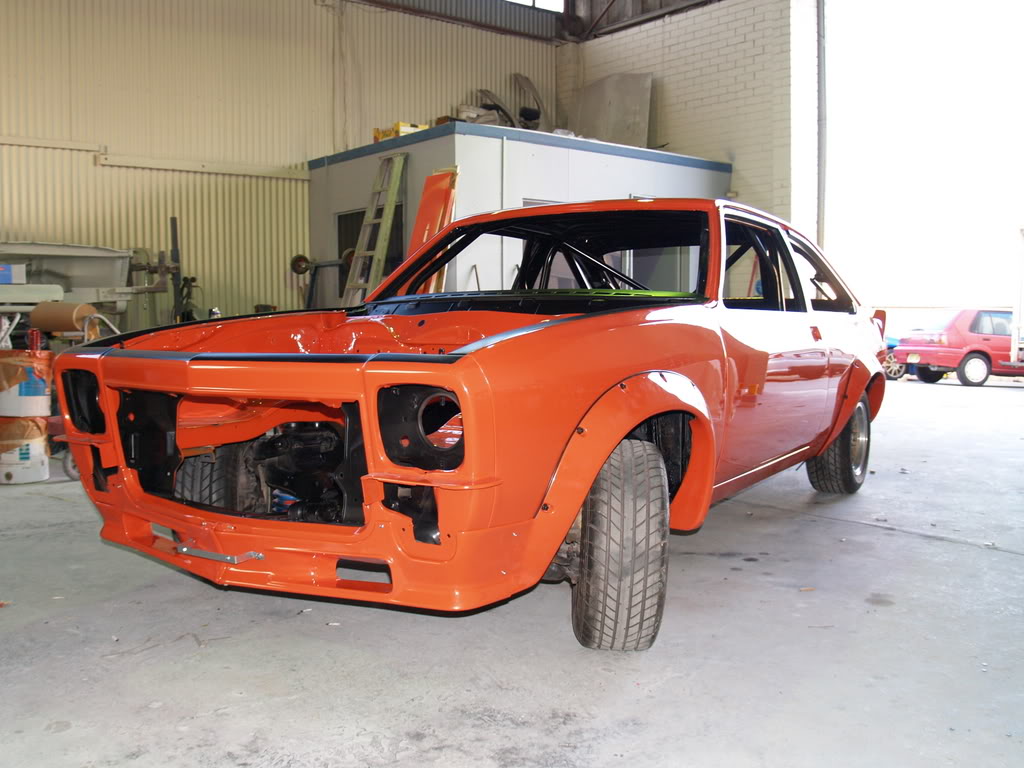

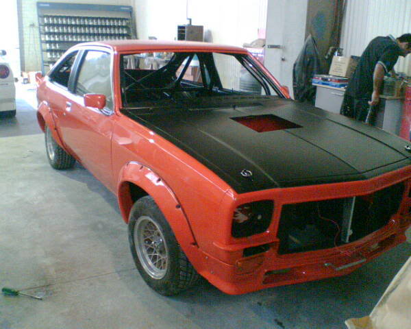

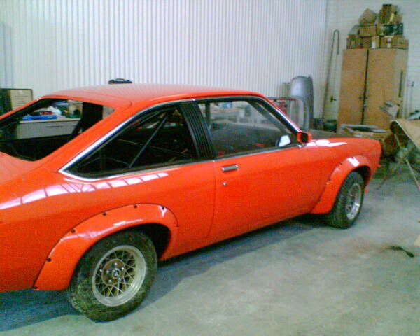

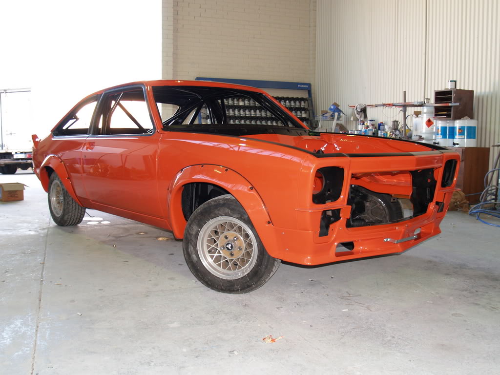

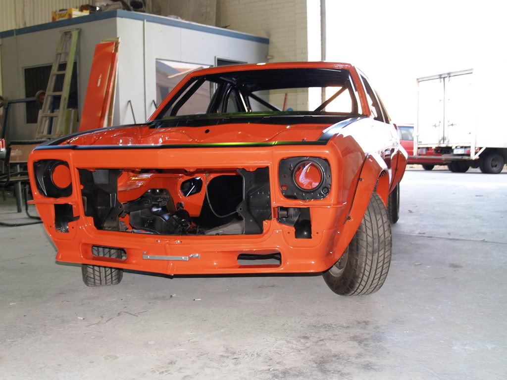

#138 A9X
Posted 13 June 2007 - 11:48 AM
Here's some updates
#139 A9X
Posted 13 June 2007 - 11:50 AM
These from a camera phone first thing this morning,
Sorry about the quality
