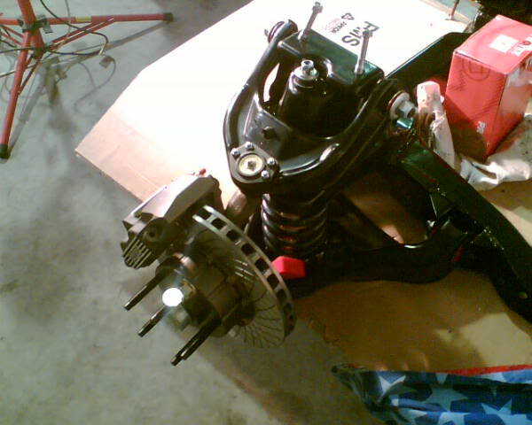

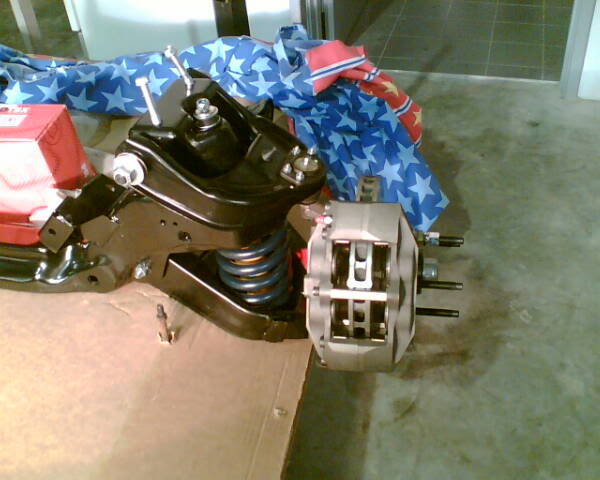

#190 A9X
Posted 22 June 2007 - 11:38 PM
Lets try this then Rana Girl.
The front end is pieced together now to include the upper & lower contol arms, the harrop steering arms and the harrop brakes (mk iv).
Coils are by Quadrant and the Shocks are Bilsteins valved to suit.
Sorry for the poor quality, phone camera .
Welby

Posted 23 June 2007 - 12:03 AM
Awesome set up.
What brand are your ball joints?
#192 355LX

#193 Bart
Bart
    Shit a brick
  • 2,559 posts
  • Car:LJ Torana
  • Joined: 20-November 05
Posted 23 June 2007 - 02:21 PM
Moog (Federal Mogul)
K5103
K5108
mate iv been trying to find those MOOG ball joints but couldnt find the correct Part#, the question is are they the same for LJ's?
I bought a pair of lowers from Rare Spares couple of years ago but they dont sell them any more, when i enquired about the uppers they said they dont sell those either in MOOG.
thanks for sharing the Part#'s :spoton:
nice project by the way :spoton:

#195 dattoman
Posted 23 June 2007 - 03:40 PM
They are the Moog numbers
They are the same for all Toranas and H series Holdens HR-WB
They looks and feel so much better than local ones.
The trick of course is...... where to ge them from
Oh...and they aint cheap
wink wink
#196 arrimar
arrimar
  • 3,134 posts
  • Location:brisbane
  • Joined: 13-January 06
Posted 23 June 2007 - 04:43 PM
will you be using an upper bump stop(the rectangular metal add on) on your set up?
#197 dattoman
Posted 23 June 2007 - 10:32 PM
We have the normal rubber upper stops inplace on the control arm
#198 arrimar
arrimar
  • 3,134 posts
  • Location:brisbane
Posted 24 June 2007 - 08:31 AM
i mean the one the bottom bump meets at the x-member.
like on a 34 or 9x
#199 slr5640
slr5640
    XA9X
  • 798 posts
  • Name:Brian
  • Location:Portland Vic
  • Joined: 17-November 05
Posted 24 June 2007 - 03:20 PM
These are the L34 and A9X bump stops he's referring to I think.
