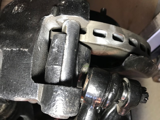

#253 ls2lxhatch
Posted 25 February 2021 - 12:51 PM
The tie rod end looks to be sitting a bit higher than normal in the steering arm, it could just be the split rubber boot or the angle that makes it look odd.
It may be worth trying a different tie rod end.

Posted 25 February 2021 - 06:55 PM
switched the slides left to right and right to left on the caliper fixed the clearance issue, somone must have pulled them of and reinstalled them around the wrong way ,
so pays to check things out ..
