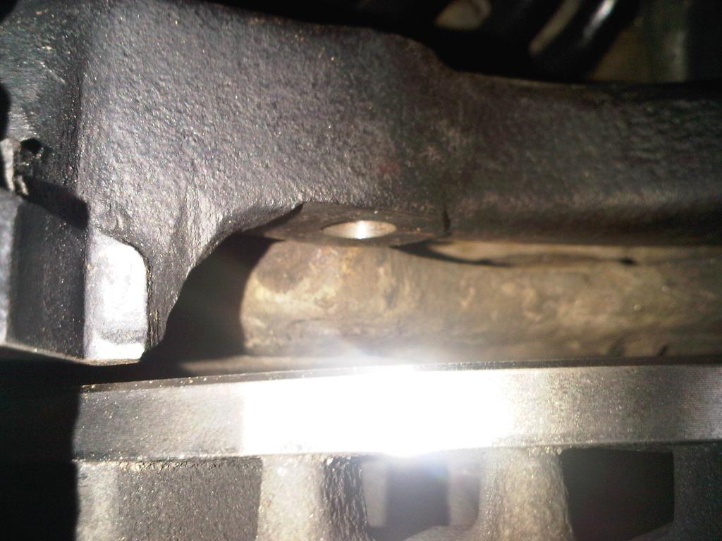

I got my rotors machined down and have taken some metal off of the caliper carrier as per the details in this thread but when I offer up the carrier it looks like I need to machine the face that bolts up to the stub axle. Its looks like I will have to take off about 2mm or so to get this to fit over the rotor.
I will post up a few pics later tonight but has anyone else had this issue and needed to do this maching or am I doing something wrong?
this is the face I think I need to machine
these pics arent much help but someone may have an idea by looking at them
Looks like I will have to throw this lot away. I was hoping someone could give me some advise before I spend more money machining parts.
There must be someone that can give me some advise

If you look up to the top post on this page you will see I have mentioned some have an issue with this exact problem.
As you say, taking a couple of mm off the bolt-up face should cure the problem.

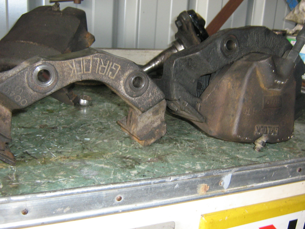

This is HZ (but should be the same aside from imperial vs metric fitting) and fits up fine:
I wonder if this difference with the stubs also causes a slight difference in offset?:
One is HZ and one is Torana but the concept applies equally to different HQ-WB and LH-UC Torana models. The one on the right is a bit dirty but you can see the area where the caliper mounts is not completely machined like the one on the left (because some caliper brackets don't need the whole area machined).
Is it possible that the different stubs which are set up for different calipers also have a bit of offset difference...? The pic above with the HZ caliper is on an HZ stub same as the one at left; if I'm looking in the right spot yours looks more like it has the mounting face with less machining like the right one?

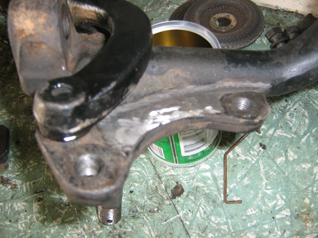

I didnt think about the option of machining the mounting bracket rather than the carrier.
Is it wise to do it with a grinder as opposed to sending it to a machine shop. It only seems to need about 2mm or so off to get it to fit

Im not sure if this is what you mean but yes, you will have to grind a fair bit off... especially if you are useing torana stubs....
You will have to grind where the calliper bolts to the stub, the bit between the bolts (top pic), and you may need to grind the top face of the calliper mount so they match the bolt positions on the stub (bottom pic)...

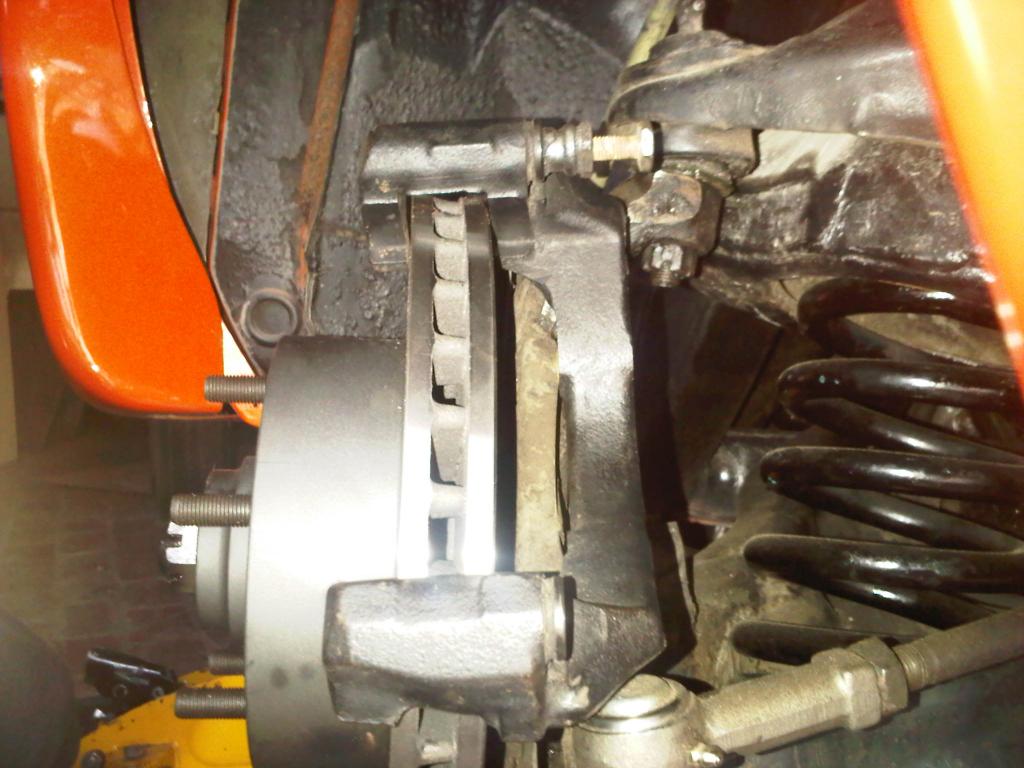

I have installed the HQ discs and had them machined down the 6mm outside , but after grinding the calipers down to within a inch of there life, still cant get them to fit. (there hx girlock calipers).
Is there any way of getting the standard torana calipers to fit until I can sort out whats going wrong. Thinking maybe I will find some HQ pbr calipers.

Pretty sure, to get it all lined up, with Torana stubs, you need the torana calliper inner (the part that bolts to the stub, retrofitted to the similar PBS holden calliper outer (the sliding part).
