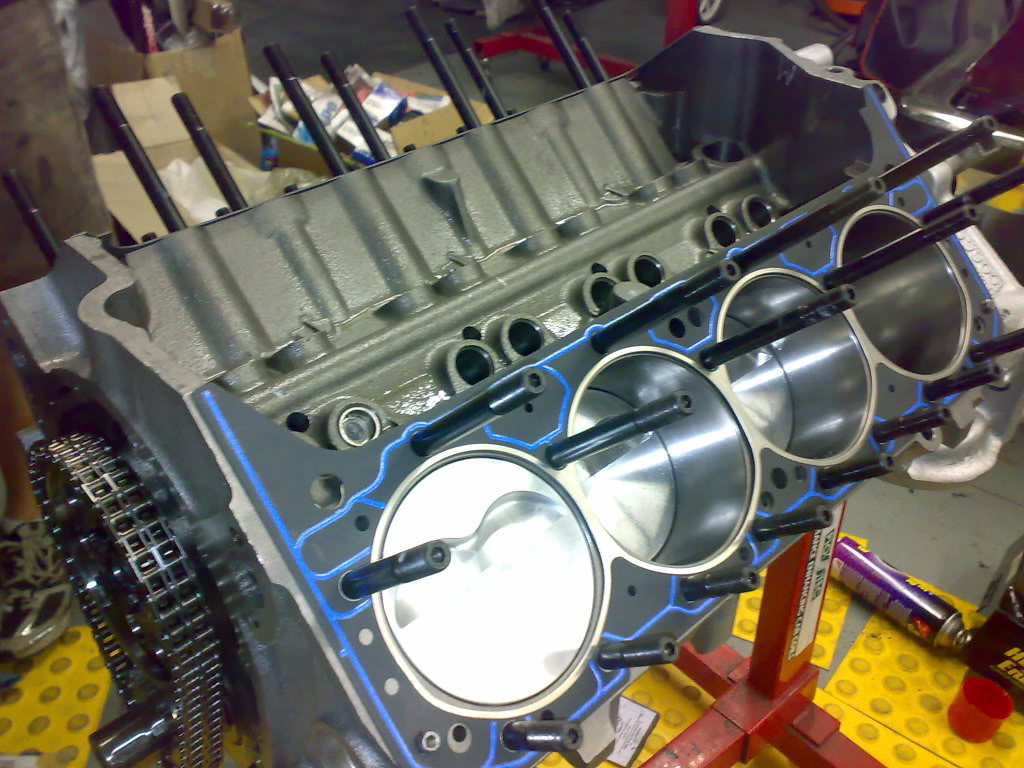

Okay, brabham badges are back on, the block I got back and..... found that even when I clearanced the inner walls of the cylinders for the stroker crank, it wouldn't fit. I found that I had to take far too much off of one side. This I assume is due to too much core shift in the block.
SO.....
I purchased a new GM crate block, sent it to get bored yesterday and will get it back tomorrow for bottom end assembly. The block will then go back along with the internalls to be balanced and blue printed, and I will then file fit the rings and start final assembly.

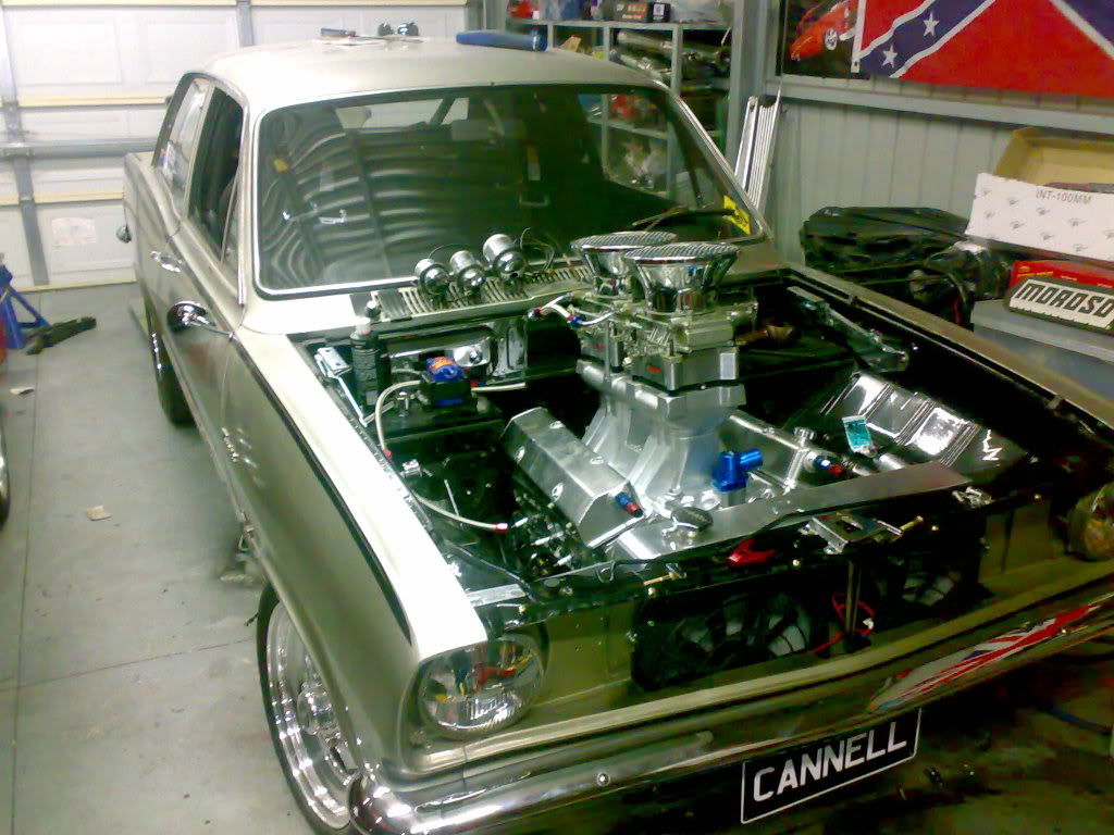

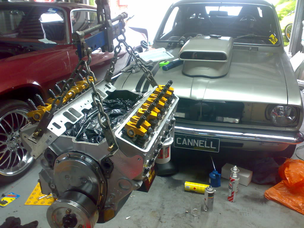

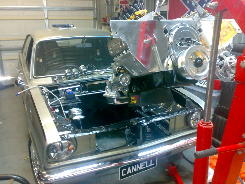

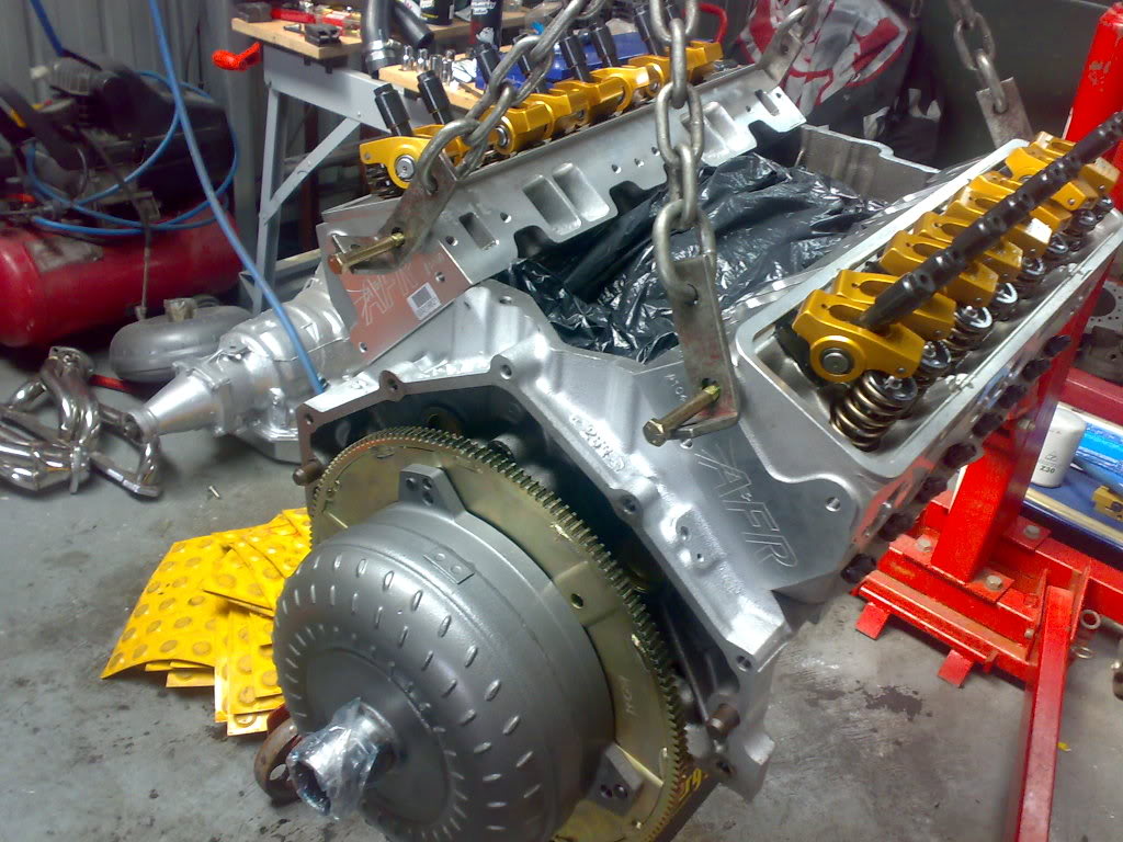

Hi guys, welast month I have been really busy. I have built the motor, had the trans built, modified the location of the diff, got bits and pieces and yes, as usual, have no money at the moment. I am having my tailshaft made this week. I still need fuel lines, my wiring done and brake lines, then I will be laughing. Hope you guys like the pics;
Bottom end built, all forged 10.5 compression
All done, now for the trans
4200rpm stall
Going in!
All fits well, except had to modify the steering again and get a rocker cover modified...
Wheelie bars located in place
