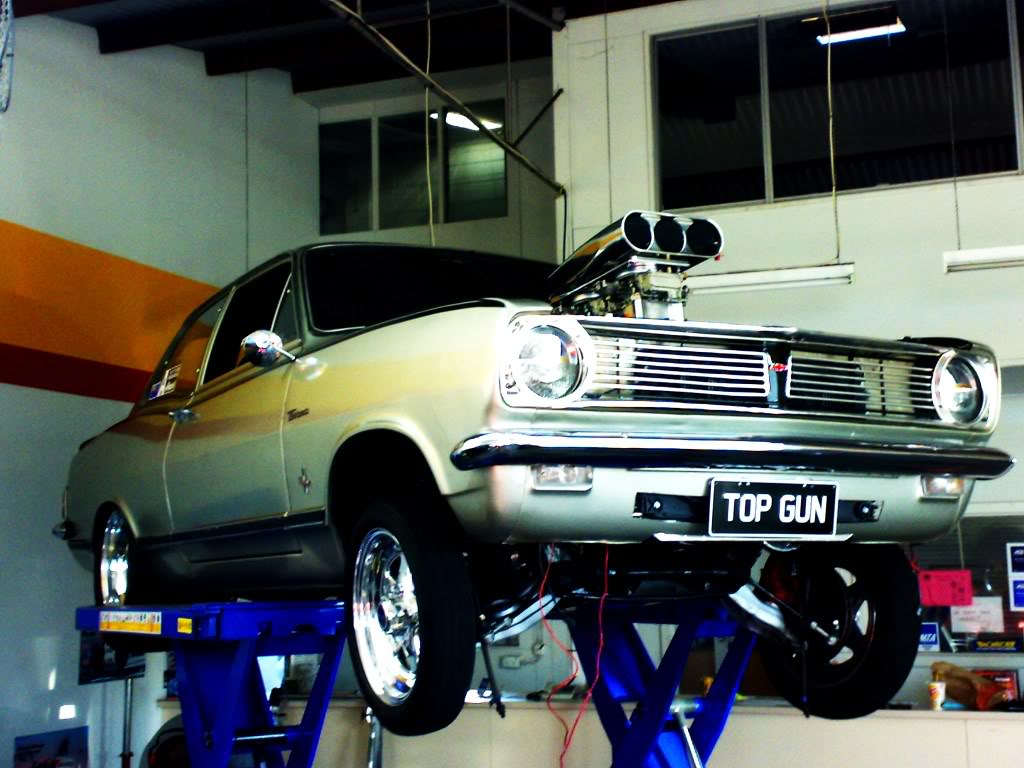

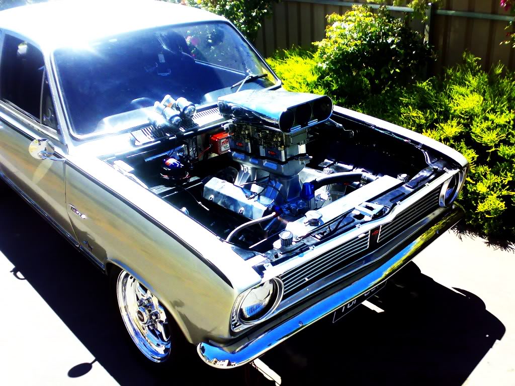

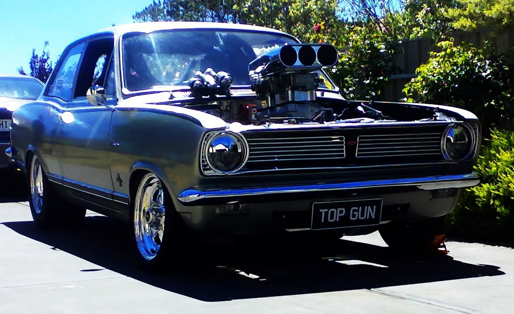

Okay for you who haven't seen it, its coming along pretty well. I ran the 1/2 inch brake line, mounted the transcooler underneath the car with a fan to keep it really cool during comps. I linked all the nitrous up. Linked all the fuel fittings and line from cell, to fuel pump, to filter, to surge tank, to big fuel pump, to regulator, to carbies! I installed 90/10 shocks and coils, notched the backend more to get it lower, ran battery cable, and am still doing the wiring (very painful).
It is now at my ole mans work on his hoist so I could do all of the tedious stuff and will be at ABS on tuesday. I should have the wiring finished by next weekend and ready for 3inch straight through on the following tuesday.
Heres some recent pics guys, catcha!

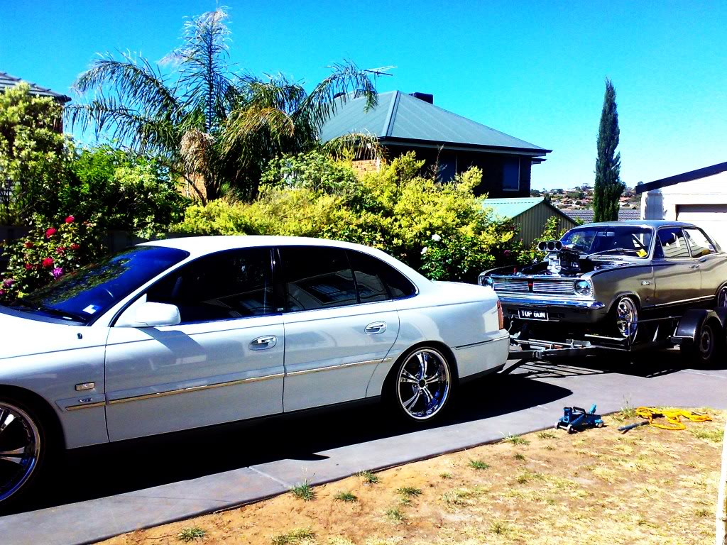

Right after getting a 2.5 Ton tow bar fitted!
My favourite shot!
Yep, it looks tiny compared to that 383 motor.
Front has been raised 2.5 inches so it doesn't scrape anymore
Getting excited, now it's worn off tho as I'm soooo tired... :ZZZ:
After 30 hours straight getting everything fitted.. :ZZZ:

That is awesome dude, keep up the good work cant wait to see this thing do a skid :)

wow, thats insane. The front with the reflective headlight lenses looks unreal.

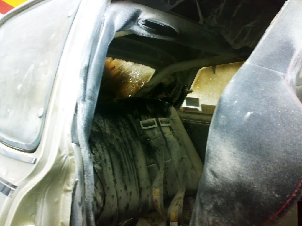

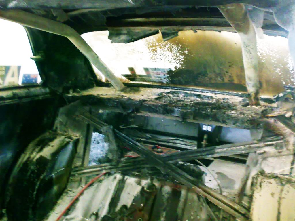

OKay bad news. If you don't want to see about 4K in damage look away now...
Cause: Tack welded a brake line bracket underneath the car, it then caught fire to the back seat. The car sat their stuck up 10 feet on the hoist whilst the compressor that ran the hoist shat it self. After 30 seconds I got it down and this was the end result! :cry:
