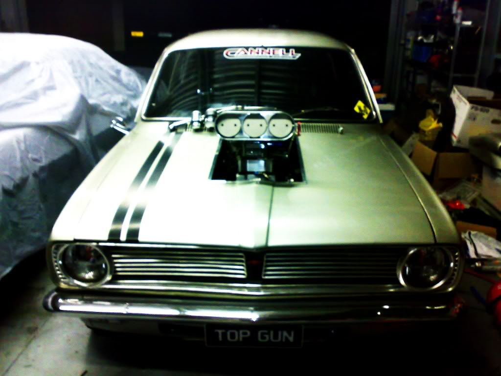

Cheers guys. finished putting the interior in today and had a mate cut and polish the crappy paint job on it, but it came out a hell of a lot better. Also cut and edged the bonnet hole and put the harnesses back in. Merry Christmas! Will keep you posted in the next couple of days. Until then, this is what it looks like now...

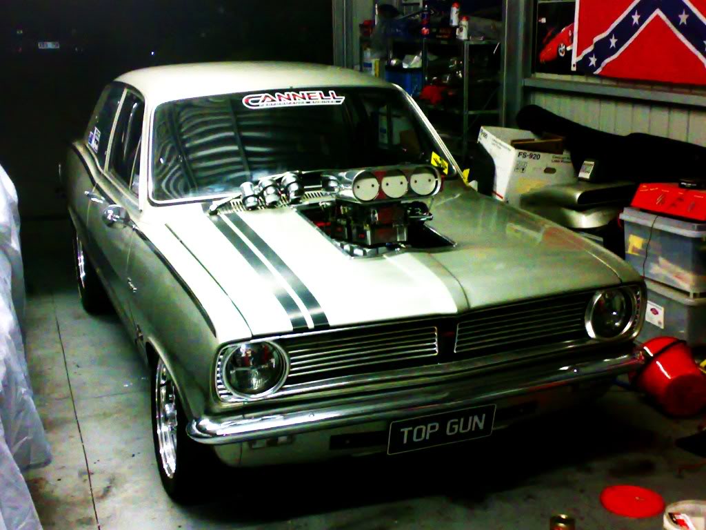

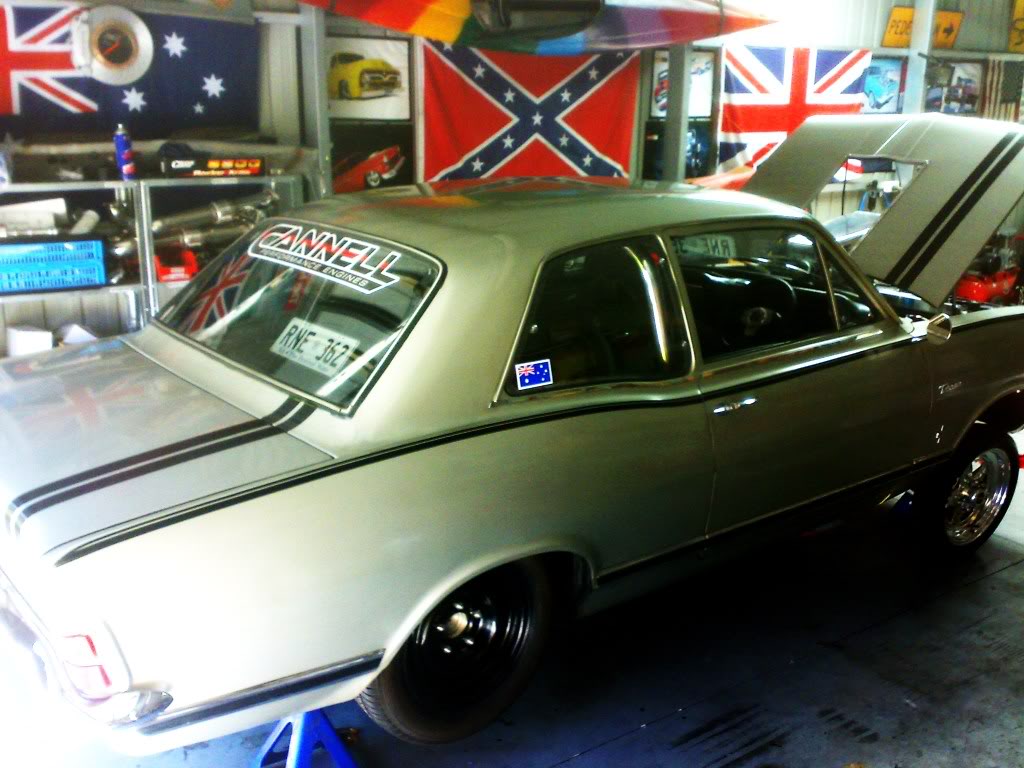

Well, hope you all had a great Christmas. I only have to; link up the rear handbrake, put bigger springs in the front, and tighten a few things. I am putting it on the dyno for a couple of hours on Monday ready for summernats. I have since had bolt-on spacers made for the peelin wheels as factory HQ rims foul on the inner chassis as the diff is really short. So after that I had bob jane at Marion fit some yoko tyres for $20.00 to it. This is what it looks like now...

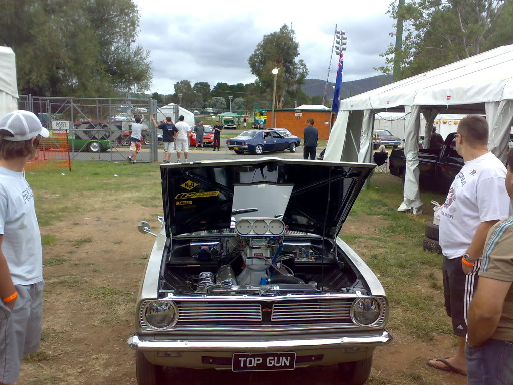

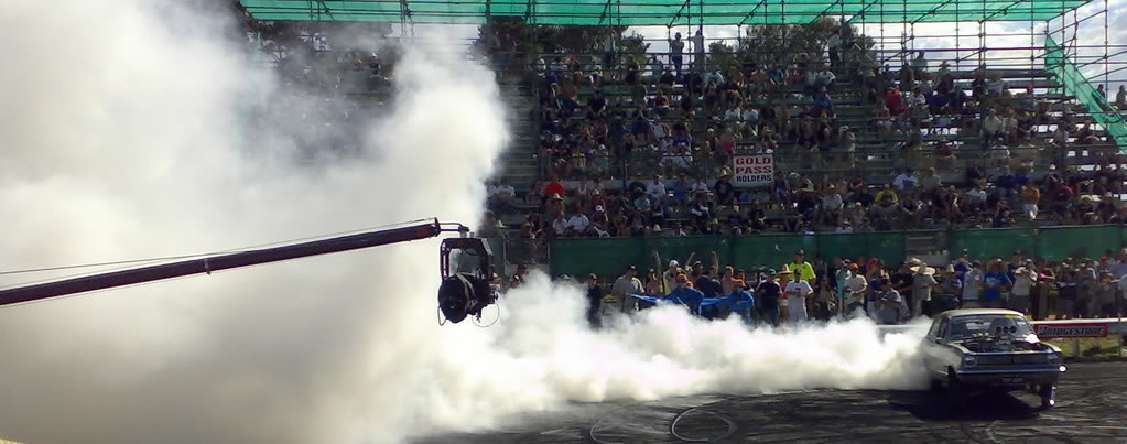

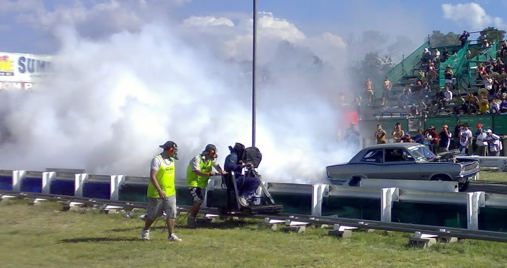

Had a great time at Nats. Caught up with a fair few of you over there. I made it to the finals, but of course didn't win as it was the first time I had driven the car, or given it shit. Blew my tires in qualifying and had to buy new ones in the Championships which I then blew. I put a 7000rpm rev chip in the msd so I was on limits in 3rd gear most of the time. I Will be there next year, only better things to come. I will load pics and video shortly... :spoton:
