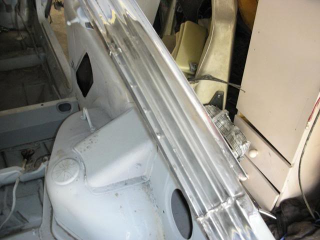

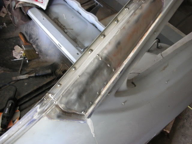

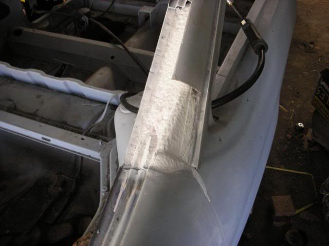

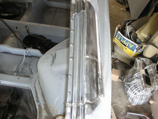

Heres a few picks of how mine turned out :D
Rust killed and etch primed
Tacked in
Welded in
After a little grinding
Still got some grinding to do I'll post some more pics when its done :D
cheers, Dan

In your pics, whats the trick in getting the "seam line" (or join line) in as per original ?

No trick really, just Take your time making your repair panels so they will fit together nicely with a 1/2mm gap around them. My shed just flooded again last night so I'll have to deal with that before I get back into mine

My seam line is currently missing under a load of bog !
I can now see why the dremel grinder is needed.

Dan, looking at your pics, did you drill the spot welds out from the original channel section ?
Also I take it you drilled holes in the new channel section to mig weld in ? :D

Yes and yes :D

Dan, looks a very good fit. Damn good welding too (he says jealously).
