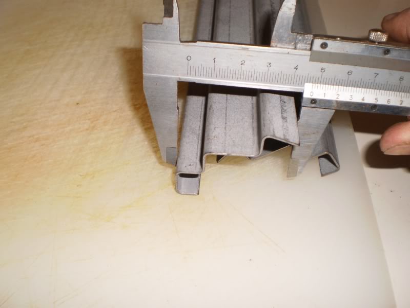

If Datto can locate and measure his I don’t mind making them
Did you get the measurements from Datto?
I bought a set of these a few years back and they are stll in the shed. They might be flying to Adelaide this year sometme to become part of a mate's hatch though but I can measure them up.
Matt

If you still have them Toranamat, I wouldnt mind catching up and making them, all I need is the profile.

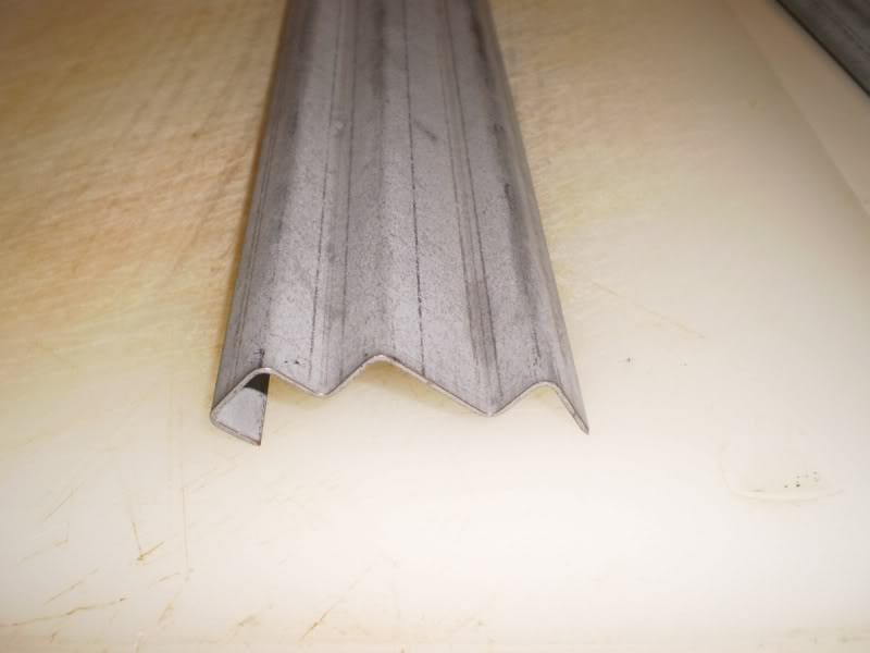

Print the pictures and take them to any sheet metal / fabrication workshop they will be able to make some up for you.

Correct me if i am wrong which is more than likely but are the c pillar inners not entirely straight?I thought they have a slight inwards curve as they sweep up towards the roof? I was thinking of making mine in 2-3 pieces (as in long ways up the folds) so i could bend them slightly then weld them together from behind before fitting them?this is also due to the fact i dont have access to a fandangle small folder. Any opinions or advise would b great. Thanks guys

They do curve slightly, you should be able to use one piece ones though. I did it. You just need to gradually tack weld them as you work from bottom to top. A couple of good c-clamps helps.
