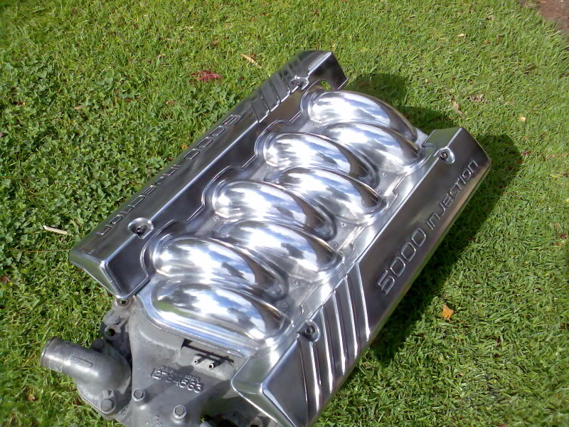

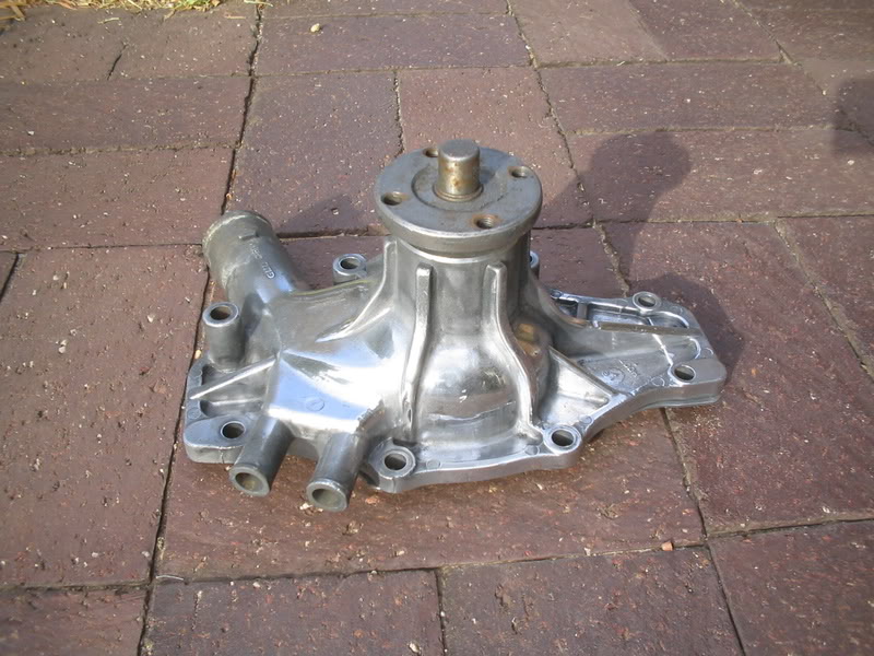

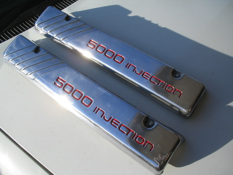

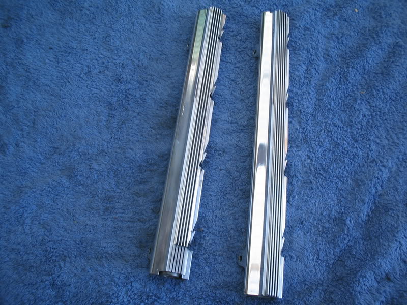

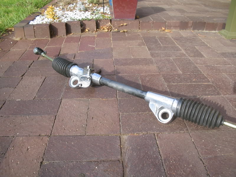

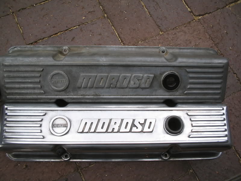

Posted 28 February 2008 - 07:08 PM
Hey guys, Heres just a few pics as promised,Thers plenty more but i dont wanna hog the thread
These are just some of the parts that ive done recently, Most of it belongs to me,
I dont do alot of cash work because no matter how hard you try, You can never please the person paying, But thats life hey!
i will keep you posted with my new COME Racing manifold, thats half way there, :rockon:
Marc

Posted 28 February 2008 - 08:57 PM
I was wondering if anyone thought to do the steering rack, looks good! :spoton:

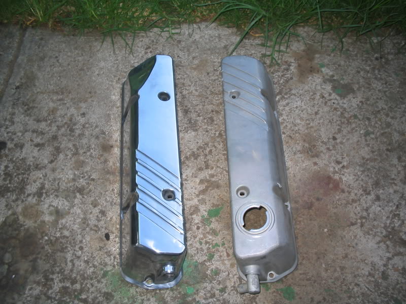

Posted 04 March 2008 - 10:03 AM

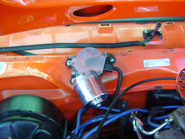

Jeremy's latest work on my car.
The wiper motor came up very well indeed and has yet to have a final hand polish the Purple.
Edited by Herne, 04 March 2008 - 10:04 AM.

That came up really well Herne, does Jeremy do polishing for a full time living?
#97 _Herne_
Posted 04 March 2008 - 01:49 PM
No Brewster, he sells cars as a living, polishing is one of his loves, Torana's are another.
He does do good work and enjoys doing it. :)

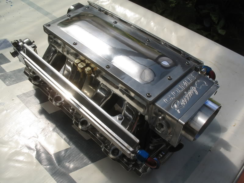

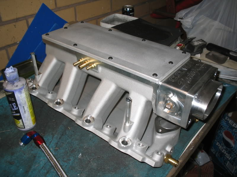

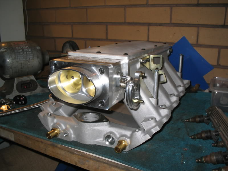

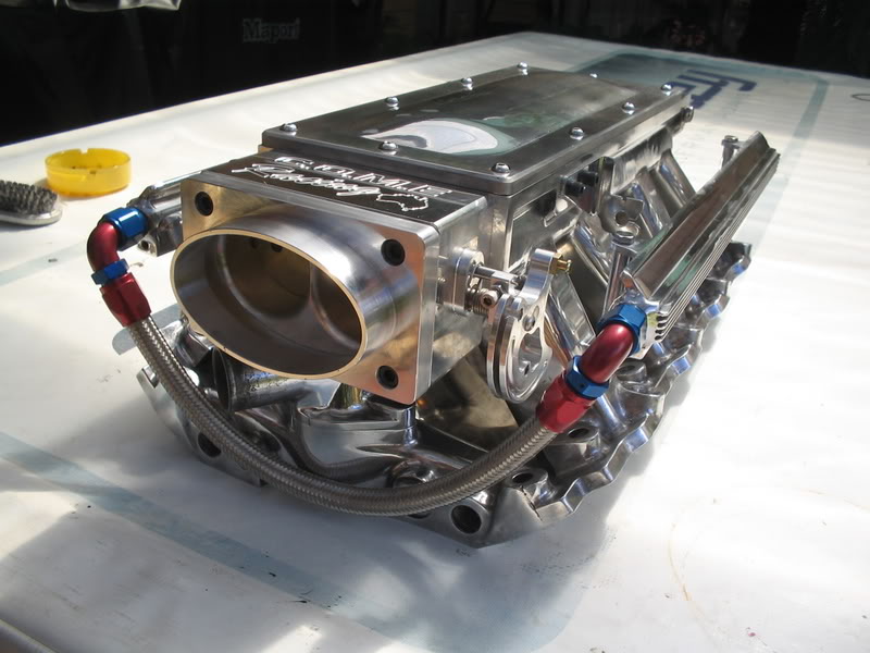

Posted 28 March 2008 - 01:00 PM
Hey all,
As promised, My latest addition is complete,
i purchased this manifold 5 weeks ago from COME Racing, and have just finished polishing it, im pretty pleased with the outcome, but theres always room for improvement
heres some pics
THEN:
NOW:
:spoton:
#100 _Herne_
Posted 28 March 2008 - 01:03 PM
Hi greenmachine, roughly how long does a job like that take you?
Nice work btw, love it.
