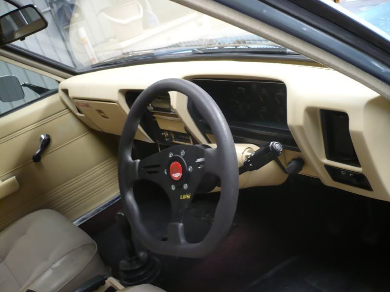

also got my interior all together now! just need some carpet and the seats redone anyhow heres how it looks:
Ben

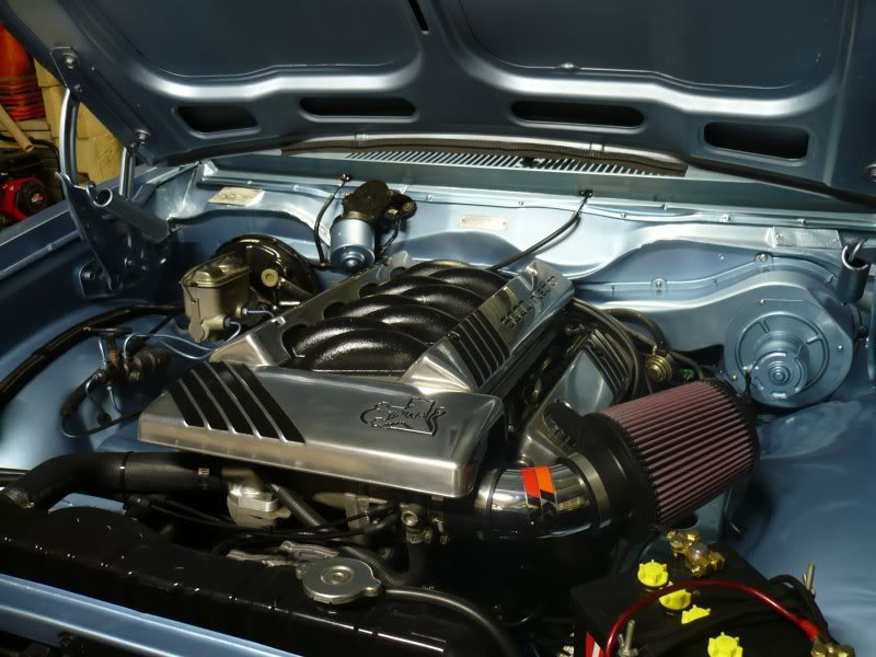

a little update! been driving the car around heaps its so so much fun to drive! had an extractor gasket leak so had to take them off and found that i had them on the wrong way around so it was only allowing like 2/3's of the air through lol anyhow its now fixed and the car sounds sweet. still sort of got a problem with a very noisy throttle body if i put my finger over one of the little inlet holes on the inside of the throttle body the noise goes away.. and every now and again (mainly when the noise is present) the engine warning light comes on got error code 23 which is something to do with the MAT sensor probably a dodge connection will look into it..

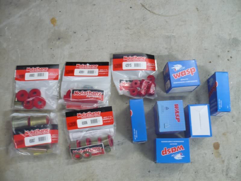

Ever since i put the 8 in my cars been wildly low (scraping on the front sway bar every bump) so thought it was time to get new springs rated for the v8 and while were at it replace all the bushes and ballpoints etc..
a few of the goodies..
the worst part of all this is the 30 years of grease and dirt build up which i want to clean up lol
another thing ive done is purchased a K&N pod filter and installed that the quality is so much better than the other one..
so now the engine bay is pretty much finnished just wanna get some CHASSIS RAIL PLUGS if anyone can help me out there then im done and dusted for a while :D
Ben
Mat sensor is Mannafold air temp sensor I think, Could just be caused by your pod sucking hot air from your extractors if the wiring and sensor check out ok.

Luv the UC im pretty sure thats what it is but havent had time to look at it yet... i can see the heat issue being a problem esspecially in the summer am looking at either moving the battery to the boot or pluming up some other setup see how i go..

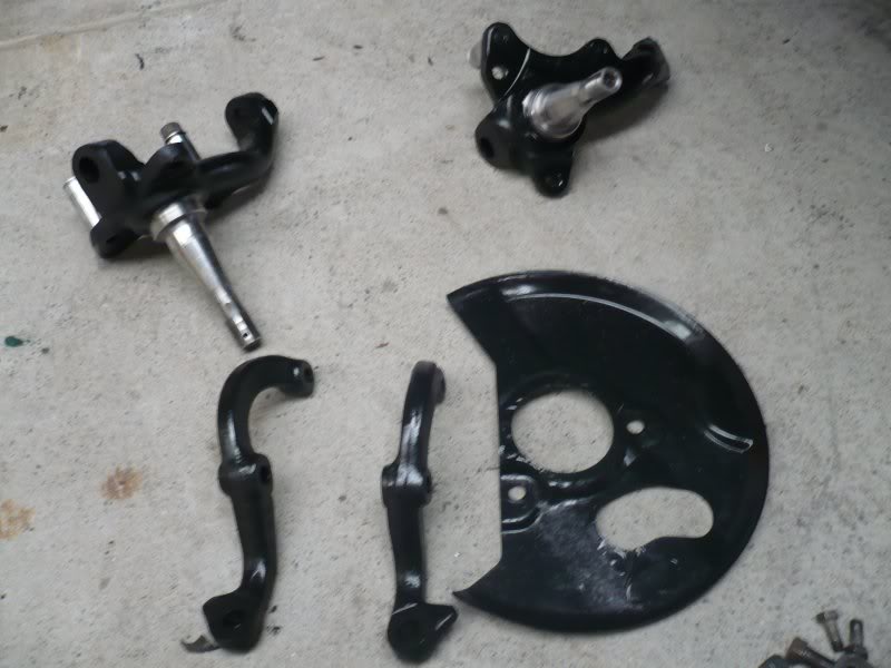

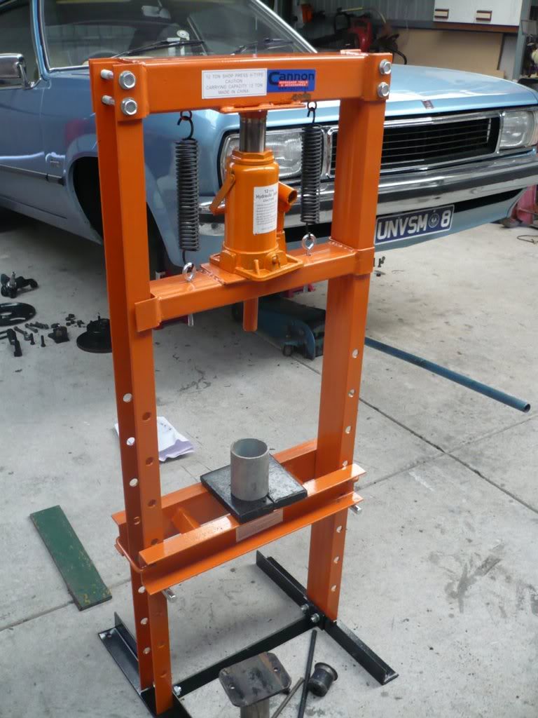

Update all the front end is finally ridden of the mounds of grease and grit and all painted and ready to be put back in with the new bushes.. Dad bought a new bench press today to make things alot easier

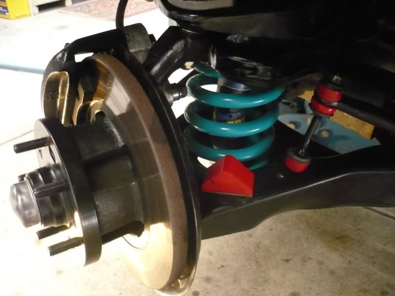

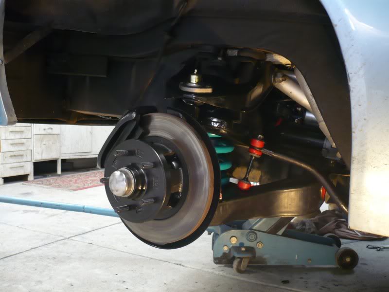

alright got the front end done we only really did the easy bits and will save the rest until the engine comes out next... but was good to get it all cleaned so much grease under there it isn't funny got new heavy duty springs which were meant to make the car higher but well its now even lower haha ah well no speed bumps for me :<_<:
and my new press made getting those bushes and ball joints out a piece of piss
will get some shots of how it sits soon :D

I want a press...
#268 MRLXSS
Posted 28 July 2008 - 08:27 AM
Nice! Im with Tim, I want a press too! it would make doing balljoints and stuff, SO EASY! HAHA!
#269 _UNVSM8_
_UNVSM8_
Posted 28 July 2008 - 12:12 PM
those presses are really cheap atm dad got it for $199 pretty good really even tho we will probably never use it again haha nah it will come in handy!

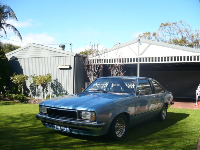

Posted 28 July 2008 - 05:31 PM
not the best photo shop but i love the 5 spokes and white walls some may not agree with them but i recon they look fat..
